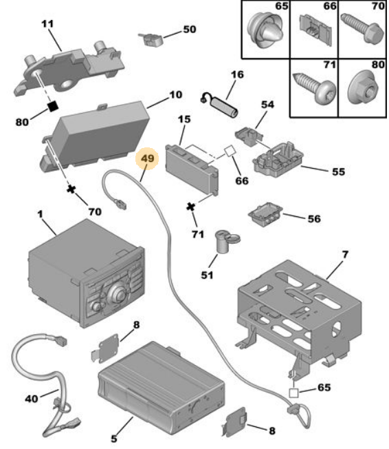

Last summer, the unit randomly stopped seeing the USB slot (it doesnt detect any pendrive). Tried wiggling the plug at the back, but nothing. It's not in the source menu either. Any idea? :/ That problem might complicate the fw update

If the USB is formatted correctly (FAT32), but is no longer able to read MP3 files or update the POI, then don't even attempt a replacement of the HDD or update the firmware at this stage until you've sorted it out.
I suspect that the cable may be damaged, or not inserted in the unit correctly.... You can always replace it with another cable. The part number is: 6574LA and is priced at (UK) wait for it.... £115.33
Item (49)
Item (49)

Yes sir, i will fix the cable first.GiveMeABreak wrote: 06 Feb 2020, 00:38 If the USB is formatted correctly (FAT32), but is no longer able to read MP3 files or update the POI, then don't even attempt a replacement of the HDD or update the firmware at this stage until you've sorted it out.
Strange thing is, i was listening from usb then stopped the car at a store and when i started the car back up, the usb source menu option was gone.GiveMeABreak wrote: 06 Feb 2020, 00:38 I suspect that the cable may be damaged, or not inserted in the unit correctly.... You can always replace it with another cable. The part number is: 6574LA and is priced at (UK) wait for it.... £115.33![]()
Im thinking its a software problem rather hardware. Tho i will definetly remove the usb cable and check for continuity with a voltmeter.
