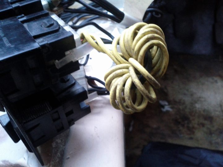

THIS is how TVR did their fan controller......in a plastic car..LOL

Is that spaghetti a resistance ???
Isn't/wasn't there a similar problem last year with Opels/Vauxhalls catching fire because of shoddy fan resistors?

Bloody 'ell Trevor m'lad, what a botch job! And they say French and Italian electrics aren't the best...
And yes, there was a spate of Zafira B's going up in smoke although GM seemed to suggest it was a result of cheap replacement controllers rather than duff originals... Methinks it's more than likely cheap connectors/faulty crimping on the terminals causing the lot to arc/overheat (perhaps causing a lot of controllers to be replaced as a result of dodgy fan operation, thus giving Vaux the "get out" that it was dodgy aftermarket kit causing the issue.)
