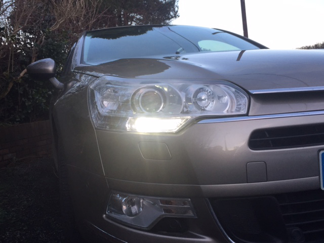

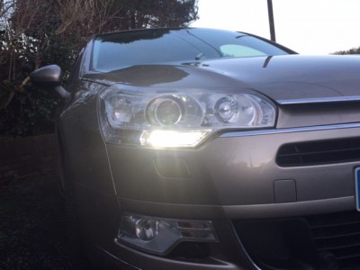

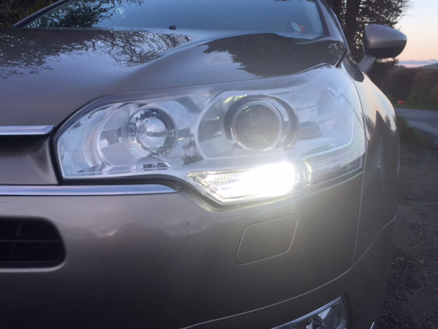

Re: Daytime running lights
Here's a few shots of the new DRL LEDs against the previous ones. The camera doesn't really show these well, but the newer ones are definitely brighter in the daylight, so am really pleased with them.
Original LEDs New LEDs
Yes, a quarter turn I think. Sorry but until Friday I can't check because I'm not at home. DRL's looks good

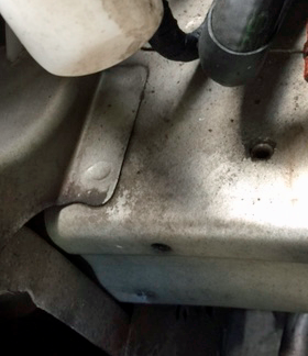

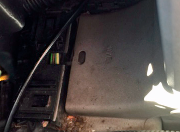

Hi, here are new pics. Is a quarter turn clockwise for the passenger side .... driver side for your car.
Thanks for taking the time to post these pictures - mine still won't come off - it seems they are stuck on with glue! That would be counter-clockwise looking from behind the headlamp and clockwise looking at the front - as in the second picture. I can only get 2 fingers into the recess, so may have to use pliers as they won't budge! - I can't believe these things are on so tight.
