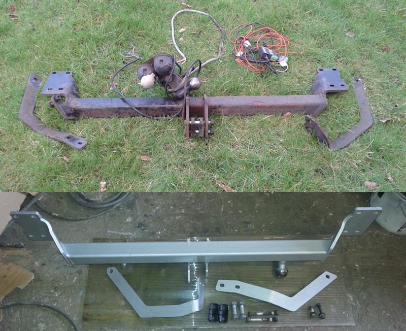

from this to that....One Original Witter Tow Bar ready to fit now....and I have the ramps.
Wired, dry heated and phosphated, wet coat zinc primer and two layers chassis black with a silver enamel over that. Dry heated over night to cure.
FYI...IF you have a Witter Tow Bar fitted....the Powder Coating is CRAP and your rear crash bar mounts are possibly rusting.
Based on what I had, Witter should be ashamed to release a product with such poor coatings.........dreadful condition
- Posts: 14308
- x 3306
Re: shortly to become an Activa owner...Project Stictiva
Nice job of getting them right.

I will use Waxoil on all bolts/surfaces (with new bolts) when I bolt it back up, then 3M Body Schutz over the lot.
This was a good test for the phosphate I have, a rather higher concentration than CureRust and such. Also, it does not have that horrid varnish in it.
You have to wash the towbar and dry heat it quick, keep it hot (on top of the woodburner in the garage), mask up and apply. Keep it hot and allow to dry then wet coat with a zinc primer. Allow it to dry as the metal cools then apply the chassis black 1st coat and allow to dry and the metal to cool off, Thin wet coat 2nd black layer, allow to flash then top coated with enamel thinned a little with cellulose thinners.
Working with cast Iron I am anal about corrosion as you can tell

- Posts: 14308
- x 3306
No, you are cautious due to experience.

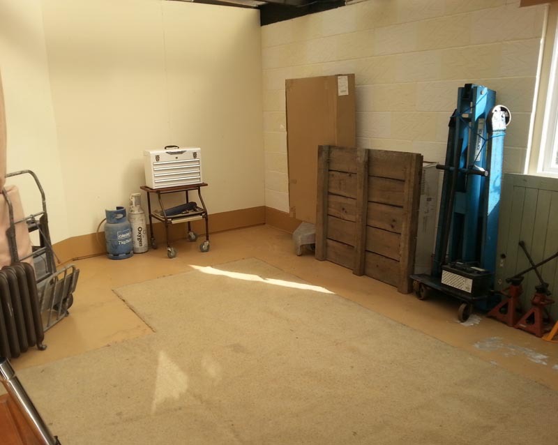

Strip down bay now clear and ready for the two donator cars tomorrow........and the ramps fit with 3 foot to spare, electric roller shutter.
area is twice as big as the photo (add to the left) with an office thru a door, the dirty workshop is 4 times that, so I should have the space
Must remember not to set things on fire when welding with a Tri-Wall plastic roof

Lovely job on that towbar, very smart!
Can I recommend you to Dinitrol instead of Waxoyl though - far superior products in my experience. I used to swear by Waxoyl but honestly it is crap in comparison and I won't be going back!

Thanks.....having the dirty area and a spray booth all set up helps a lot in keeping things clean then a good finish is hard not to achieve....clean and you get into heaven as my old Nana Moria used to say
I will be using the WackyOil just for sealing the mating surfaces and bolts ect so I expect it to hold up there....I have 3 Ltrs to use up. The paint should hold up well now but I will put a layer of under-seal over it when mounded just to add a more shock absorbent surface.
I will use it in non critical areas and build-ups only as you are not the first to make a recommendation for Dinatrol. I intend to go right thru the car with it ? how does it apply in box sections ?
I also like 3M Car Body Schutz if there is the correct layers of protection underneath it.....its a pig to spot a bodge thru so I only trust the factories and any of my work under it |:)
