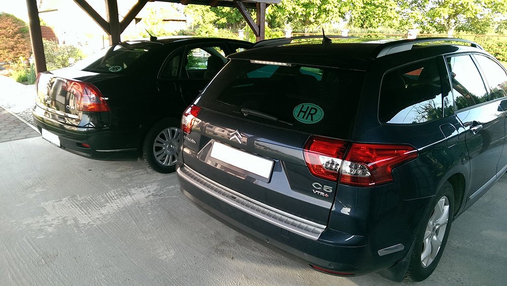

I've started replacing my rear lights, since the redesign ones look far better IMO ... first phase, the outer ones, price per unit approx. 115 GBP (new, dealer) ... the first phase looks like this:

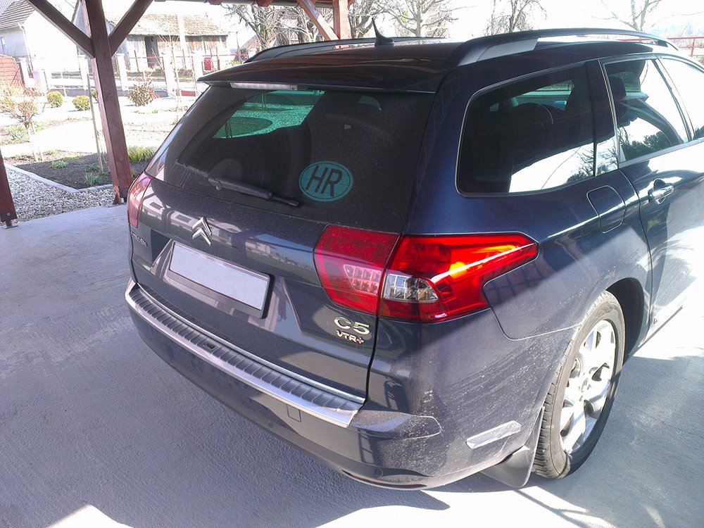

I've completed the rear white lights today, the current situation is like this:
