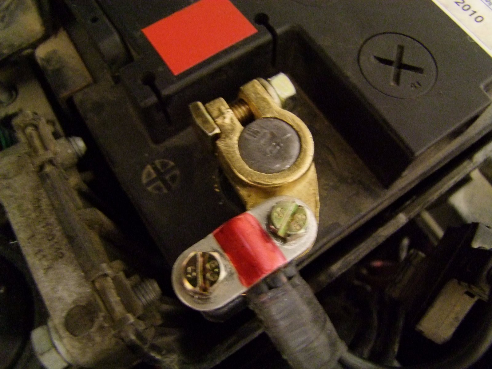

Was checking the battery recently and discovered the positive battery cable clamp is fractured right through top to bottom! It is therefore loose on the terminal. Amazing that it still allows the starter to work! Rather than replaced the cable, which I imagine wouldn't be fun, I'm going to cut the damaged clamp off ind fit a repair clamp.

We had a similar issue with our ZX 1.9TD, the cable was actually still OK in that case but the P/O had overtightened the positive terminal clamp until it fractured so had to replace that. Interesting to read about the earth cables on 206's a couple of pages back, while there's no weird electrical issues our '02 1.4HDi does occasionally seem to crank a bit slow/take longer to start so will be checking the battery cables/clamps on that too. (I've heard these engines don't require, or even bother to use, their glowplugs until the ambient is well below freezing so I don't think it's plug related???)
Also my old 205 Junior 1.8D had a bad main earth, occasionally when hot, and you could see where the starter's current tried to re-route when it failed as the small wire to the fuel filter head/primer pump used to "twitch" and get hot when you turned the key! (scary!!!). In that instance a quick hammer blow to the bolt head on the gearbox used to sort things until I got round to remaking the connection.

ekjdm14 wrote: 13 Jul 2016, 11:09 We had a similar issue with our ZX 1.9TD, the cable was actually still OK in that case but the P/O had overtightened the positive terminal clamp until it fractured so had to replace that.
Can I ask where you managed to get a good one from? Pretty sure they are no longer available from Citroen or otherwise exhorbitant.

This sort of brass clamp (motor factors, Half**ds, etc.) does a good job
and avoids the need for additional ring connectors.

Chris, that's the best one I've seen in a long time
Better than the original in my opinion...

OK Chris. Thanks for that. I'd love to source a genuine one as Sylv's is still totally original.
Have to keep my eye on the bay!
Might try soldering the clamp if only to fill the gap.

Since fitting those, and adding a second cable* between glow-plug relay and glow-plug 'rail', the 2.5TD now starts on a mere tweak of the key.
* Originally, our 1996 XM was fitted with a stout 4mm2 multistrand cable arriving the the GP relay main contacts (from Batt+), but only a single 2.5mm2 leaving it, and heading off to the GPs. What?? Earlier wiring diagrams show the diesel XM with twin (paralleled) cables on the output side. Bean counters at work?
On the basis that current capability out should equal current capability in, I ran a second black cable 2.5mm2 neatly alongside the solo one, with a soldered eye-terminal at each end.
Happy result was that total glow-plug current draw went up from 50A to 75A on my clamp-on d.c. ammeter, and starting has never been better.
Note sure whether Xantia might have been wired in the same way. Easy to tell if you look at the cable sizes on the H.D. terminals on the underside of the GP relay. Worth cleaning up those external contacts too.

An interesting post. I have just checked my new Xantia. Yep terminal on battery heats up enough to smoke when using starter. Just ordered a new one. Thanks.
