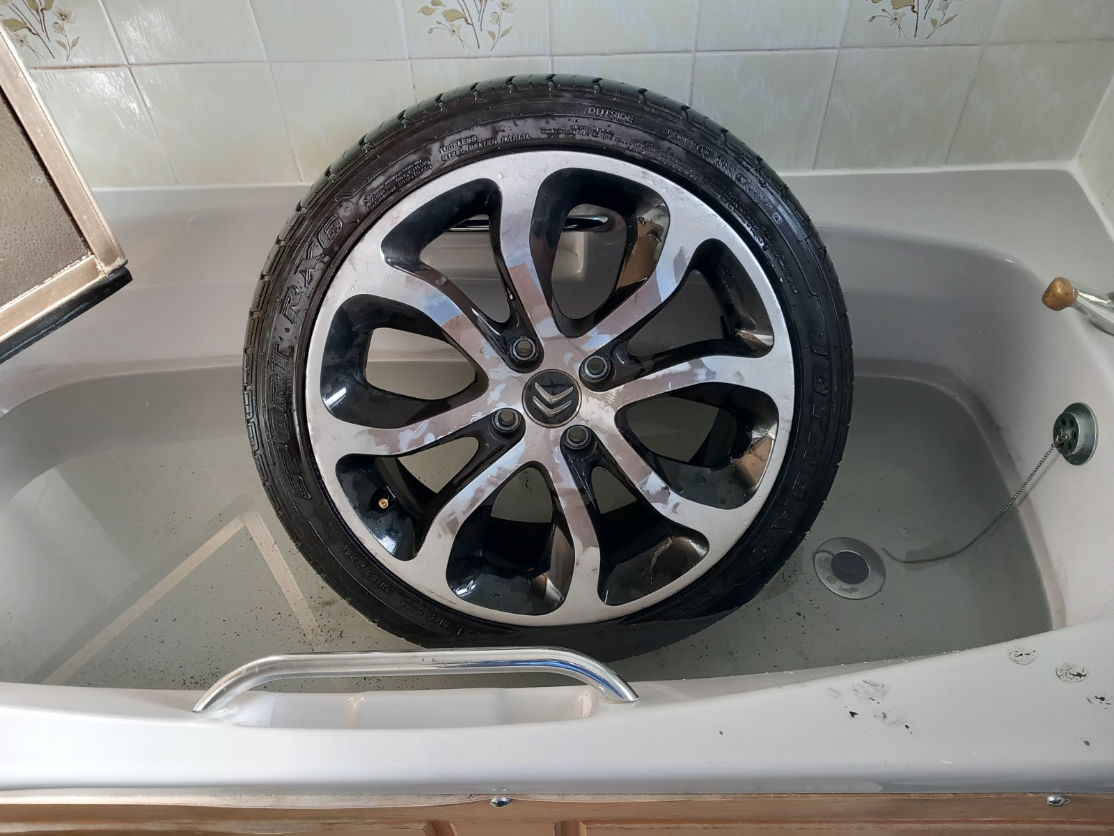

Bollocks :evil: Polly has definitely picked up a slow puncture :( She lost 0.2 of a bar overnight.
I'll check the tyre more thoroughly this morning and hoping it's repairable... Knowing my luck :twisted:

mickthemaverick wrote: 30 Oct 2023, 07:21 Sounds like a whip it and dip it job to me!! :o :)
Did that, not a single bubble to be seen... The only item big enough to do it in was my bath... And it got a bit mucky :twisted: :lol:
And nor could I find any penetrating object either... Two of us looked with no result...
Most odd. I'm taking the wheel to our local place in a bit to let them have a look at it and possibly reseal the rim bead and swap the valve although again, no bubbles seen despite deep scrutiny...
If all else fails, it'll be a new pair of tyres... I already know I'll soon be needing new front brake pads...

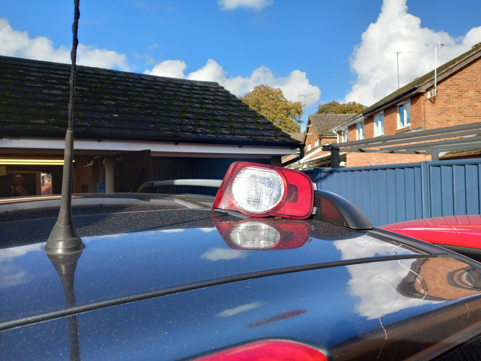

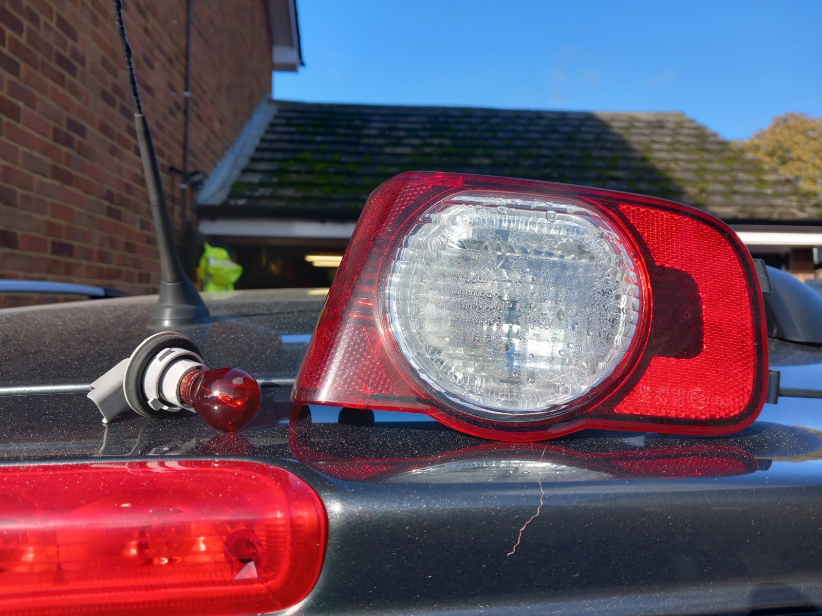

One thing I did notice today was condensation in the rear fog lamp...
As it's been gorgeously warm and sunny here I rested it on Polly's roof to air out...
I was mildly surprised to see it has a red coloured bulb. First I've seen. I knew of amber bulbs for indicators but not red...
Now nicely aired out :)

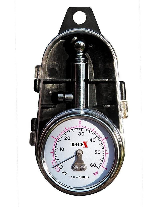

I did find, in all of this fun, the gauge on my track pump does not quite agree with my Sykes-Pickavant gauge... I now need a third known-good gauge to see which is the most accurate...
Posts: 6846
x 3566
Re: Citrojim's AX, Pixo, C3, Running and Cycling Tales
Race X gauges are known to be relatively accurate for the price..... or accurate enough at least :)
https://www.ebay.co.uk/itm/363972799563
Race X gauge
Race X gauge
