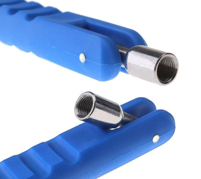

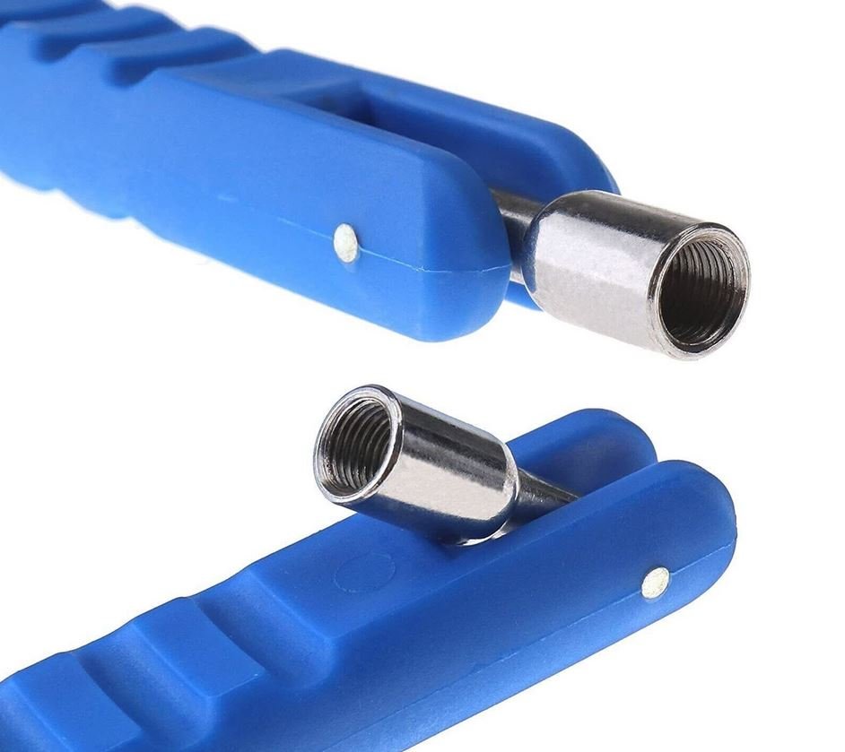

The main benefits with this type is that they are non-damaging....... and they make the job easier
Go for all metal variants or ones that look like they might be made to last more than 5 minutes (i.e. not the ones in the picture
) as you can sometimes need a bit of force.

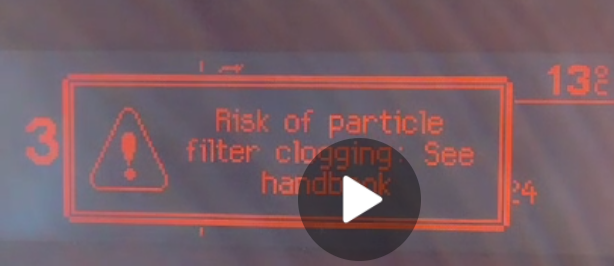

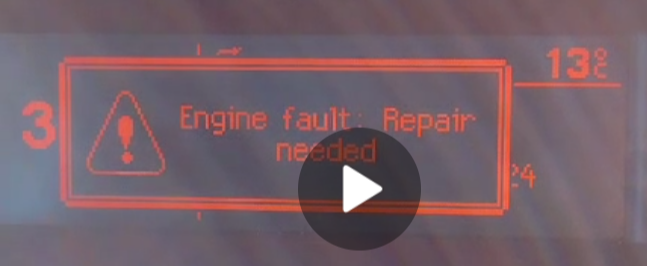

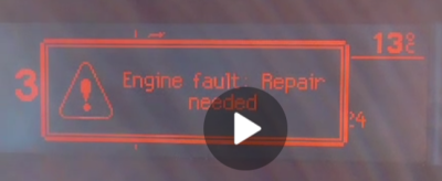

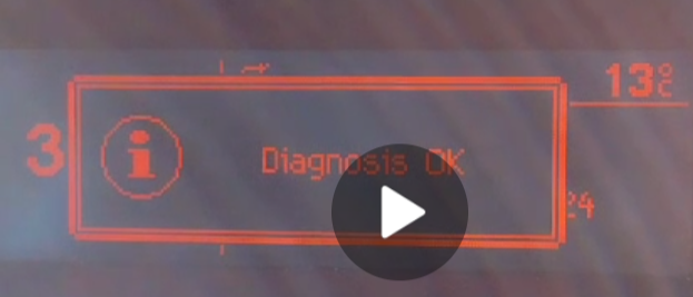

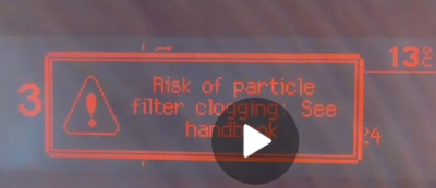

308 update:
(Sorry about the play icon, a video was easiest way of capturing all the messages)
Not plugged in the DiagBox machine yet. Maybe tonight, (enthusiasm/energy dependent! Abysmal commute home tonight! Knackered!) Or else tomorrow dinner time as working from home tomorrow.
Tyre paste, drill bearing arrived yesterday. Think the valve stem tools and next valves have arrived today.
- Posts: 55100
- x 8400
Hope nothing too drastic with the 308 Matt... Watching with interest to see the root cause of this problem...

Oh dear, more sparks needed Matt!
