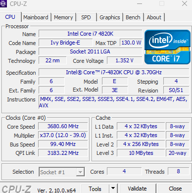

If thinking of upgrading an old PC, download, install and run a program called CPU-Z which will read and decode the specification of your CPU. If the CPU does not support instruction sets SSE4.2 (Intel) or SSE4A (AMD), then it is a non-starter for long term use of Windows 11.
My old PC from 2013 does support SSE4.2 so should be OK for a test.

Yes, that's correct, my old 2013 Alienware Aurora I7 supports all the chip requirements - so as long as it meets the above, you can dispense with the secure boot and TPM requirements.

Thanks for the tip on using "cpu-z" unfortunately, based on the screenshot Marc kindly provided, I see it the sort of program I could download and then have an output as per above = I get the bit about "Cores = 4" but everything else detailed there? It's all greek to me!

Just look in the section marked "Instructions". I believe this is short for Instruction Set, which are the commands used by the CPU.MattBLancs wrote: 14 Dec 2024, 21:34 Thanks for the tip on using "cpu-z" unfortunately, based on the screenshot Marc kindly provided, I see it the sort of program I could download and then have an output as per above = I get the bit about "Cores = 4" but everything else detailed there? It's all greek to me!![]()

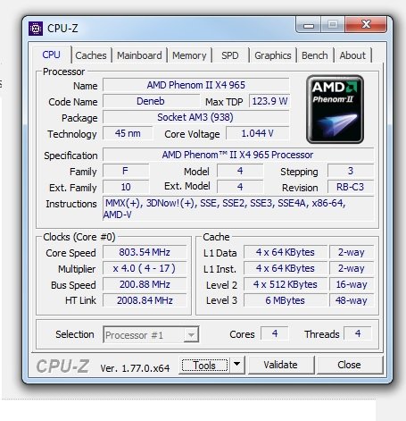

Blimey my old beasty from 2009 seems to be OK
As you can see from the version number bottom left, I've had CPU-Z for quite a while.

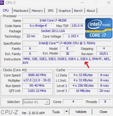

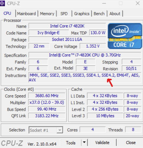

Matt, Your processor needs to support the 'SSE 4.2' instruction set for Windows 11, see where this is shown on the first page of the app below:
If you don't have this specific instruction set, then you can't install Windows 11 - this is an essential prerequisite. You may still have other issues bypassing the other requirements even if your CPU supports this instruction set, especially if Windows is saying your PC is not Windows 11 ready.

Spot on, thanks Marc
