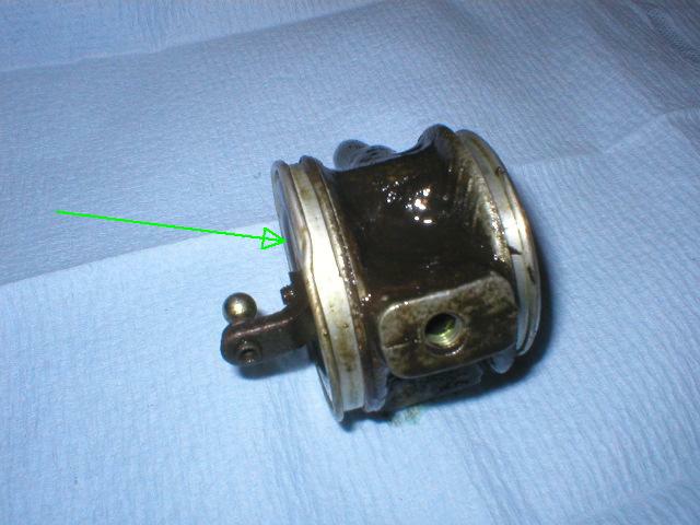

I removed the leaking roll corrector. Another of those jobs that look almost impossible but actually turns out to be easy :D
It was leaking because the outer casting was damaged. See the big ding in the periphery in the picture below:
This damage was at the top of the body so it must have happened by something, the exhaust maybe, dropping hard on to it. It only started leaking when I disturbed it. The seized mechanism must have previously held it in a non-leaking spot...
I partially dismantled it. Given the sparkly bright LHM in the system, I was surprised to see all this muck in the end of it :shock: This was behind the seal and not behind the dust cap.
Luckily, I have a spare roll corrector although it looks like a standard height corrector could form the basis of one if the dampers are removed.
