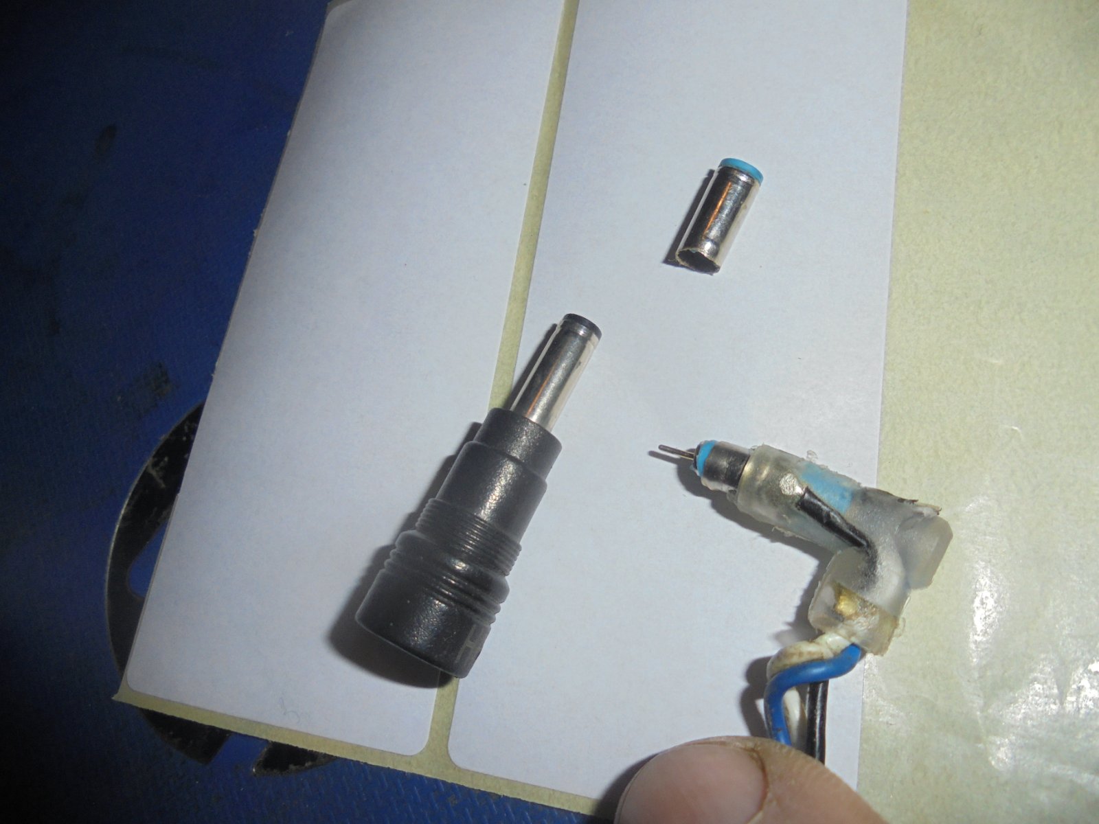

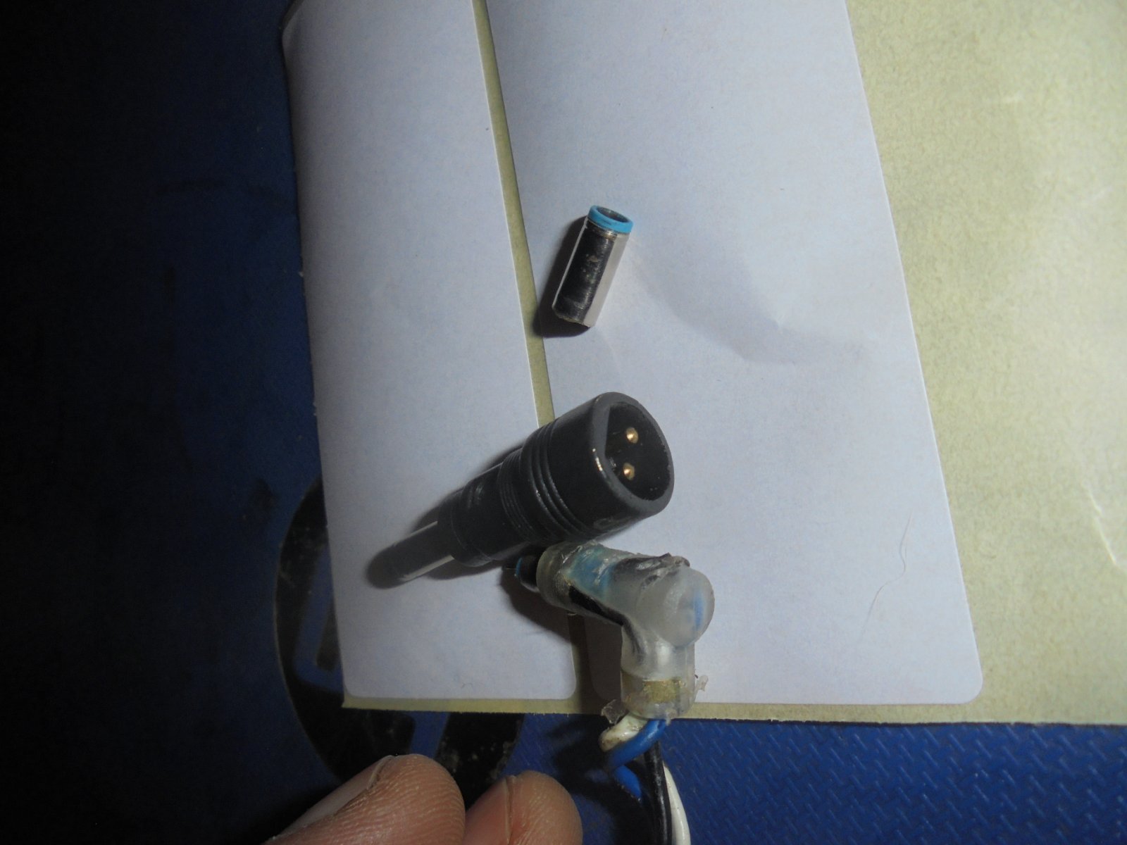

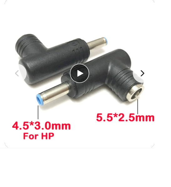

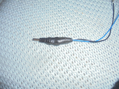

So here is the Laptop charger saga for an HP laptop. In pictures with a few brief words. Thought I had solved it by wiring up that connector, but the colours of the wires were not in any sort of indicative colour. I probably falsely assumed the Black to be negative...you can see it is soldered to the outer metal, Blue to be positive supplying power the the centre pin and the White...dont know..data, maybe not needed as the HP laptop has been without a battery for about 3 years.
Should have proved it first but the bare wires coming out of the charger show, plugged in at source, not plugged into laptop.
19.5 Volts between White and black,
13.1 Volts between Black and Blue
0.00 Volts between Blue and White
Not sure what that tells me :!:

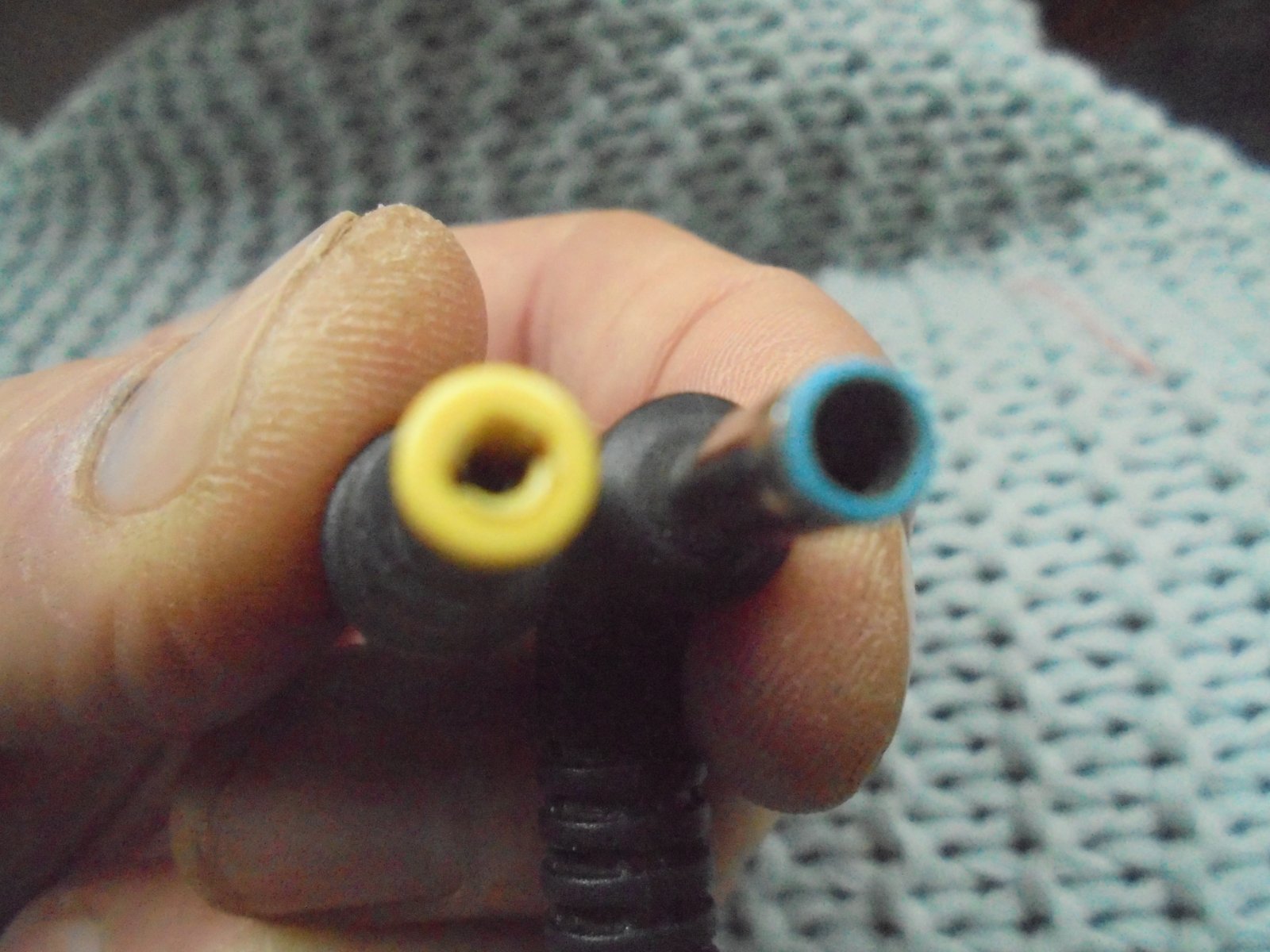

picture shows broken power pin and the wires Blue, Black and White and a correct size connector, not HP, not HP charger specific.
3 Wires into 2 pins doesn't go but which colours do what,
One is Power supply, one is return and the other data?

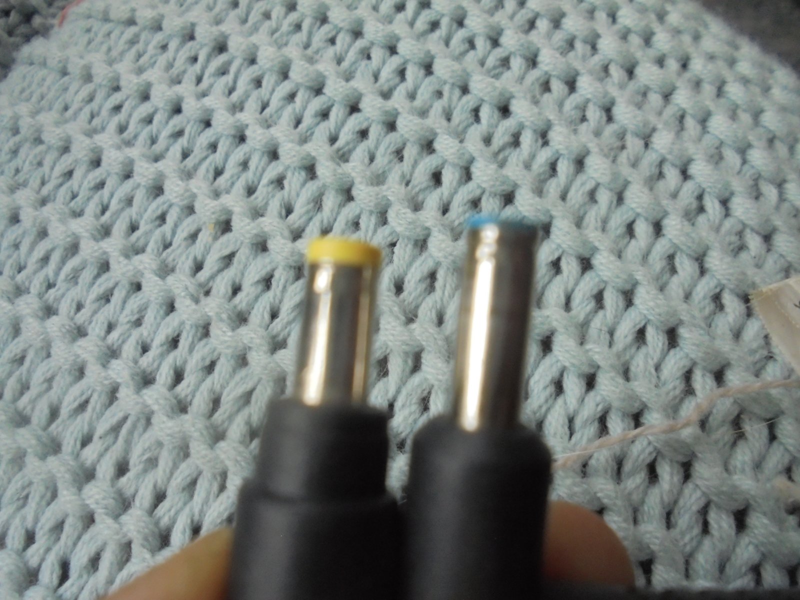

Mick's kind replacement, not quite a match, the critical failure being the internal diameter which for the HP is 3.0mm

Thanks Mick I wired the plug up incorrectly at first but yes the black and the white produce the required 19.5v
Just don't associate Black with what I imagine is the positive pin (it is!) :-D
Black currently goes to outer metal shield, blue to centre pin, but I can attach the wires to any colour rather than resolder the plug bit again

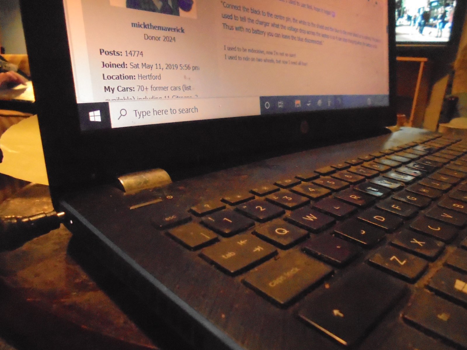

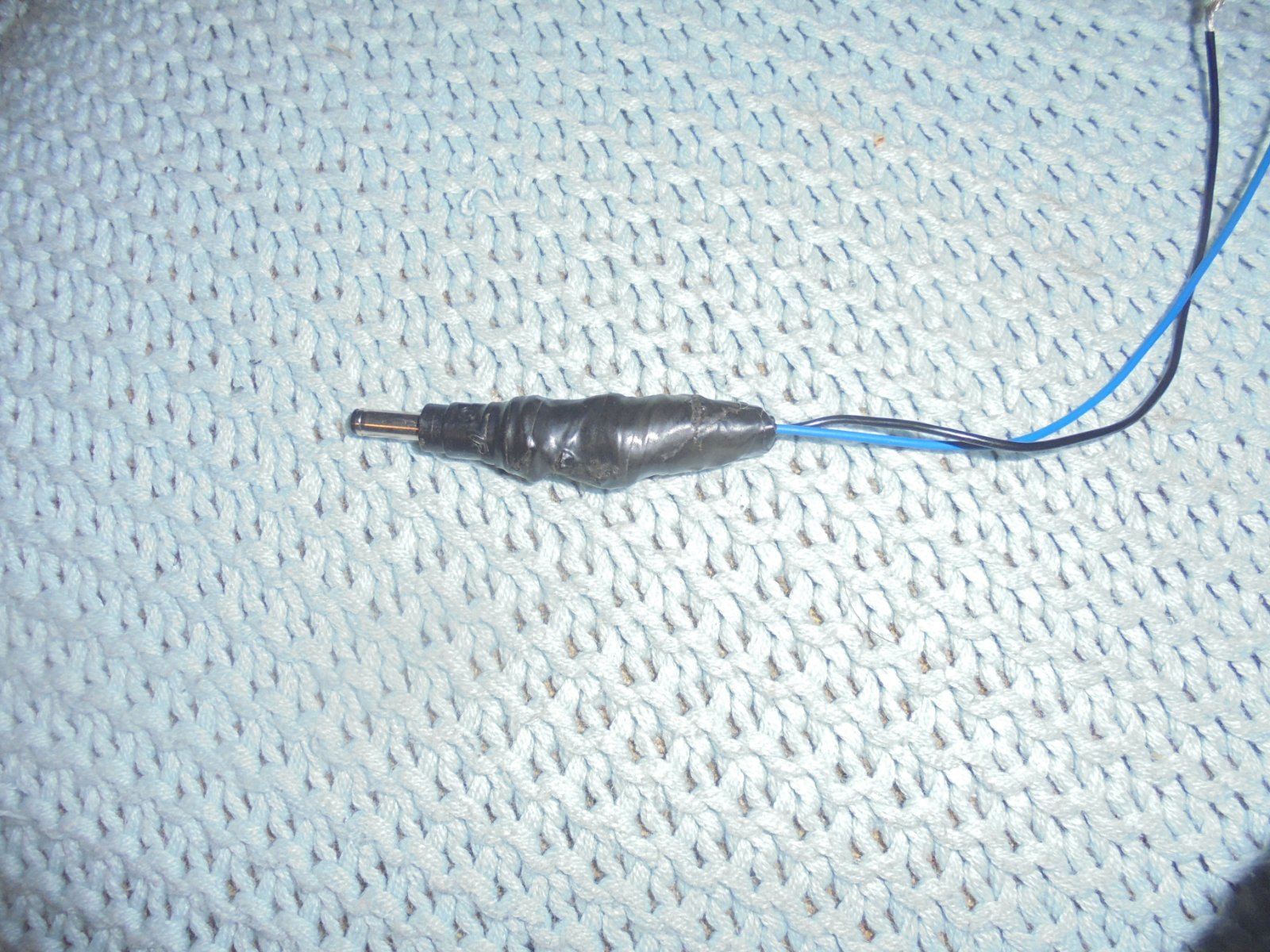

A slight change as a result of trial and error and the new pin is powering the HP laptop as I type.
Black undoubtedly linked to the outer metal and presumably negative/ground, White to center pin. Blue redundant.
need to tidy it up, but working.
