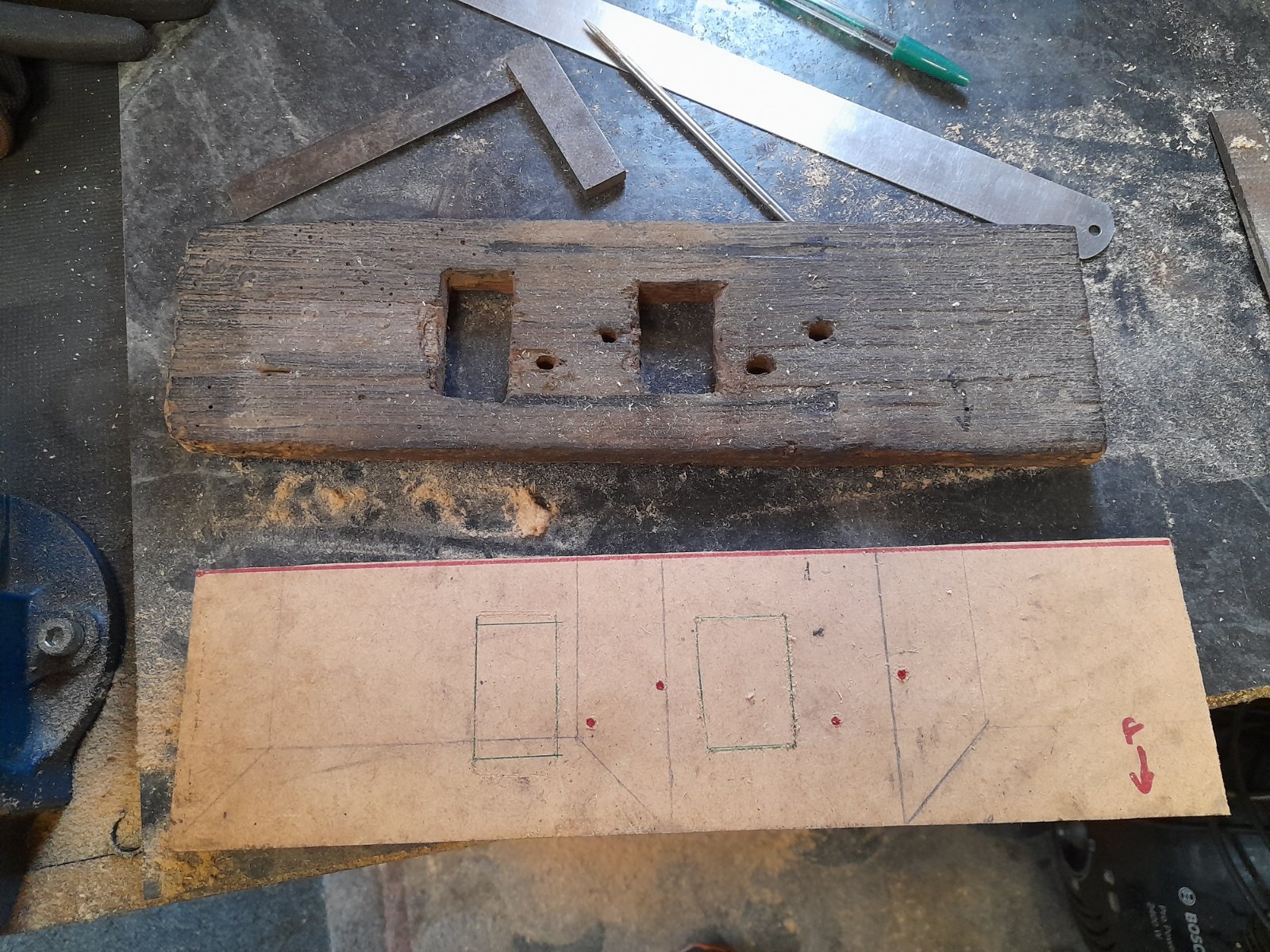

That base board looks very rough, Jim - original, or a later addition do you think? Is the thickness critical? And what about the slot in the surface on the RH side - required or just some historical quirk? Really you'd need a nice piece of hardwood already well seasoned then cut down to size (needs to be well dried out, or it too will warp!). If it didn't need to be too pretty I could probably make something. I've got a nice piece of Elm here, but I'd need to think of a way to reduce the thickness as it's about 2" thick!! Actually I think my mate's got a thicknesser...
- Posts: 55066
- x 8390
Re: Citrojim's AX, Saxo, Pixo, Running and Cycling Tales
I think it's likely to be original Richard... It's a typical Grandfather of the period using a standard bought-in movement - from Birmingham in this case - with the case having been put together locally, usually by a local cabinet maker. This one was built in my home town. According to dad the job of making clocks was a side-job when other work was scarce. Another side-job was coffins! Dad was apprenticed in a cabinet makers...RichardW wrote: 08 Jan 2023, 20:57 That base board looks very rough, Jim - original, or a later addition do you think? Is the thickness critical? And what about the slot in the surface on the RH side - required or just some historical quirk? Really you'd need a nice piece of hardwood already well seasoned then cut down to size (needs to be well dried out, or it too will warp!). If it didn't need to be too pretty I could probably make something. I've got a nice piece of Elm here, but I'd need to think of a way to reduce the thickness as it's about 2" thick!! Actually I think my mate's got a thicknesser...
So on that basis, any wood lying about might have been used for the baseboard and other non critical parts... You can see the variety of scrap wood used by looking in hidden places... These clocks are a bit like Arthur Daly cars - good on the surface...
But yes Richard, the wood requirements for the new baseboard you have absolutely spot on
With my automotive hat on, I'm wondering if a nice piece of ash might be good? It's good for car bodies and Moggy Minor Travellers...
The slots and holes are all functional. The two big slots allow the weight lines to play out across the width of the drums/spools as the clock winds down, two holes are for the movement mounting bolts and the other two as line anchors. The old board can be used as a template to make a new one...
It definitely needs renewing but I must keep the old one as part of the history of the clock.

Stuff that is out of sight isn't given much finishing some times.
Off the wall suggestion / offer of help:
I have Aldi's finest router and some spare pieces of 28mm solid beech worktop. This is the usual "stuck together blocks" but machines nicely and is strong.
If you can give us some dimensions then I would be happy to have a go if you want?
- Posts: 55066
- x 8390
That would be awesome Matt, thank youMattBLancs wrote: 09 Jan 2023, 06:32 Stuff that is out of sight isn't given much finishing some times.
I'll do an accurate drawing of the old one later today...

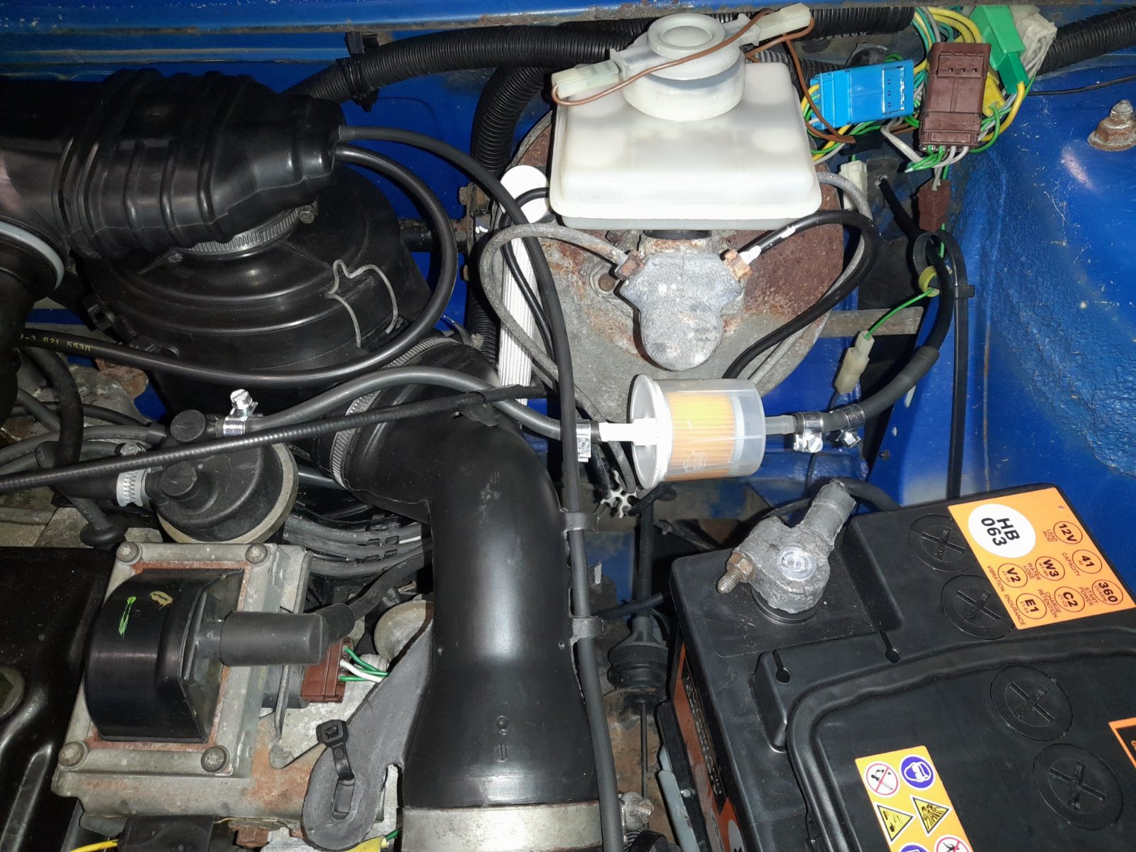

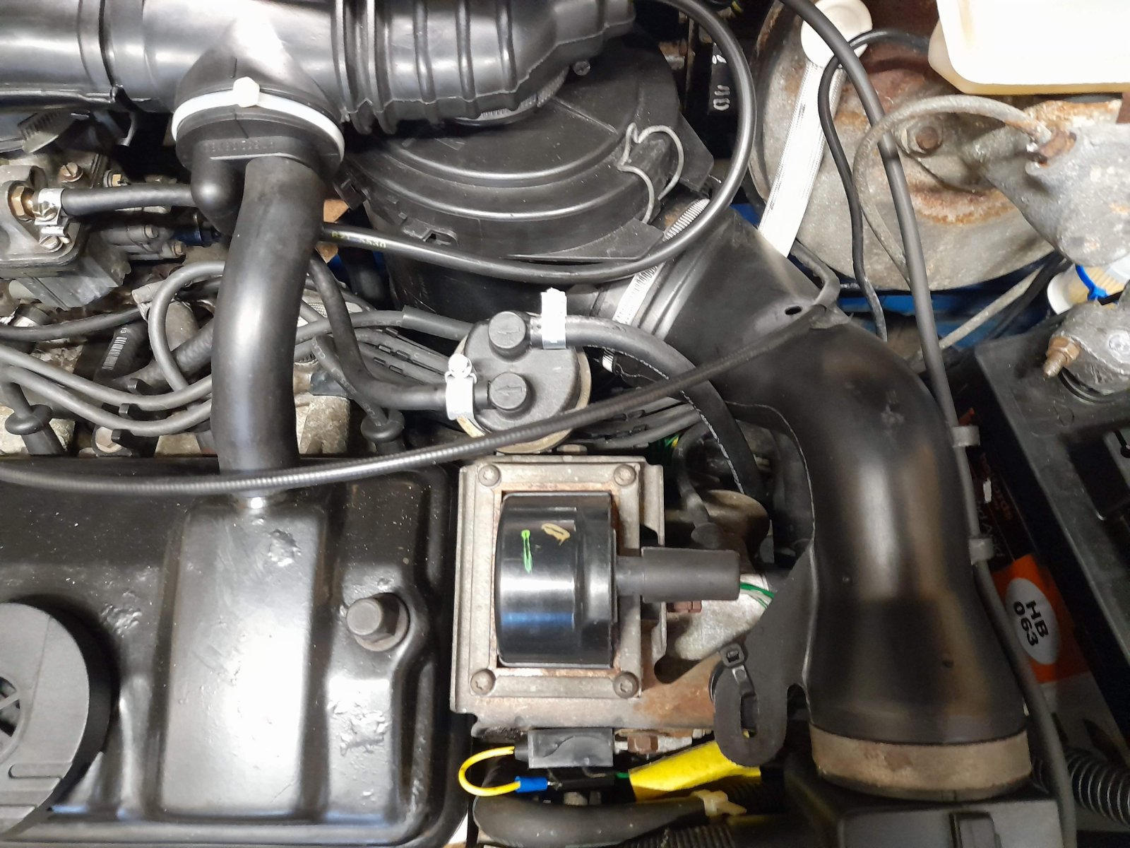

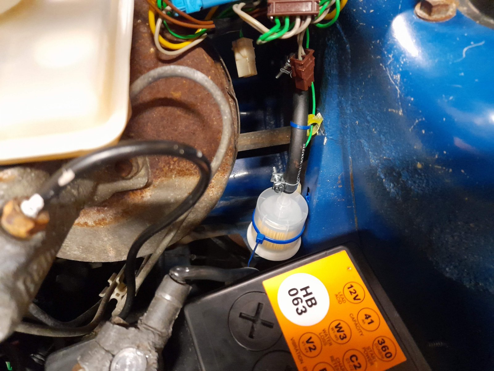

After that I did a bit on Bluebell... I'd never been happy with the fuel filter position and the quality of the fuel lines to and from it... The fuel filter, having the wrong tilt on it was not ideal.
So today, armed with the correct specification of pipe, stuff properly rated for unleaded petrol and bearing the correct markings, I made it a little better and put the filter in both a better place and correctly orientated and with as near to the correct routing to the fuel pump as possible.
I'm still not happy. I discovered these fuel filters soon get hard and brittle in the presence of petrol. I'll be procuring a proper metal bodied filter with a glass sight bowl on it and then I'll be happy the job is done properly...
I've not found one I'm content with yet. If anyone has an recommendations for one with 5mm inlet and outlet spigots then please do

I found a bit of MDF in my workshop which is ideal for making a new baseboard for the clock movement...
I donned facemask, pulled up my big-boy pants and set to work. I have no woodworking tools so I'm making do with metalworking tools...
The state of play at lunchtime:
A bit rough and not in keeping withy the rest of the clock but then again, the old board was made very roughly... What dad used to call an example of 'hedge carpentry'...
At least a thick piece of MDF is strong, won't warp and will be unattractive to the woodworm...
I'll sign and date the finished article for the benefit of those that will inherit the clock

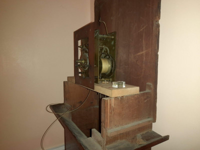

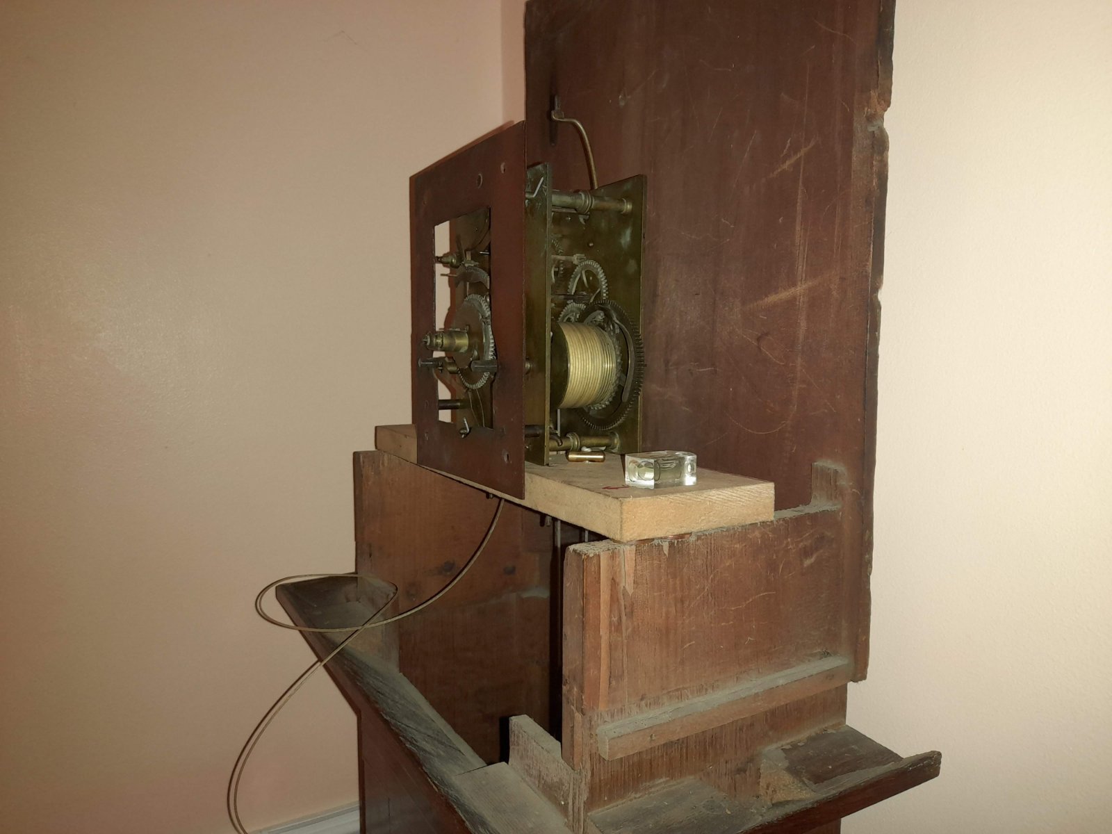

The new baseboard under test
Just the going train for now...
So far, so good... The little translucent thing sitting on the baseboard nearest the camera is a baby spirit level. The movement must be levelled in both planes and the pendulum must hang plumb for reliable operation...
I'll give it a day to settle and then reassemble the striking train to test that before final reassembly...
