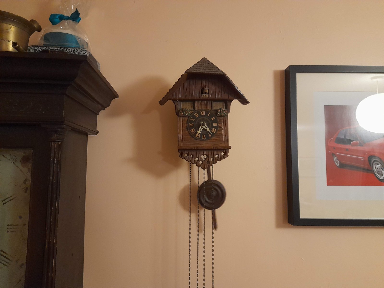

My cuckoo clock is now all complete, back in its rightful place and happy :-D

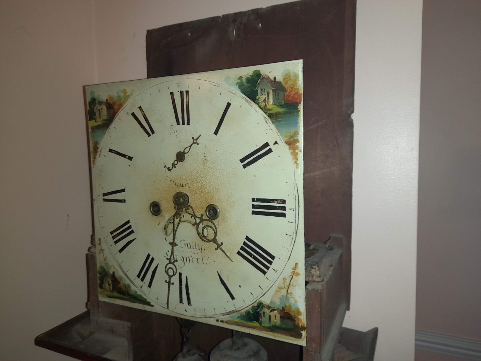

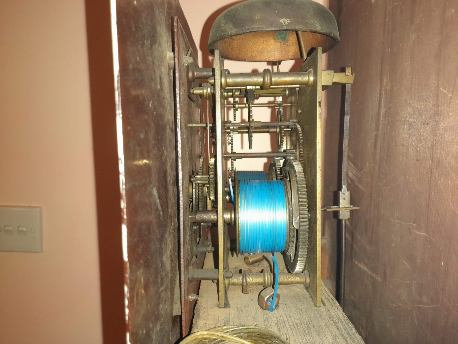

More clock problems... Yesterday, after it's normal weekly wind, one of my grandfathers stopped after about 10 minutes and then would only run for a few minutes before stopping...
This one has always been a bit temperamental and has not been looked at in a good 50 years apart from being restrung with garish blue strimmer line about 18 years ago and a repair made to one of the line pulleys... Both done by me. Dad recommended strimmer line rather than try to source catgut...

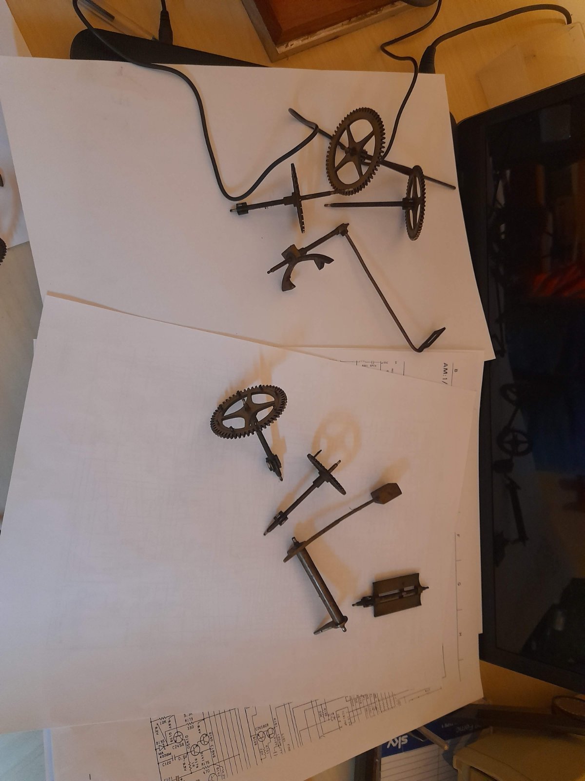

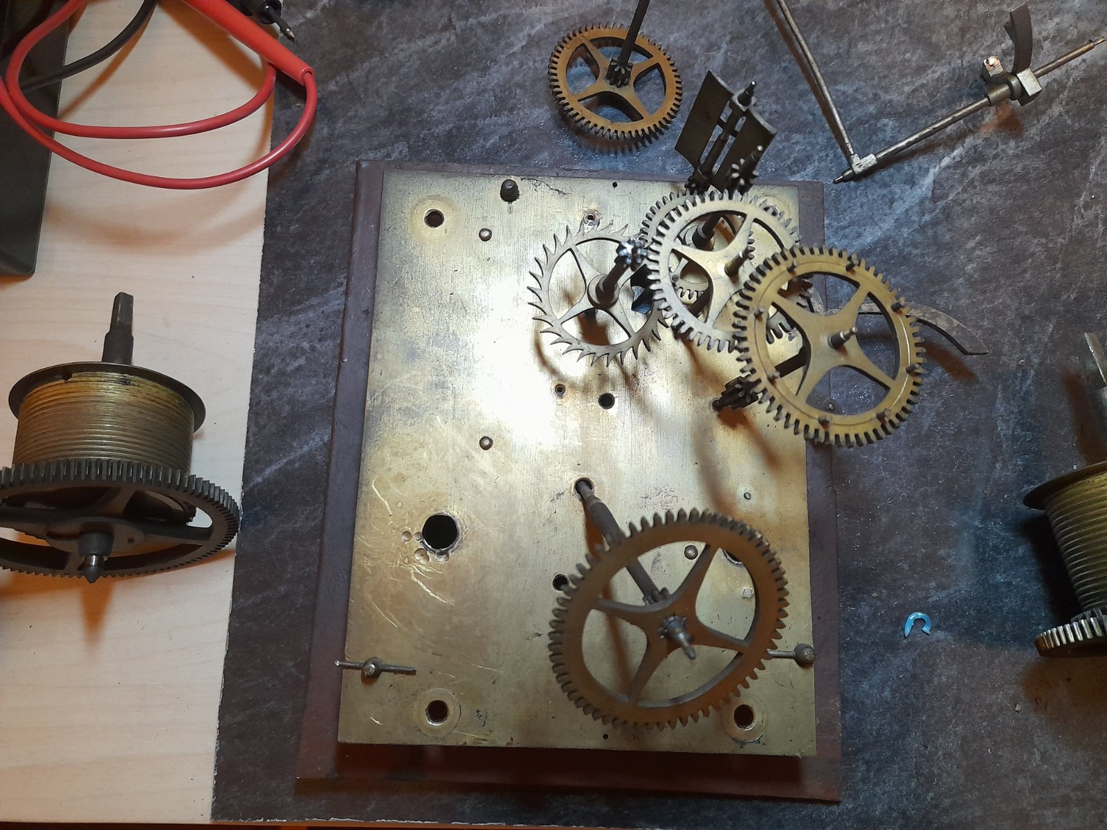

Today, it being wet and horrible outside, I've made a start on a full overhaul. The mechanism is a bit worn after well over 200 years - possibly more - of faithful service but the big problem is dirt and gummy old oil...
I've been very brave and fully stripped the mechanism so I can give every part a thorough clean before reassembly and sparingly lubricate it with the correct oil.
There's a lot of bits but I've taken photos and laid them out logically to ease reassembly...
A while back I sourced some new catgut for when I restring it. It's not real catgut but a modern synthetic version. At least it looks like proper catgut and is not bright blue!

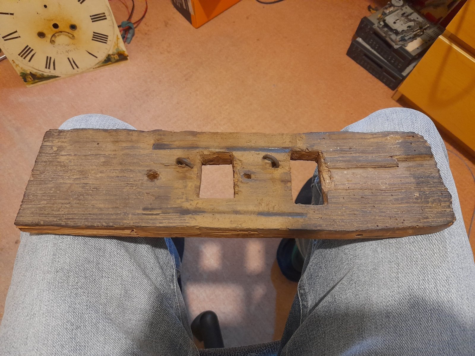

I did think about making a new baseboard...
But no, the old one is part of the history and fabric of the clock, it's still able to do its job and although it's a bit historically worm-eaten, it will stay...
