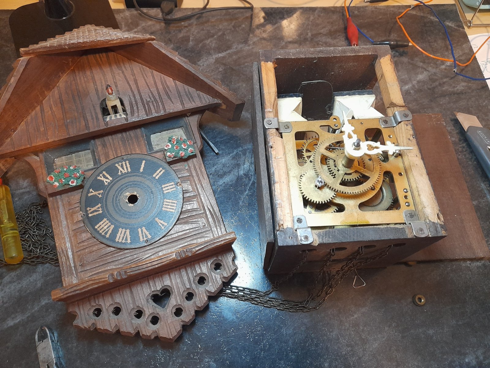

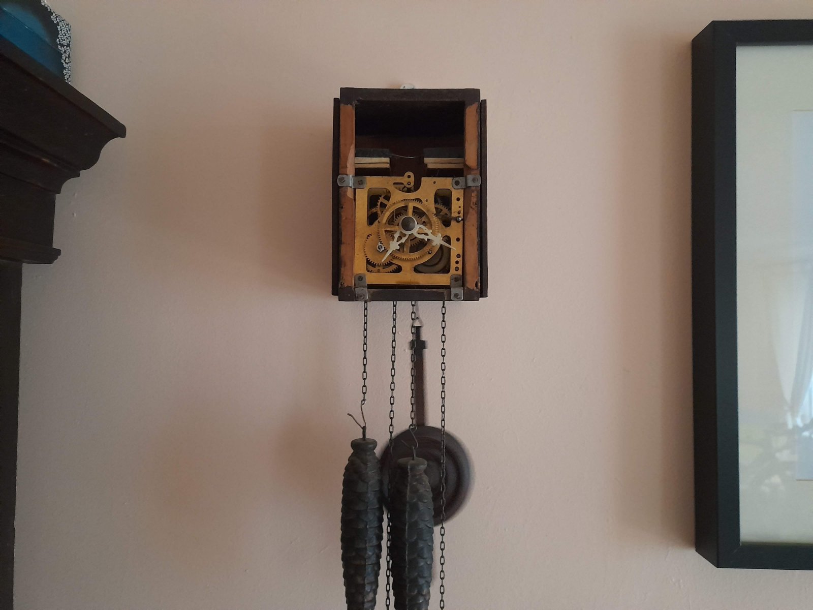

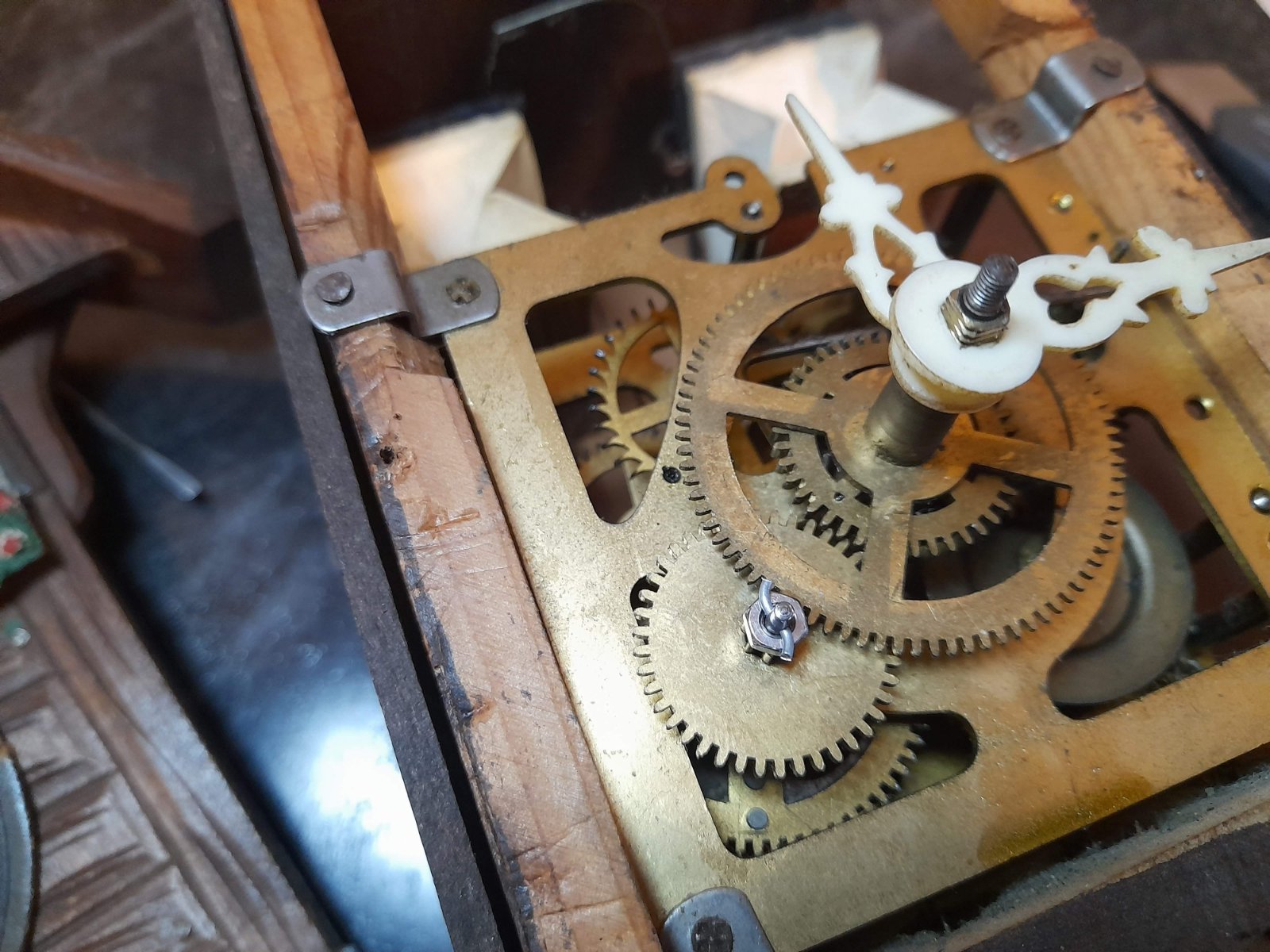

Me and Mick's magical and hugely enjoyed awayday to an auction house last week had a great side-benefit :)
A while back my cuckoo clock failed. It was ticking normally but the hand movements were very erratic. So badly in fact that British Rail made me a very good offer for it as it was just what they needed for timing trains...
I could see what the problem was but could not understand either how it happened or how to resolve it...
At the auction I spent some time looking at a box of clock movements and studying just how that part of the going train in similar movements was assembled and worked... I'd have bid on it if it was just the box of movements but it included 11 complete clocks... As much as I love old clocks, that would have been just too many - 11 too many in fact...
What I did win at the auction and did not want was a nasty bout of something horrible that laid me low all over New Year and made me miss two parkruns :evil: I'm only now just starting to recover and have been left with crushing ME-induced fatigue that's likely to take another week to fully resolve with lots of rest :twisted:
Today, I felt well enough to look at my poorly cuckoo clock - one that's very precious to me as it was one of dad's much loved clocks - and armed with my auction learning fixed it :-D
What had happened was a pin had made a successful bid for freedom at the end of the going train. This pin and a dished washer secured the final hand driving gear train to a shaft. Between this gear train and the rest of the going train is a leaf spring that acts as a friction drive and allows the hands to be moved to set the time.
With an M2.5 nut and a bit of steel wire from cable armouring I was able to approximate the lost parts :)
It is not the finest quality of clocks as most of the thing is put together with nails rather than screws!
And for that reason, whilst I have it on test to ensure it is 100% good I won't fully reassemble it...

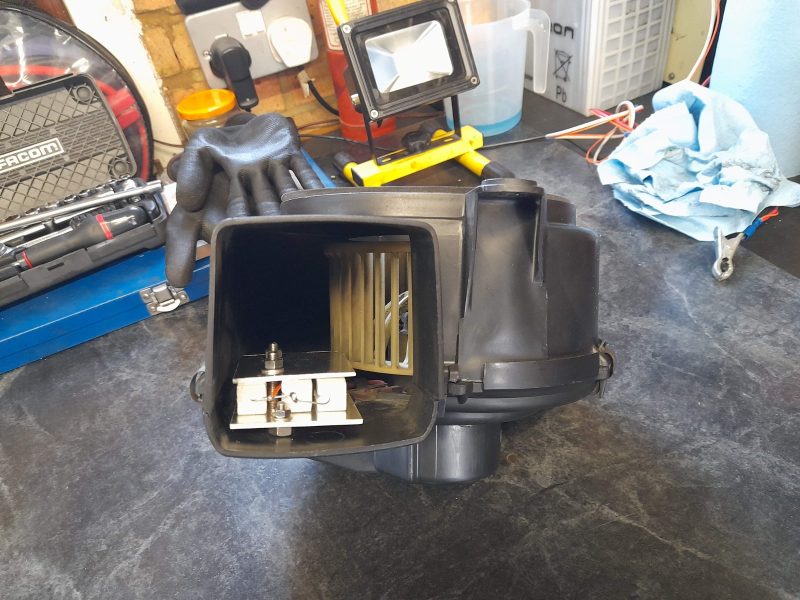

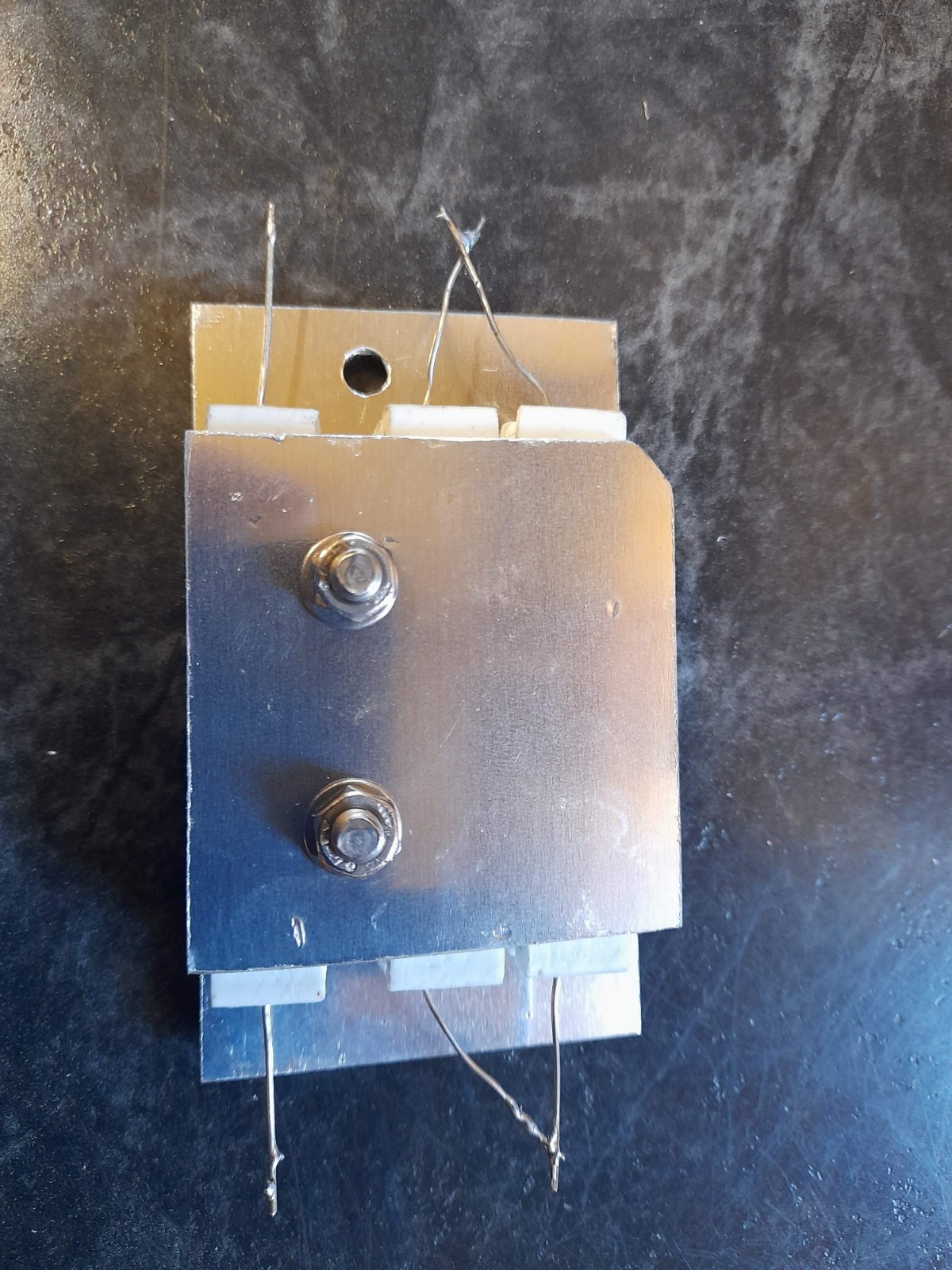

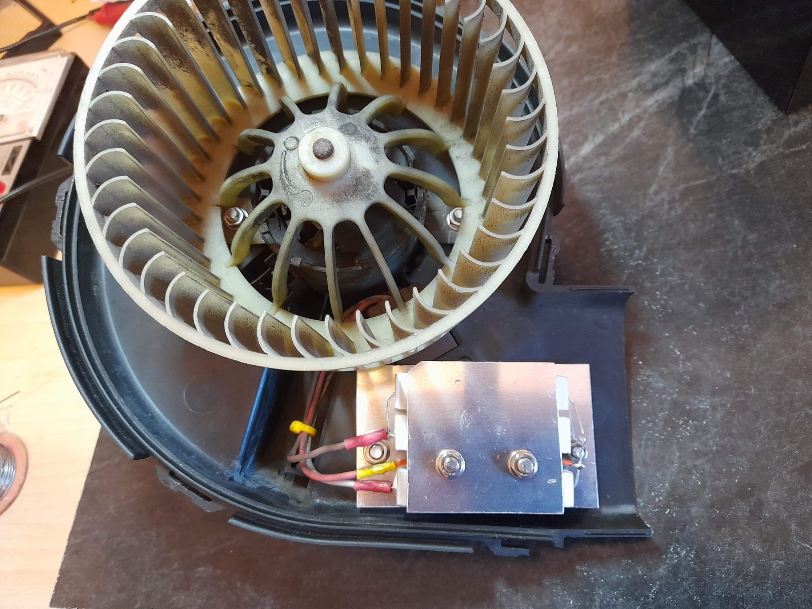

Today with gradually improving health and to keep the boredom at bay I had a session of fan-nying around with Bluebell's blower...
I went for the resistor option for now although the electronic controller project remains in the back boiler as a rainy day project...

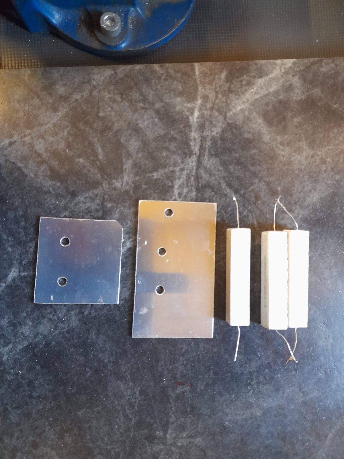

First job was to make up some aluminium plates to form a sandwich mount and heat-sink...
The tatty ends of the resistors are from an earlier quick and dirty test to make sure they were up to the job...
The slowest speed resistor is made of two in parallel to ensure adequate power handling...
Then I installed and wired it...
It runs very cool and doesn't project into the airstream too far but does enjoy a bit of forced-air cooling :)
I think I may have over-engineered it just a little :roll: :wink:
On a short road test it proved to work very well indeed... Three nice, quiet and evenly spread speeds are once again available...
I also replaced the fuel filter and I'm pleased to see Bluebell's fuel system is now largely free of contamination :)
