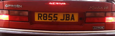

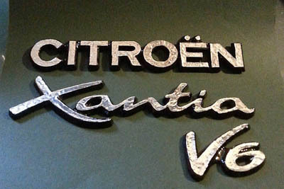

Original badges redone.....
to replace these

How did you do them al? Mine are faded to buggery

I used the inside of a foil packet (the outer wrapping of a 8 pack) of some Tunnock's Caramel Bars to give the chrome look and stuck down with epoxy, trimmed with a scalpel blade No10 when dried and cleaned up, then coated with epoxy (pouring type) to seal , this I then cooked off on top of a radiator once dry.
DIY sourced materials at its best....yummy as well :)
We model makers are a resourceful bunch when we need a material :)

I've seen the badges for real and they do look good!
