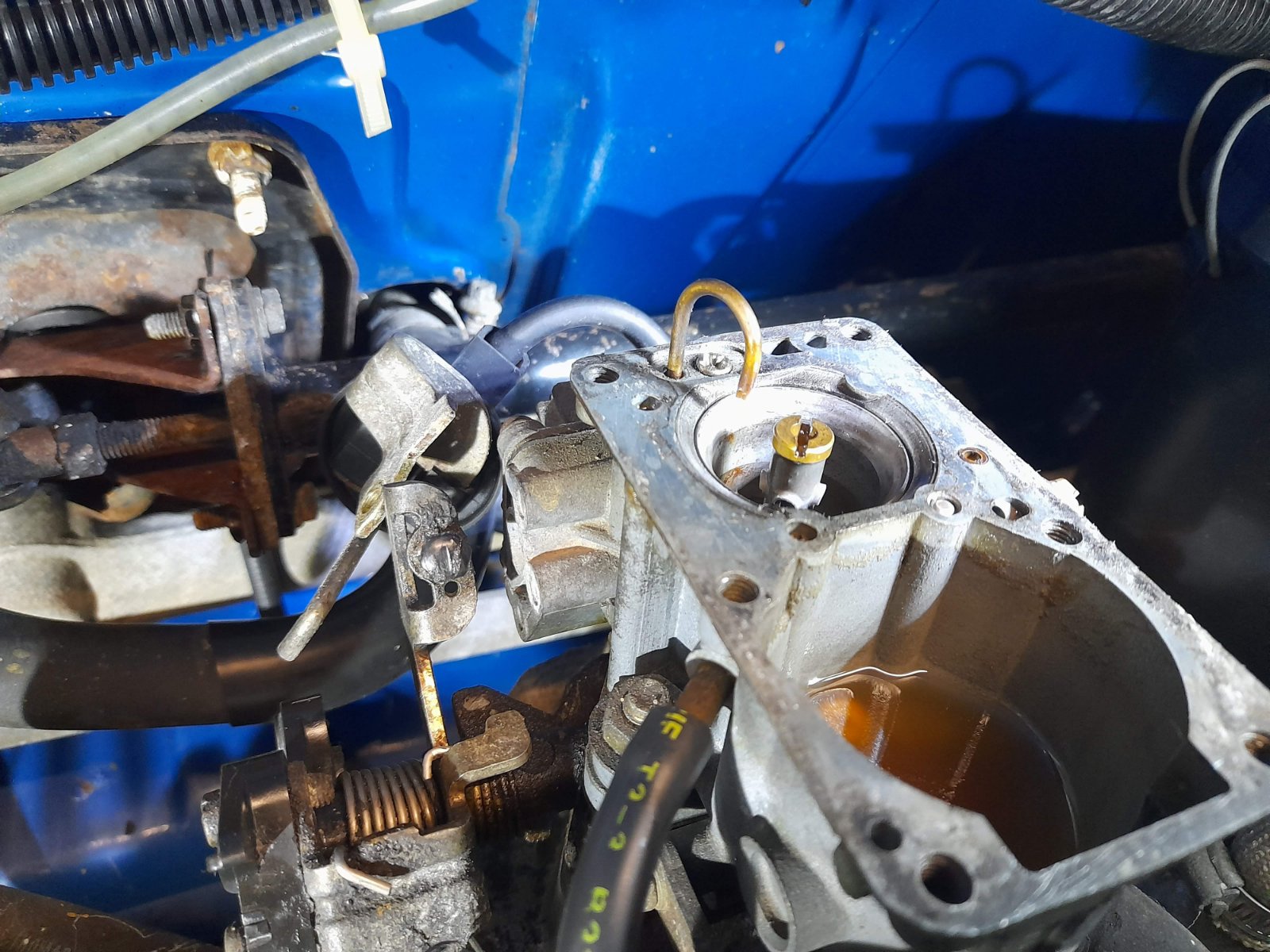

Speaking of blue, Bluebell's carb is now good
This is the carb with the lid removed showing the accelerator pump delivery pipe...
Note there's a little sediment in the bottom of the float chamber... That was entirely the result of running about 15 miles yesterday with the filter bypassed just in case it was the cause of the flatspot. It wasn't as these little filters have more than adequate flow capabilities... The relatively tiny drilling in the float chamber float valve body bears witness to that...

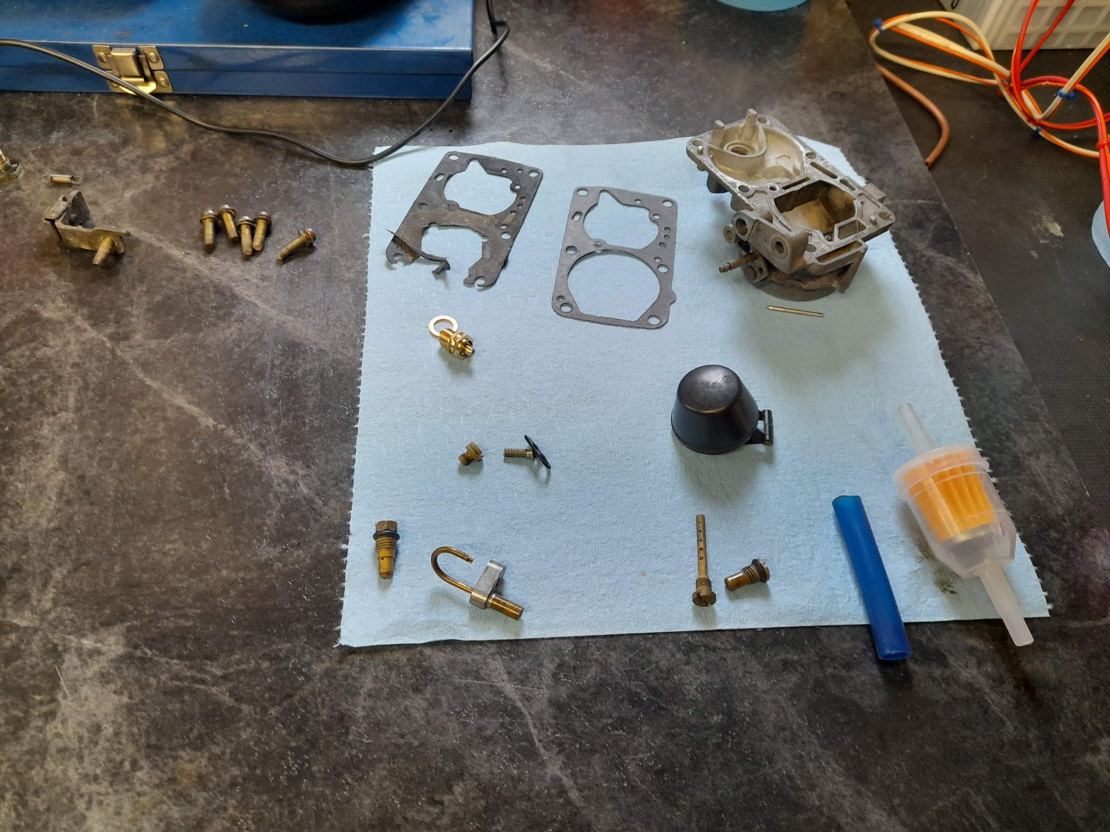

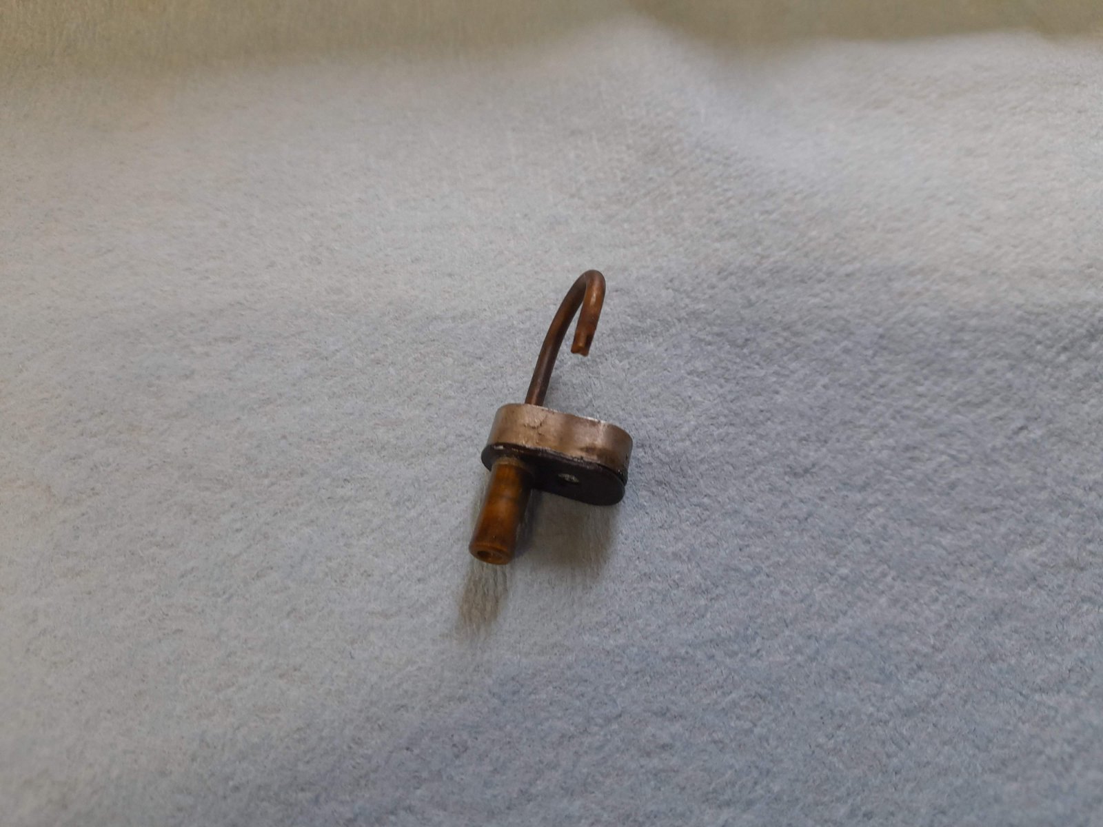

The problem was indeed the accelerator pump and a good blast of compressed air blew out a lump of muck... I also have a suspicion the non-return valve - a ball bearing - in the bottom of it was a bit gummy... Cleaned with carb. cleaner...
Happily, the diaphragm was good.
The very end of the accelerator pump delivery pipe is swaged to create a very fine orifice... Only a few thou' so easily blocked.
I pulled out all the jets, cleaned them - although they were all clear - and gave the body and lid a good scrub with carb. cleaner. All passages and drillings were blown out with compressed air.
I replaced the float valve with a brand-new one as this was initially badly gummed and another cause of poor and erratic running at the beginning of recommissioning...
All the bits were reassembled with a nice new lid gasket...
With a new fuel filter fitted I took her for a test drive and all is now very, very good
There's a lot of sediment still in the tank. The new filter showed some had collected in the bottom of it after just ten miles...
I'll be giving the tank a good clean out next time I'm down in Somerset... Alasdair and I have a cunning plan
For now I'll carry a few spare filters with me on each journey...

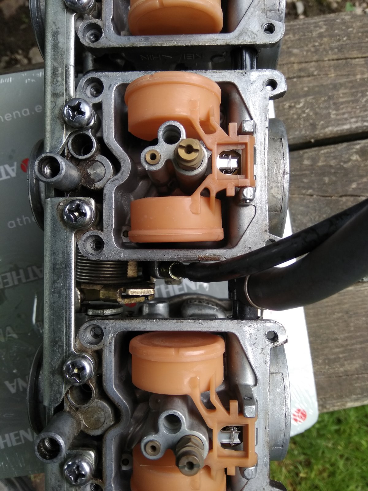

On the Zeph11 it was the very small holes in the front of the venturi. The bottom end mixture was impossible to set due to 'fuel tar' in the passage way that leads to the mixture screw.
The mixture screw hole can be seen on the far left with the jets removed.
A common problem on these CV carbs with modern fuel.
After stripping twice, carb cleaner, air line etc. they were getting better..... In the end I stripped them again and US'd the carb bodies. Still now I can't get the mixture screws to factory setting but can get the mixture right.

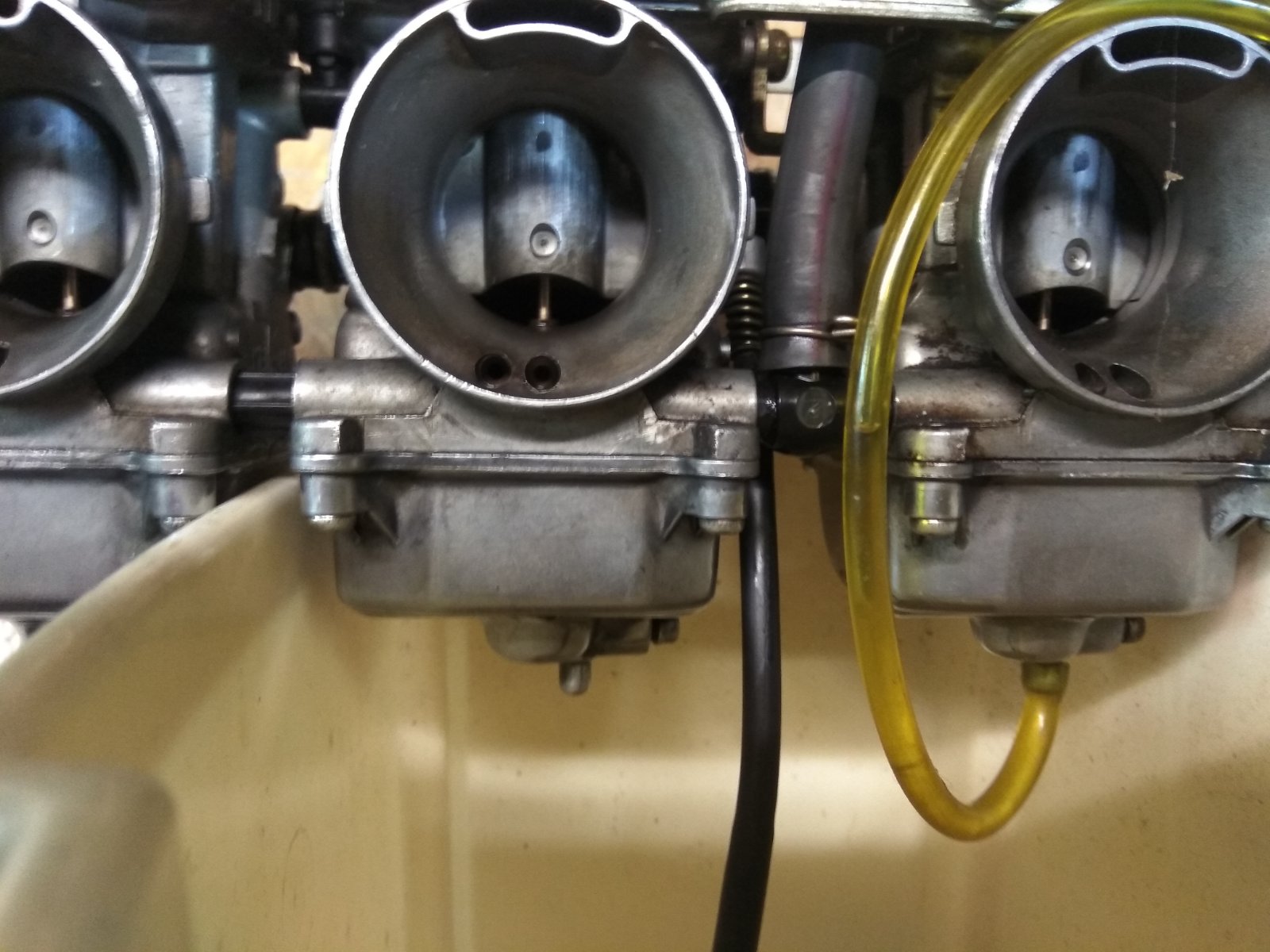

The photo also shows a clear tube that is used from the carb drain hole to set the float height. Turning them upside down and measuring the float height resting on the float valve isn't reliable due to the spring weakening and seat/float valve not being in perfect condition.
All 4 of the float valves also got replaced due to the carbs flooding no matter how I adjusted the tang on the floats. (at £30 each)
The chap in the club's carbs that emptied machining swarf into the US bath were brand new from the factory at a cost of £800. They will have been cleaned but he US'd them anyway and was quite pleased he did.
