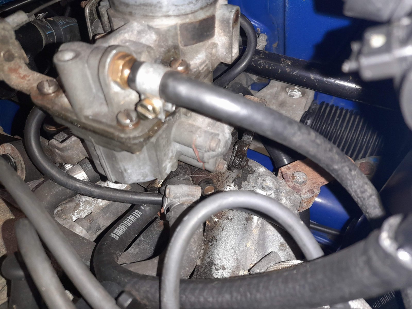

I've found the cause of Bluebell's flatspots when the throttle is floored... Her accelerator pump is not working... Sometimes it gives a little dribble but mostly nothing...
On a little run out in the countryside today I found she runs beautifully and is fully free of flatspots if driven with the choke a little out... In this mode she runs amazingly and is a proper grin-inducing hoot to drive
That she's fine running with a bit of choke explains why I found her choke warning light disconnected and the cable adjusted such that when the choke is fully pushed home the choke was still about an eighth on... Barry the Bodger could not be bothered to find the root cause, possibly many years ago...

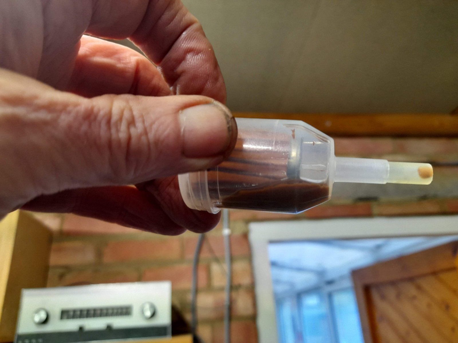

I found the fuel filter bears witness to there still being a lot of rubbish in the tank...
I'm replacing it with a reusable/washable one as I can see me getting through a silly number of disposable ones before the tank is clean again!
So, time to have the carb off. Made a bit difficult in that the coolant must be drained a little as the base of the carb is water heated...
I can also see just how bad the wear on the throttle shaft is. I can feel a bit of play and it being wet on the end bears witness...
That'll be weakening the mixture a little too if it's bad... That the end of the shaft is oily and wet - in the vicinity of the accelerator pump cam - suggests it's not very airtight... Having said that, there's no smell of petrol when the engine is running...
I may need to source another carb...
The gearbox is a little whiny at certain speeds but not badly so... There's no sign of it in neutral or when going fast... Disengaging the clutch shuts it up so it's only there on-load... Sounds a bit like final drive to me... Presently it's not anywhere near bad enough to worry about.
Apart from the carburation issue and this occasional whine Bluebell drives really quite sensationally and is an absolute hoot... She reminds me why I so loved my AX11TGE back in the early 90s

A man of your skill should be able to sleeve the throttle shaft, Jim!
Had similar trouble on our Visa which has the same Solex carb with the acel pump - the swan neck nozzle was blocked, presumably with dried up fuel. I think I cleared it by soaking it in carb cleaner. IIRC you can pull the nozzle out of the carb body? If you have got crud floating about, you will probably also become adept at removing and cleaning the idle jet....
- Posts: 55131
- x 8412
Re: Citrojim's AX, Saxo, Pixo, Running and Cycling Tales
Absolutely RichardRichardW wrote: 29 Nov 2022, 15:13 A man of your skill should be able to sleeve the throttle shaft, Jim!
Yes, once the lid is off, one small screw and out it will come... I'm expecting a perforated pump diaphragm as on your R4 Steve as manually operating the pump arm does not feel quite 'right' if you know what I mean... I'd also not be surprised if the passage from the float chamber to the pump was not clogged based on how much crud I found in the bottom of the float chamber when initially investigating poor running and erratic idling.RichardW wrote: 29 Nov 2022, 15:13 IIRC you can pull the nozzle out of the carb body? If you have got crud floating about, you will probably also become adept at removing and cleaning the idle jet....
I've already had to clean the idle jet a couple of times Richard, it's a good job it's easily accessible! Which is more than can be said for the main and progression jets which are buried in the bottom of the float chamber...
Every trip will be accompanied by sufficient tools to whip off the lid and clean jets as and when necessary until I get some degree of confidence all the crud is gone... It could be a while...
