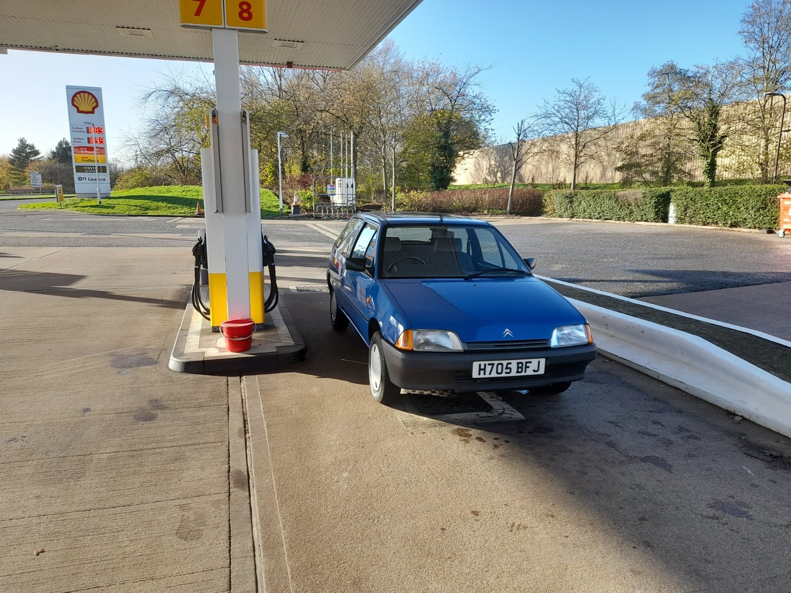

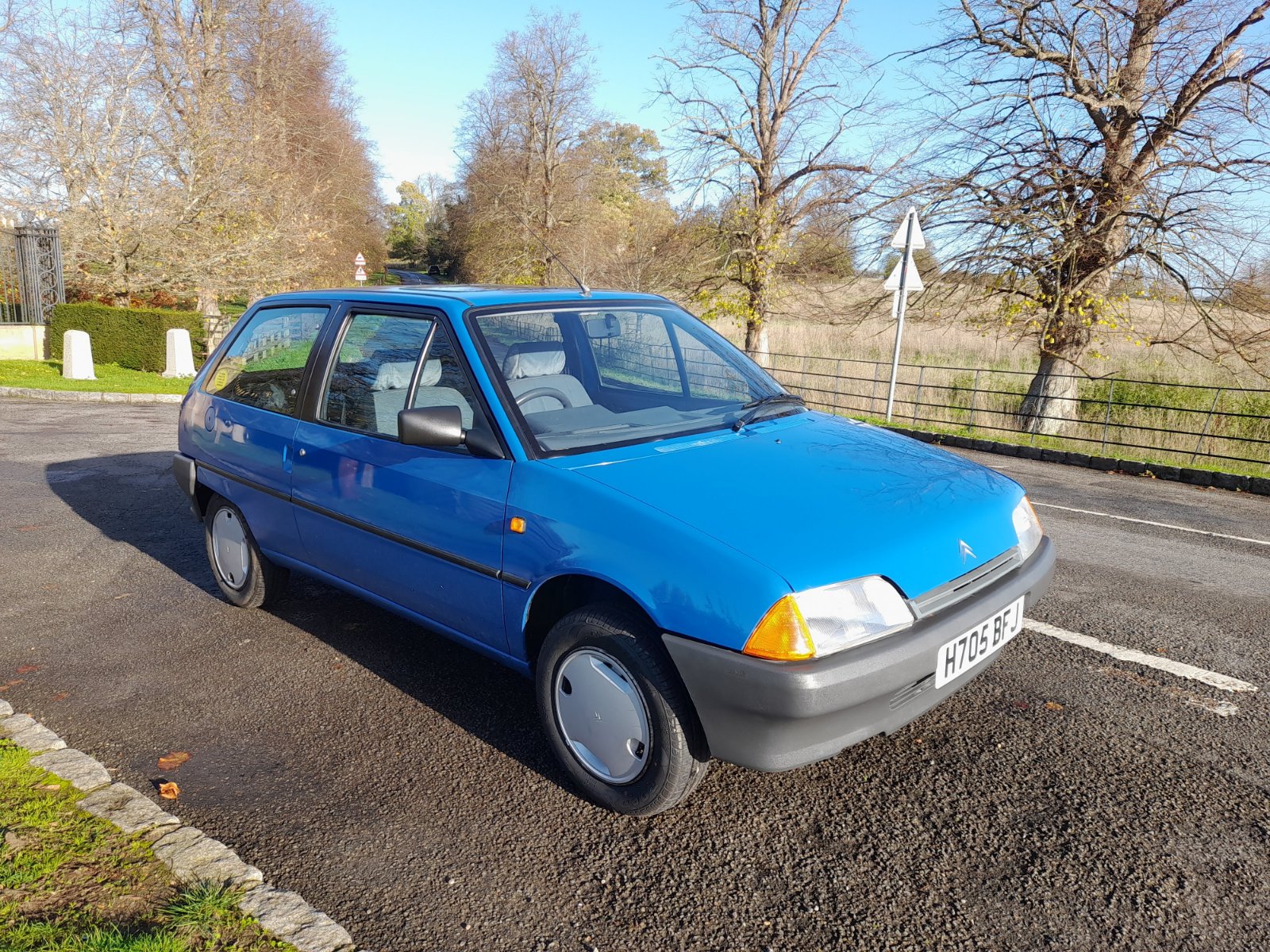

After nearly three months of work, she's been out today and what a lovely day for it
First port of call...
She drives beautifully and is very comfy - her seats are superb. I have to say she's a raw, edgy, engaging and a noisy little thing but huge fun and very satisfying to drive as you are so in touch with it. The S2 AX is a lot more refined and I suspect they have a lot more sound-deadening! I know the S1 has very little of any consequence...
Just one problem... carburation is not right and she has a significant flat-spot when the throttle is floored from idle. It feels like the progression circuit is blocked or the accelerator pump is not delivering the correct amount of fuel. Once past that she's fine... Knowing how much dirt and silt I found in the float chamber when I popped the top off back along I expect the rest of the fine passages will be a bit gummed and furred up too...
She's very eager and willing and may suggest that the 1.1TU with a carb is livelier than the same engine with single-point injection. Compared with my 1.1 Saxo anyway! An apple and pears comparison as the Saxo weighs about twice as much as an S1 AX!
I stopped in a pretty-ish place to take some photos of her after she'd ran 30 miles...

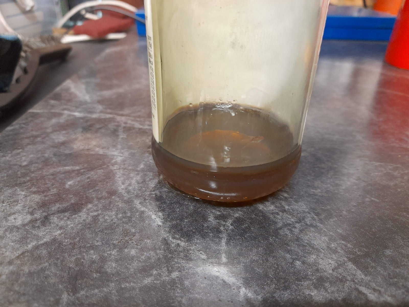

I felt the gearbox was a little noisy so decided to do an oil change whilst it was nice and hot... It would be interesting to see what the oil looked like... But first, given it was such a lovely day I needed a bike ride...
I rode out to where I took the photos of Bluebell earlier...
I then took bluebell out for another run and then dropped the gearbox oil...
The drain plug was not as swarf'd up as I expected...
And the oil looked OK but compared to the new 75W/80 stuff it seemed a good bit thicker, especially as it was still warm and the new oil stone cold... Wrong grade maybe...

That gearbox oil doesn't look too bad at all! As a comparison, here's the (presumed never changed, only topped up) 140,000 mile gearbox oil from my C5
New on the left! Pictures don't really emphasize the extent of it, but the old stuff was completely opaque and grim!

I was fully expecting Bluebell's oil to look like your C5's old oil Matt, but worse. I was shocked!
I was also shocked not to see a full family of hedgehogs living on the drain plug magnet...
Maybe the gearbox oil was changed not so long ago, relatively... That may be so as I can see one of the driveshafts is not the original...
