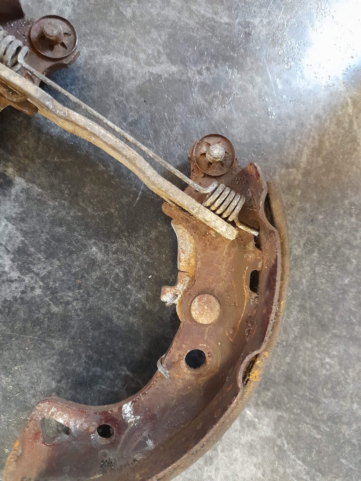

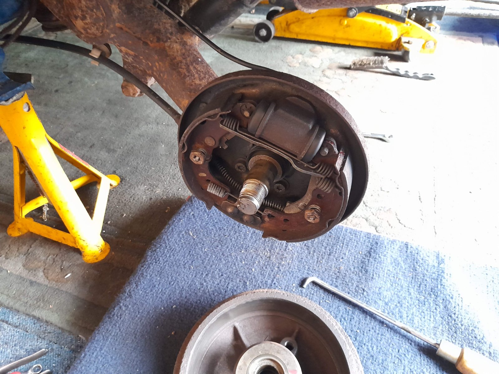

Not much done today as I still had a lot of domestic catching up to do but I did get the LH rear brake rebuilt after a good refurbish of the components...
It took ages to reassemble... Those springs take some serious work to get home! I can see why so many hate working on drum brakes...
All nicely cleaned up and reassembled...
Note my special spring hook in the picture... It started life as an ML5 clutch release bearing engagement tool. It could still be used for that but a bit of grinding has make it a very functional drum brake tool... I very much doubt I'll ever do another Ml5 clutch...
I've now started on the other side...
The self-adjustment mechanism was well seized, just as on the other side...

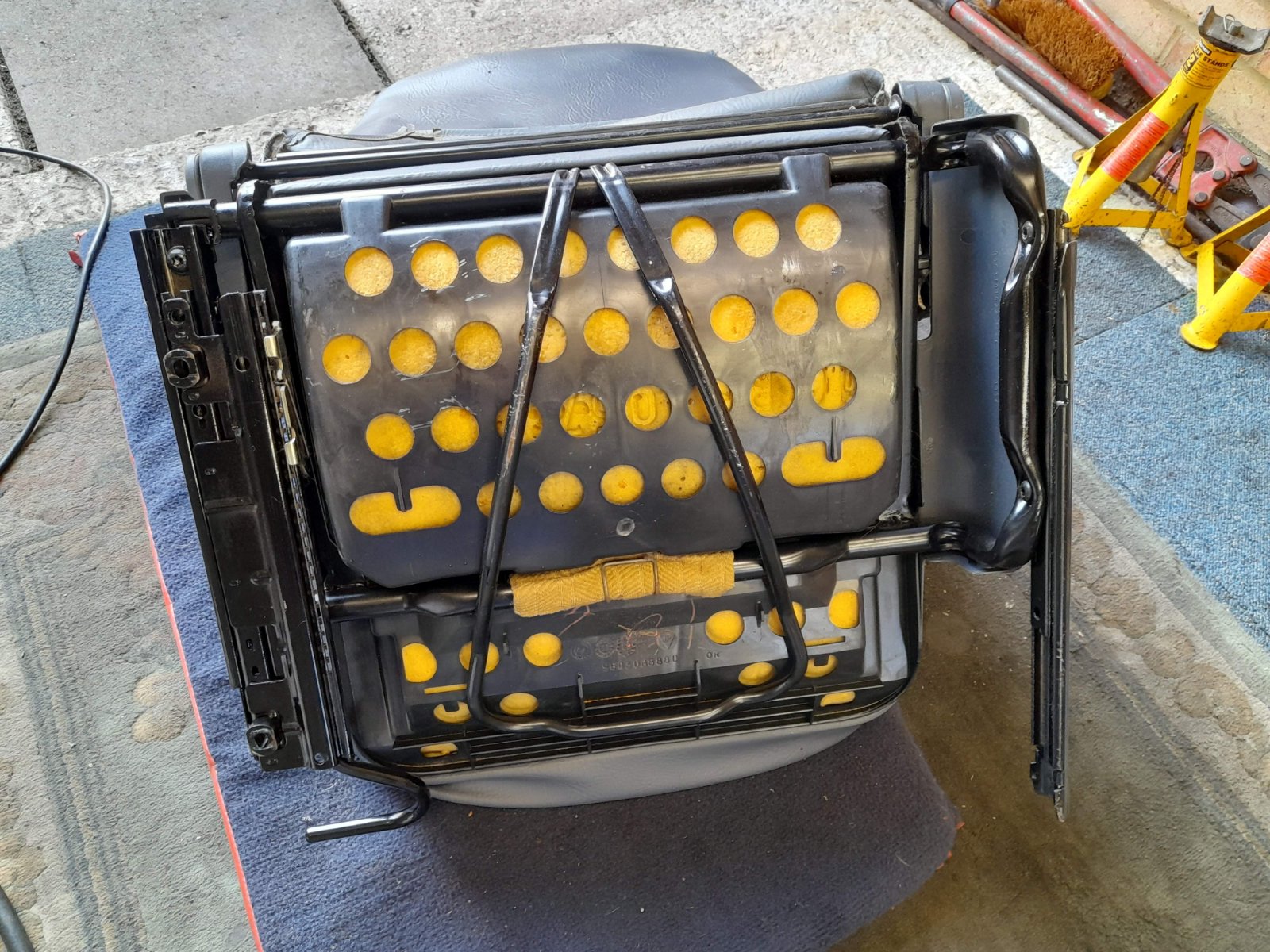

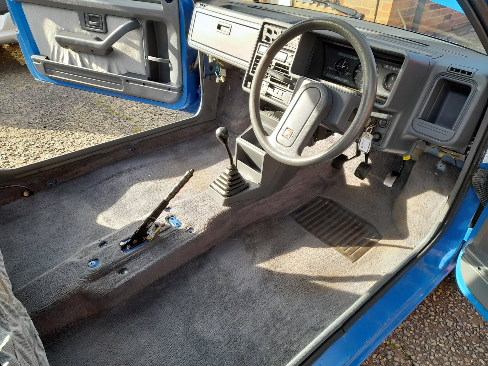

First up, the seats... Both were very tight on their runners... So it was out with them and their runners were treated to a good clean-up and some new lube... They now slide beautifully...
Whilst the seats were out I gave the interior a good vacuuming... It was needed as the former owners owned a very hairy dog...

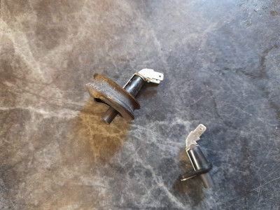

The handbrake shroud was loose so I removed it primarily to do a good vacuuming job but also so that I could fix the handbrake warning light switch... It was annoying me by not working...

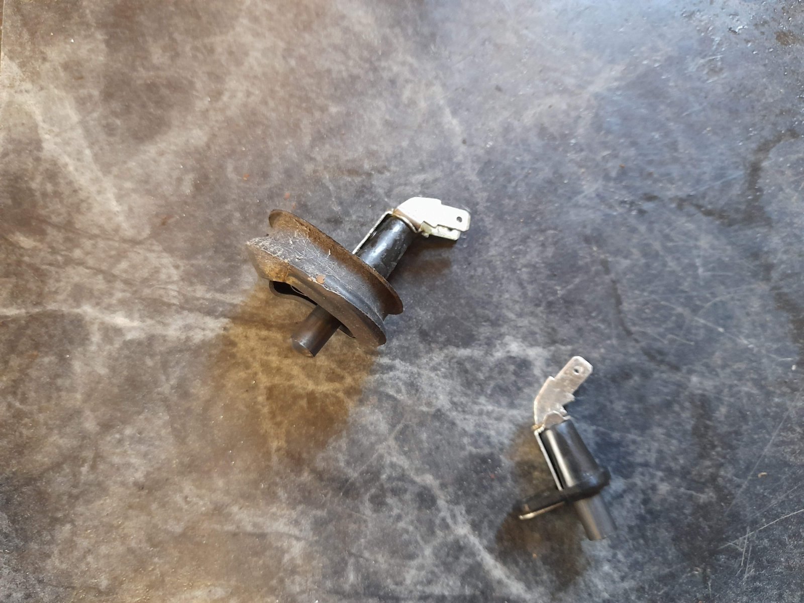

At the same time I did the driver's side courtesy light switch...
Something else that's annoying me is a couple of duff illumination bulbs in the instrument pod... I shall fix that in the not too distant...

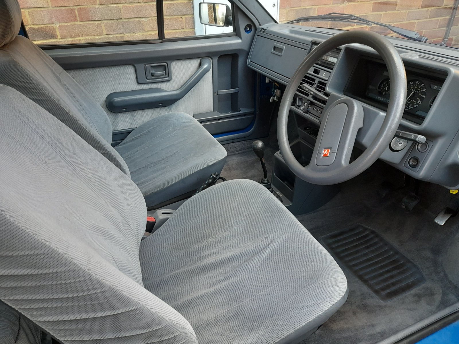

The interior is looking quite tidy now...

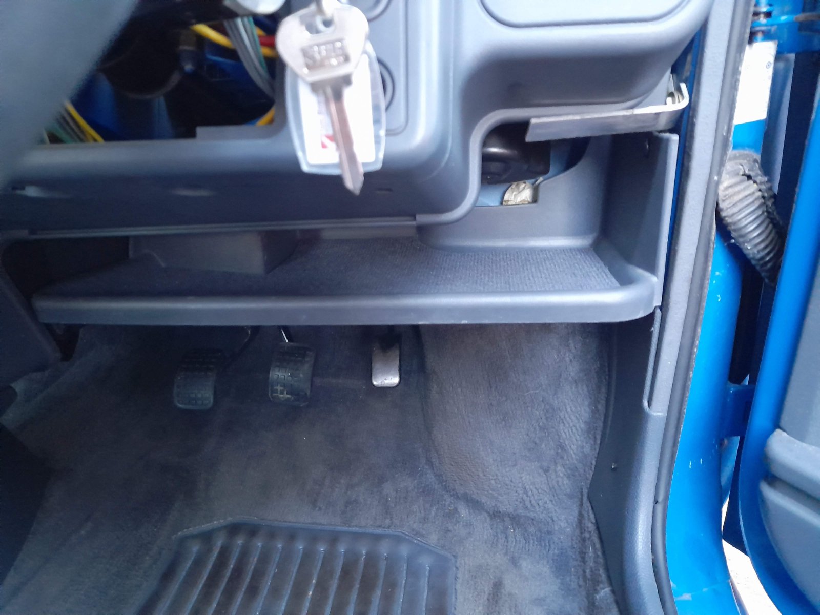

Sharp eyes might notice the under-dash parcel shelves are missing... I have them and and for reasons unknown they were removed before I got the car... Hampering their refitting was a few missing clips... Looking in the ashtray I found them! Result! Also, looking in both ashtrays there is evidence the car has never been smoked in...

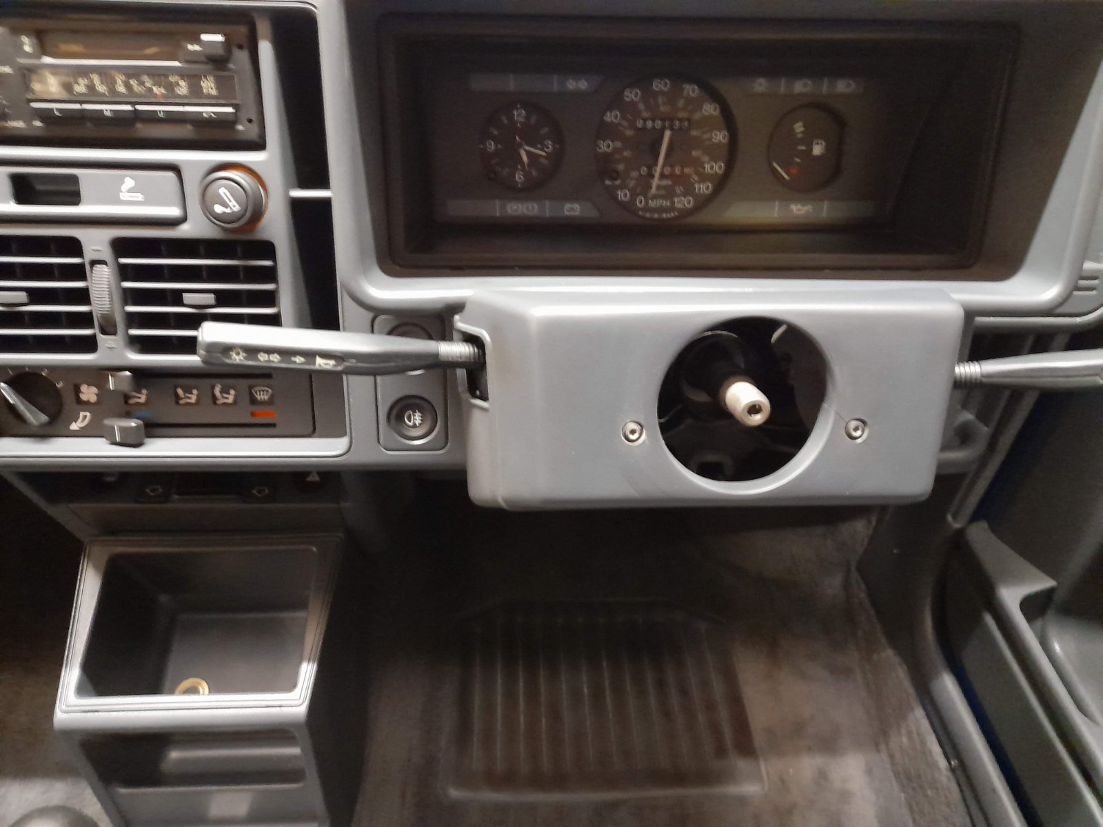

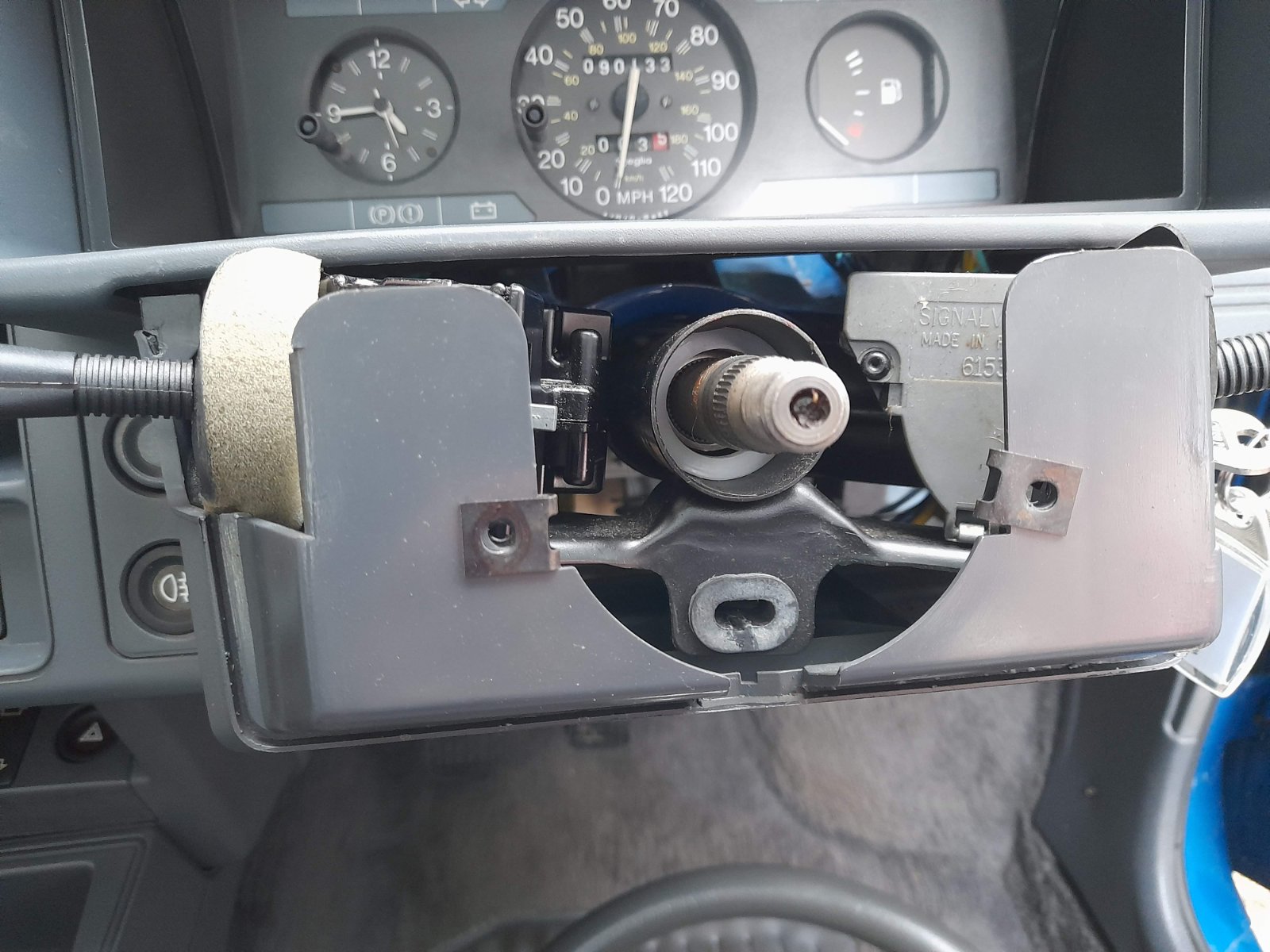

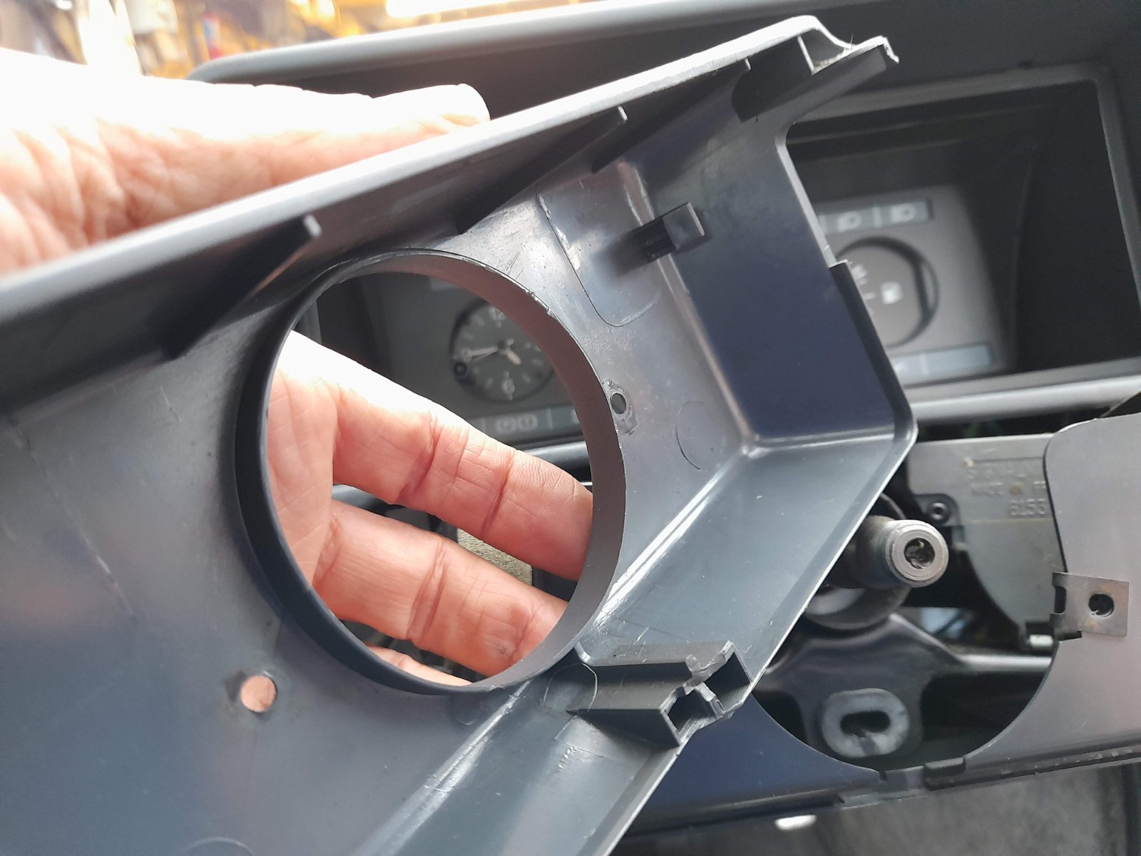

Just some easy stuff on Bluebell today... I was keen to see why her steering column cowl was all floppy and fix it as it tended to foul the indicator stalk...
I carefully dismantled it... Very carefully as 33 year old AX dash plastic is now very brittle...

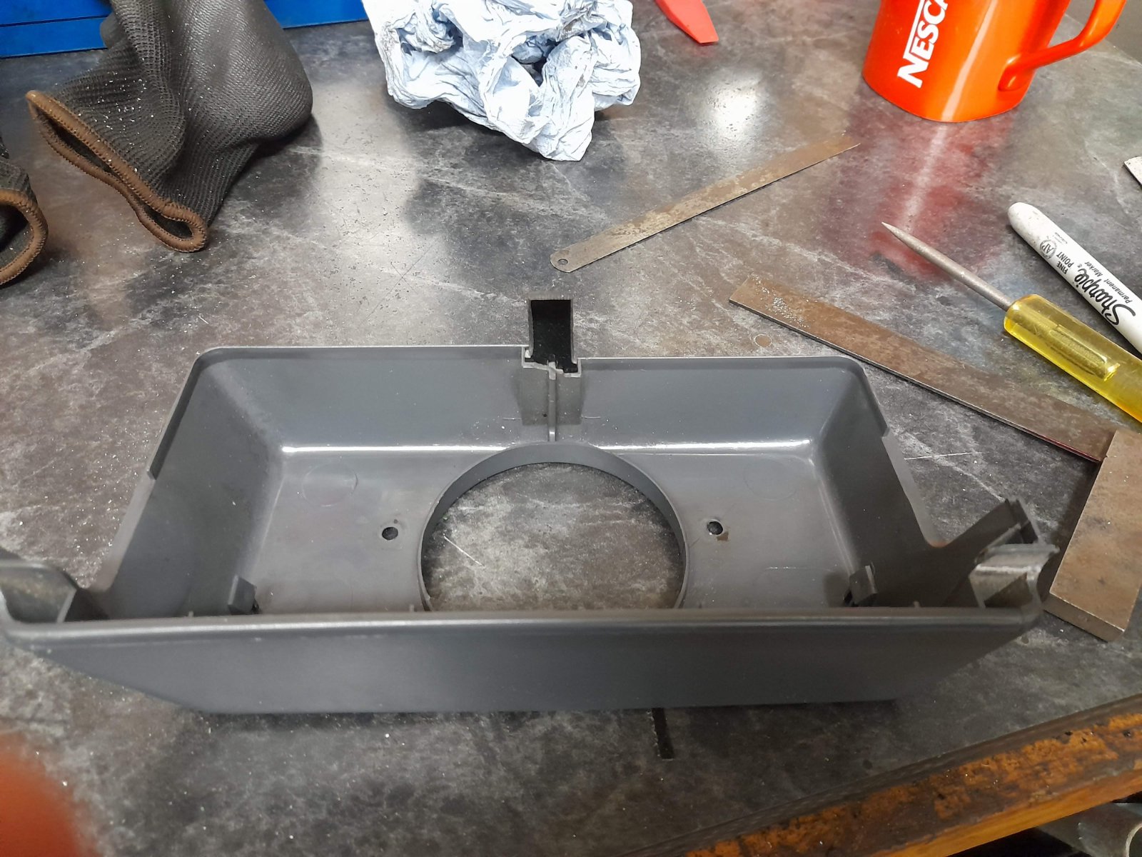

Sadly, the previous dismantler was not as careful and broke the tongue on the front part of the cowl that pushes into the rubber grommet on the stalk frame...
I've now removed all the cowl to enable me to fabricate a new tongue on the bench...
Meanwhile, I've refitted the driver's side parcel shelf :D

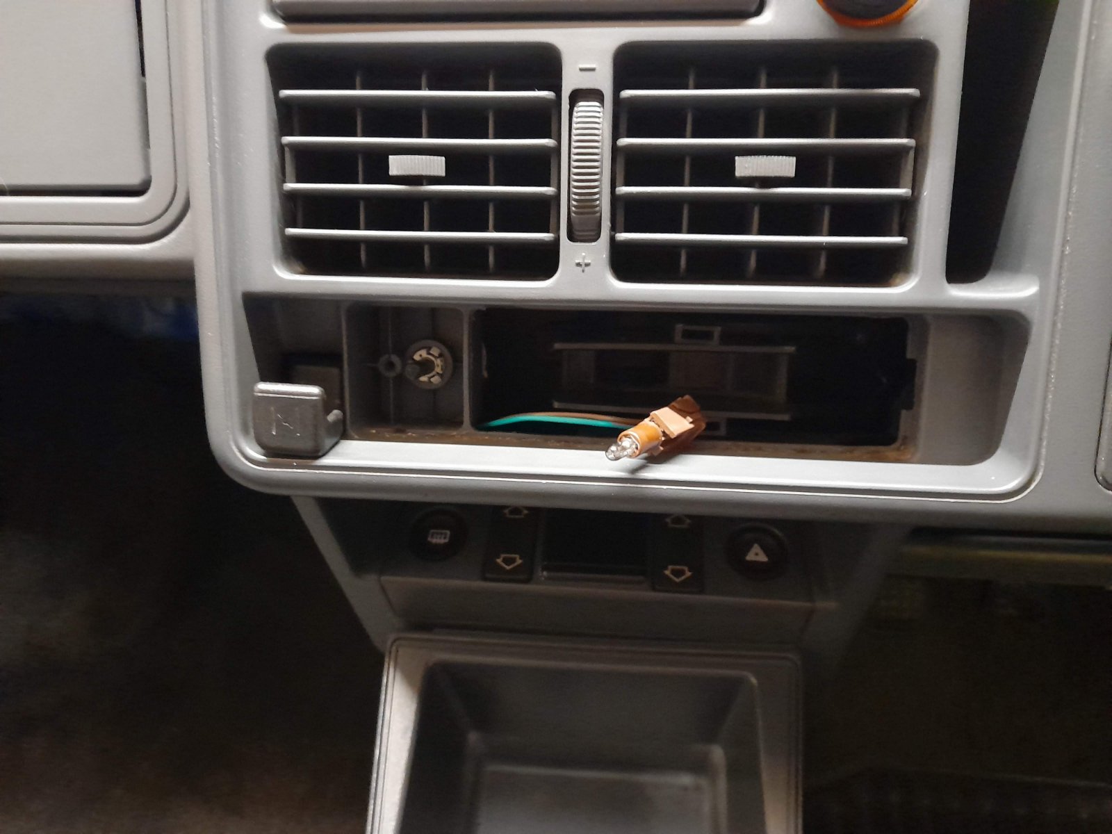

Tomorrow I shall continue and also, whilst the dash is almost in bits I'll replace the blown dash illumination bulbs...

Yes, it is as my dash has broken where they all do... That support bracket is not very elegant but it does the job for now until I can fabricate something more pleasing... To do that properly will entail a full removal of the dash and some involved fabrication... The passenger side is the same...
I will have to at some stage as the choke control bracket is not in the best of health and to fix that it's definitely a dash out job...
Remarkably, compared to most my dash is in very good condition!!! I've seen them little more than a pile of plastic splinters! S1 AX dashes were not Citroen's finest... Made by a company called Allibert which I believe also made toilet seats... says it all really :lol: :lol:

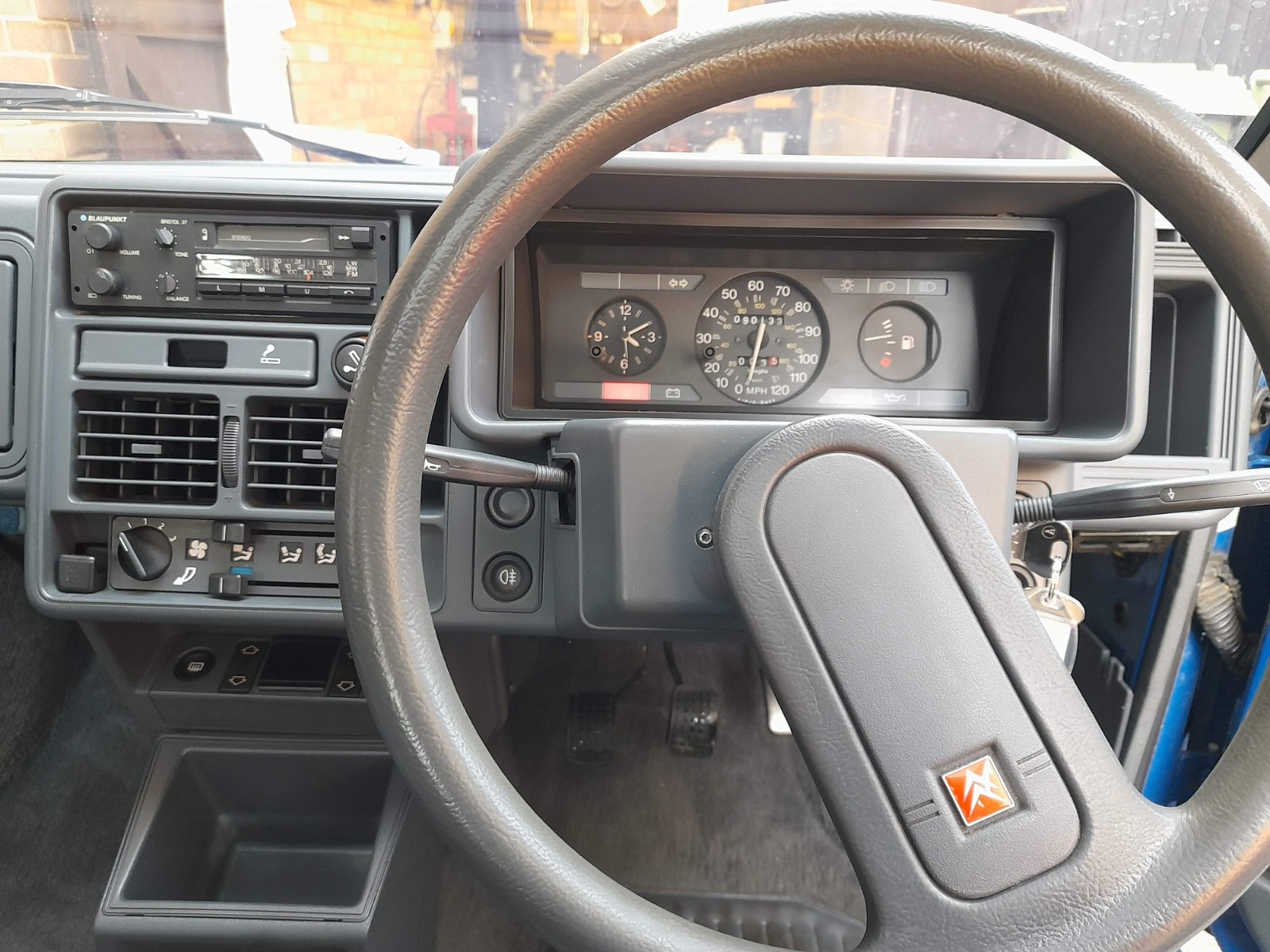

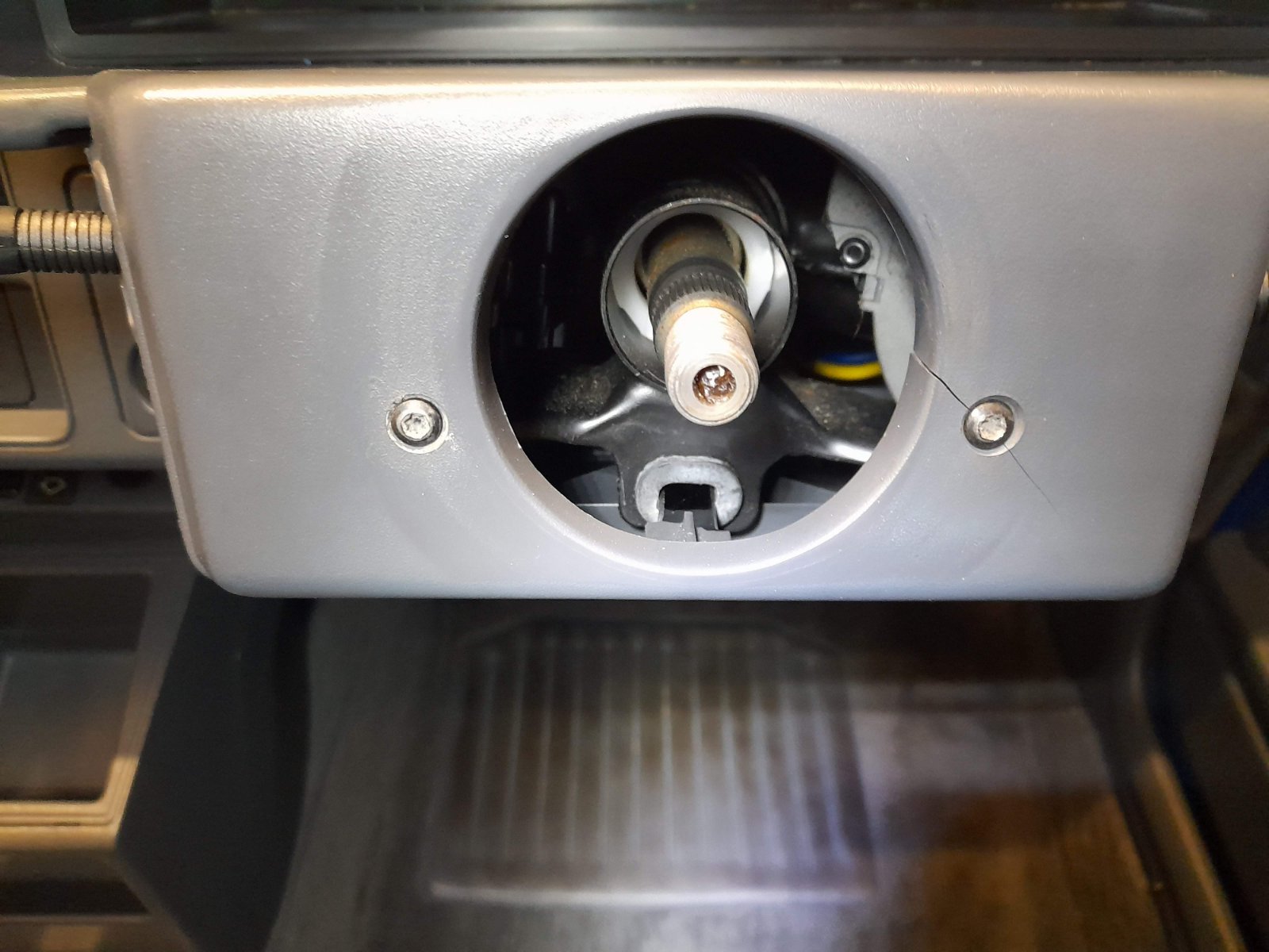

I fixed the wobbly steering column cowl by making a new 'tongue' for the front part...
It's done the job a prefect treat :D I have a nice firmly mounted cowl that's no longer fouling the indicator stalk...
The crack by the screw is an old wound...

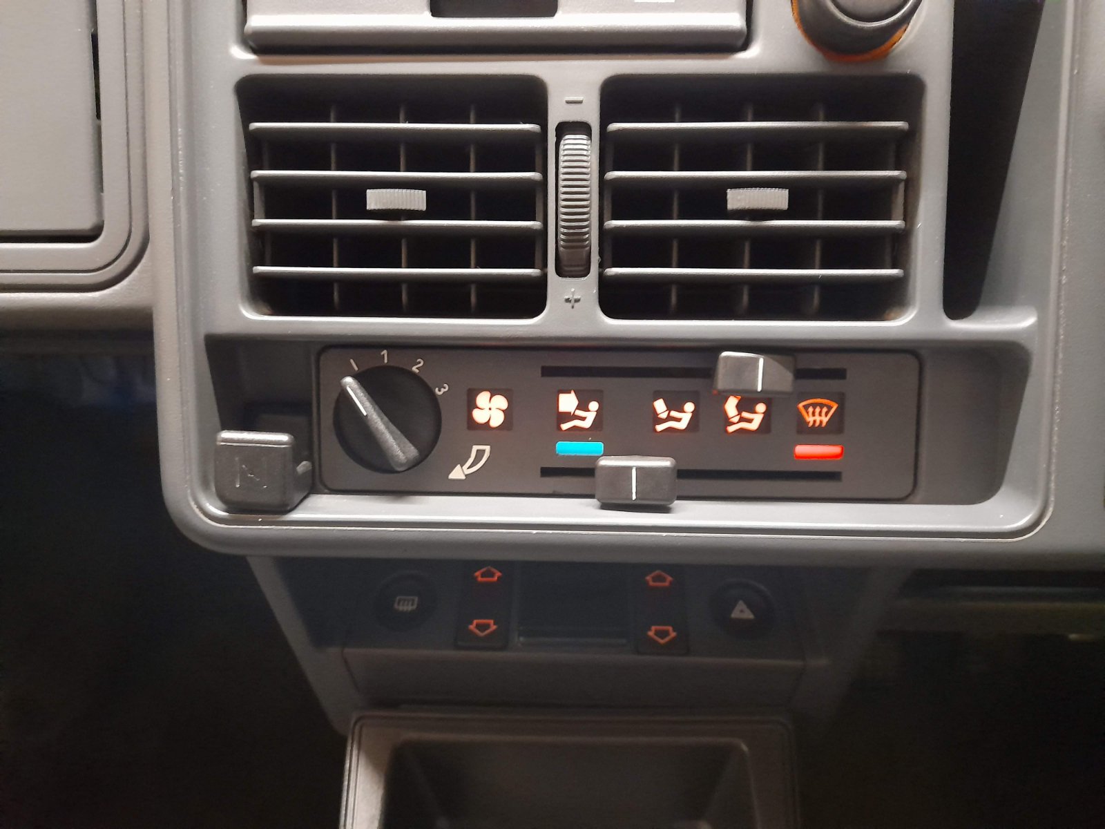

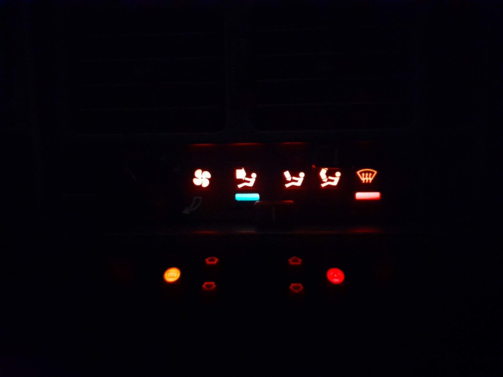

Another little job was to replace the blown bulb behind the heater controls...
That's better :D
Tomorrow I'll be looking to replace the blown instrument illumination bulbs as a partially illuminated set of instruments is now allegedly an MoT advisory... Sensible as the one instrument that's totally dark is the speedo...
However, given the delicate nature of the Series 1 AX dash plastic I need to do this job with extreme care and will be taking specialist advice... Mr. Haynes in his BoL is a bit glib about it... 'Release the clips using a thin screwdriver...' That may have been good 30 years ago when the plastic still had a bit of 'give' in it but now with it as brittle as glass I'm not so sure...
