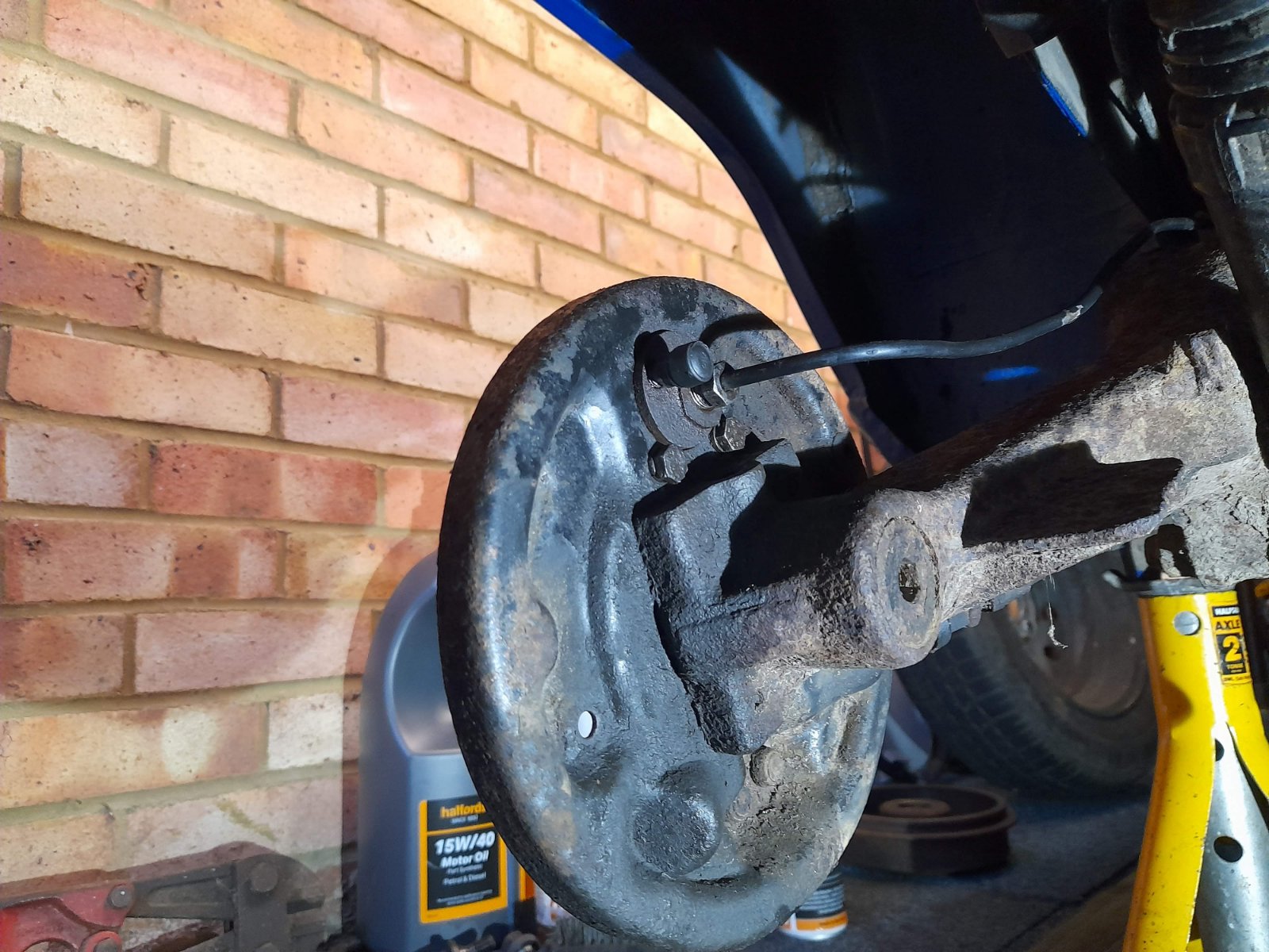

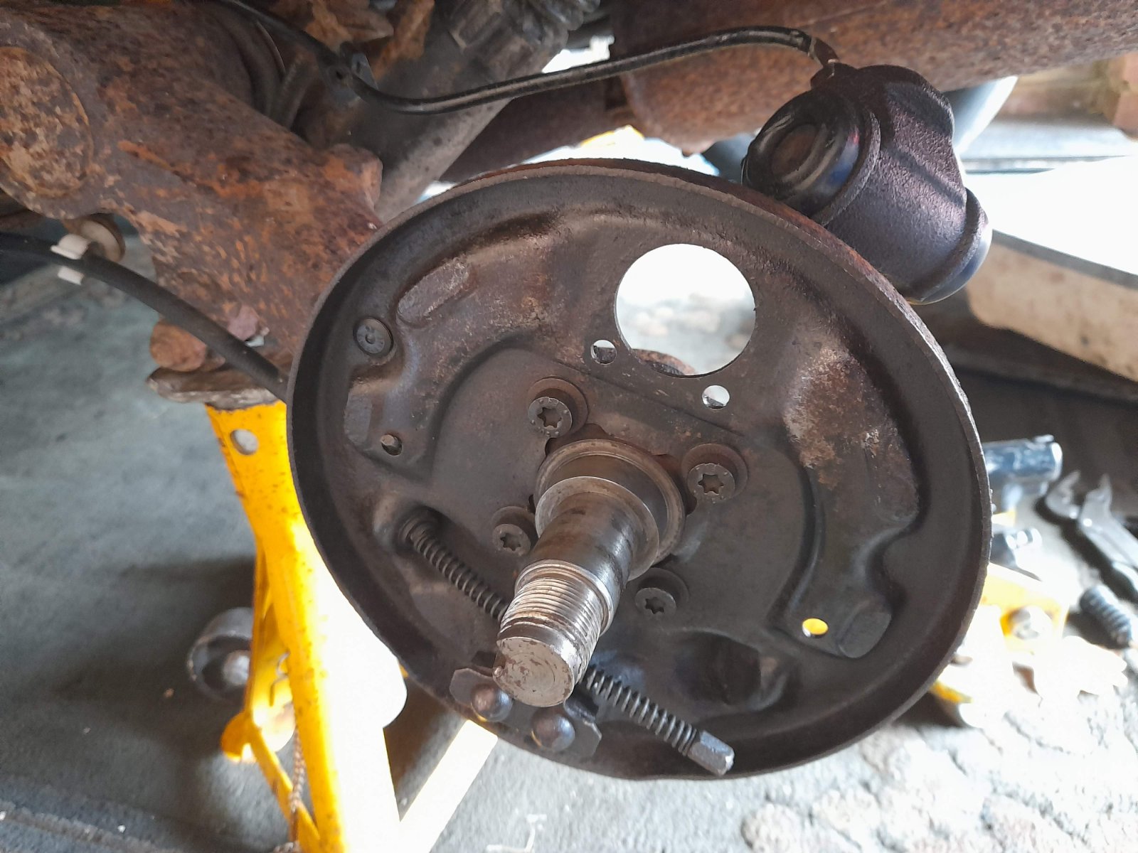

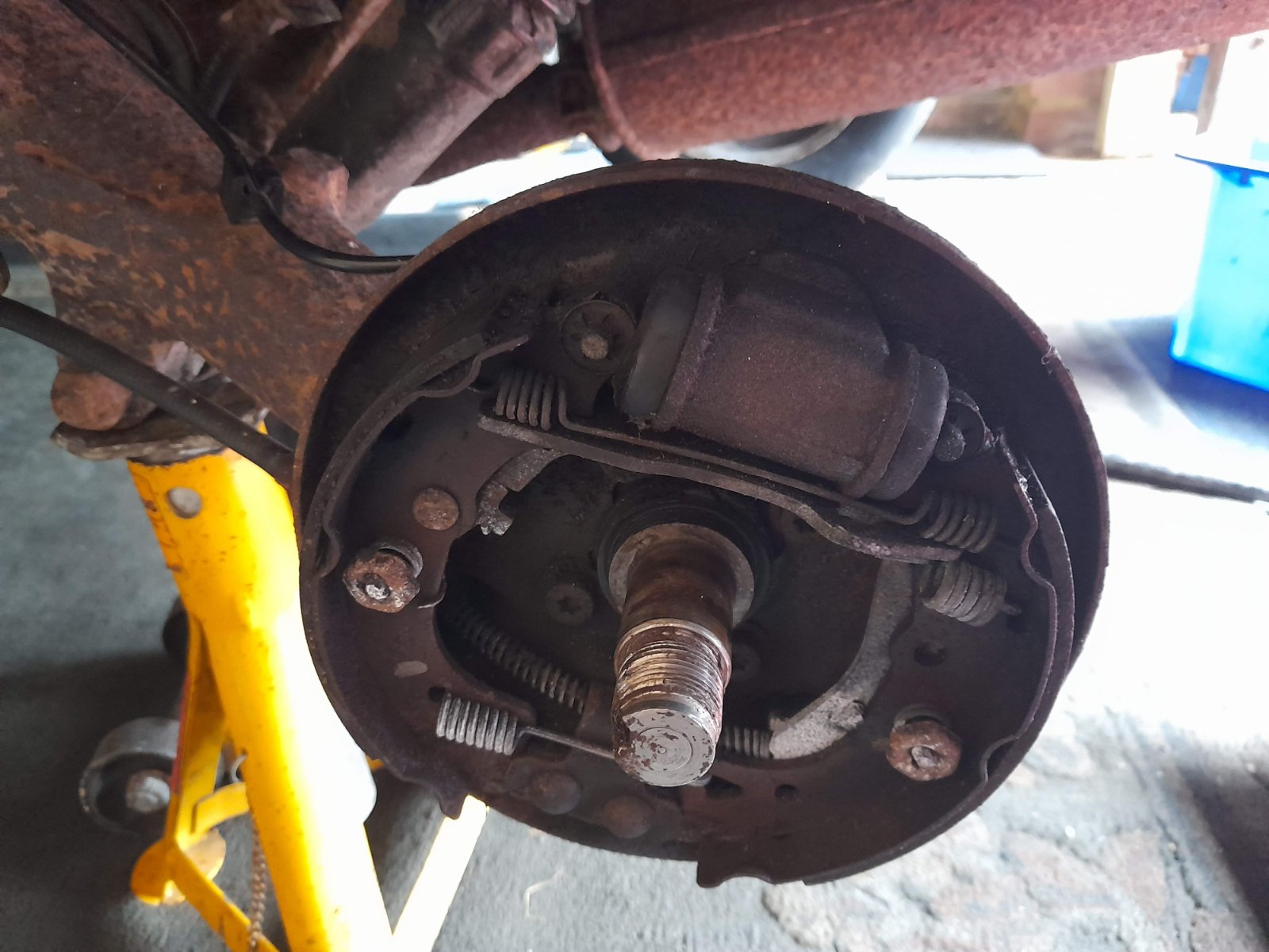

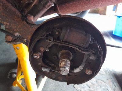

Today was to be a relatively straightforward job of replacing Bluebell's weeping wheel cylinder... It started well enough and removal of the drum revealed a quite manky scene within...
The shoes are in good enough condition with no contamination - I caught the wheel cylinder in time...

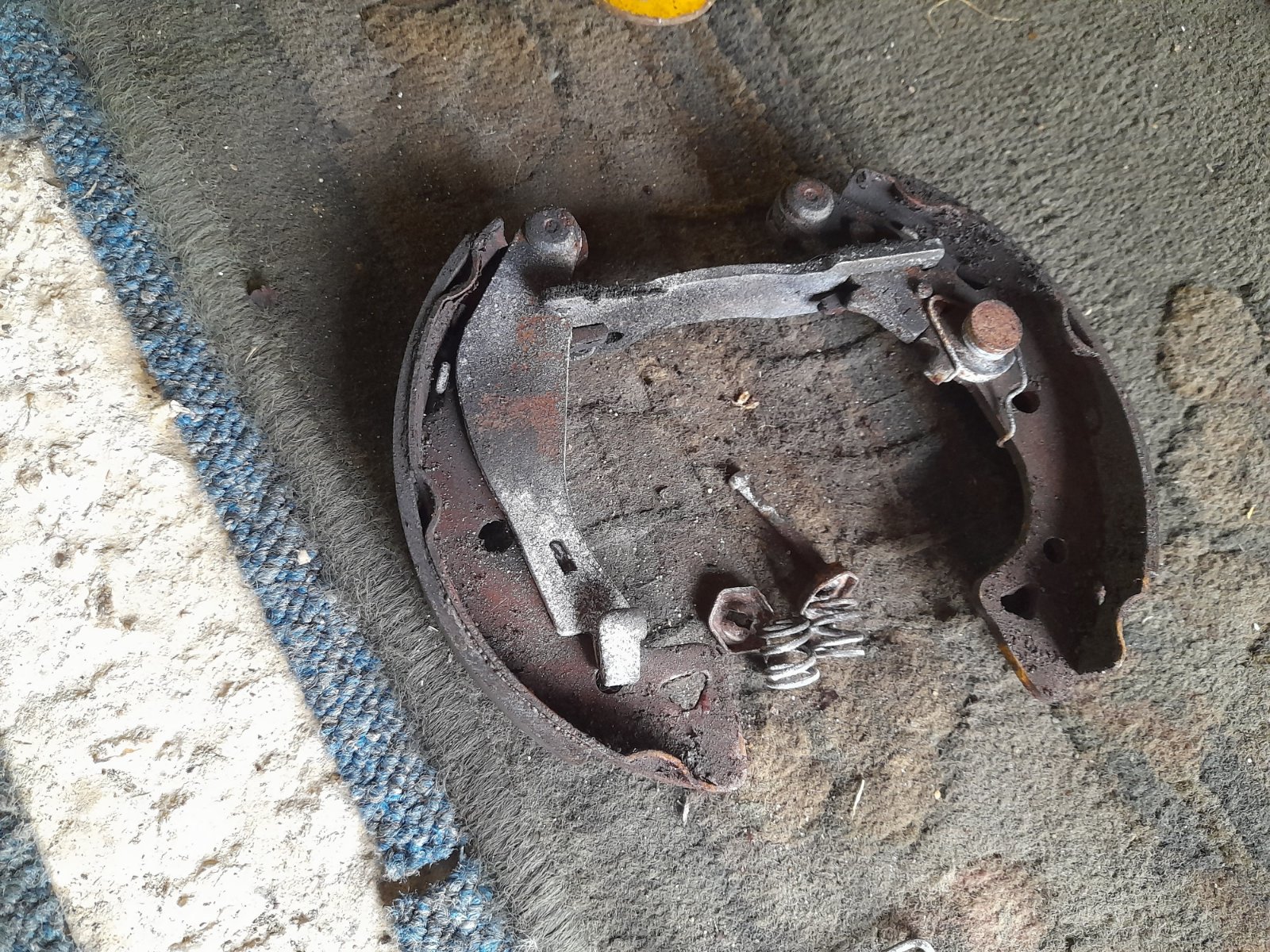

All the self-adjusting bits were seized but with a bit of work they all freed off nicely... A good wash in brake cleaner and they're now good to go :)

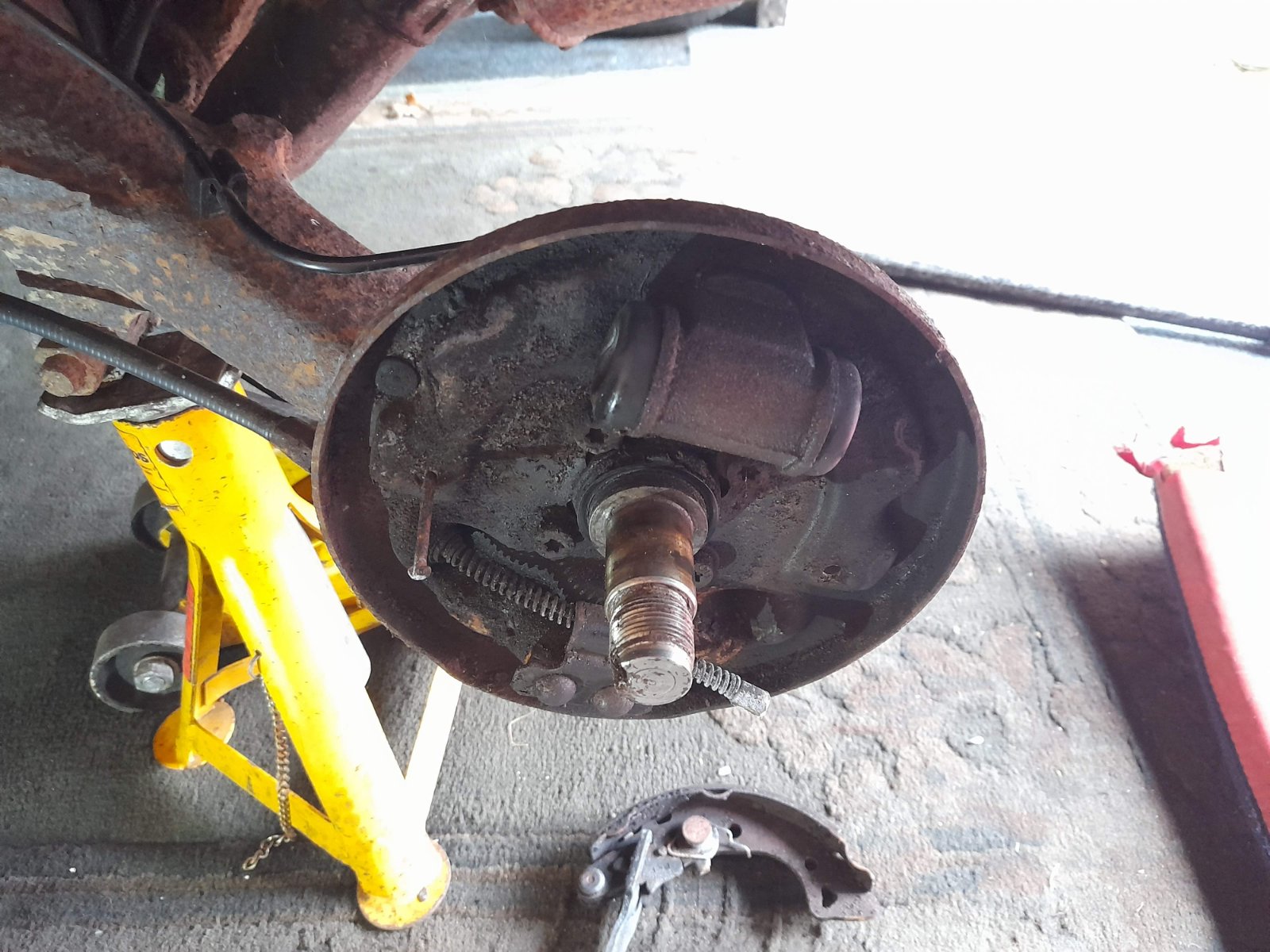

The backplate was in a state but it cleaned up nicely...

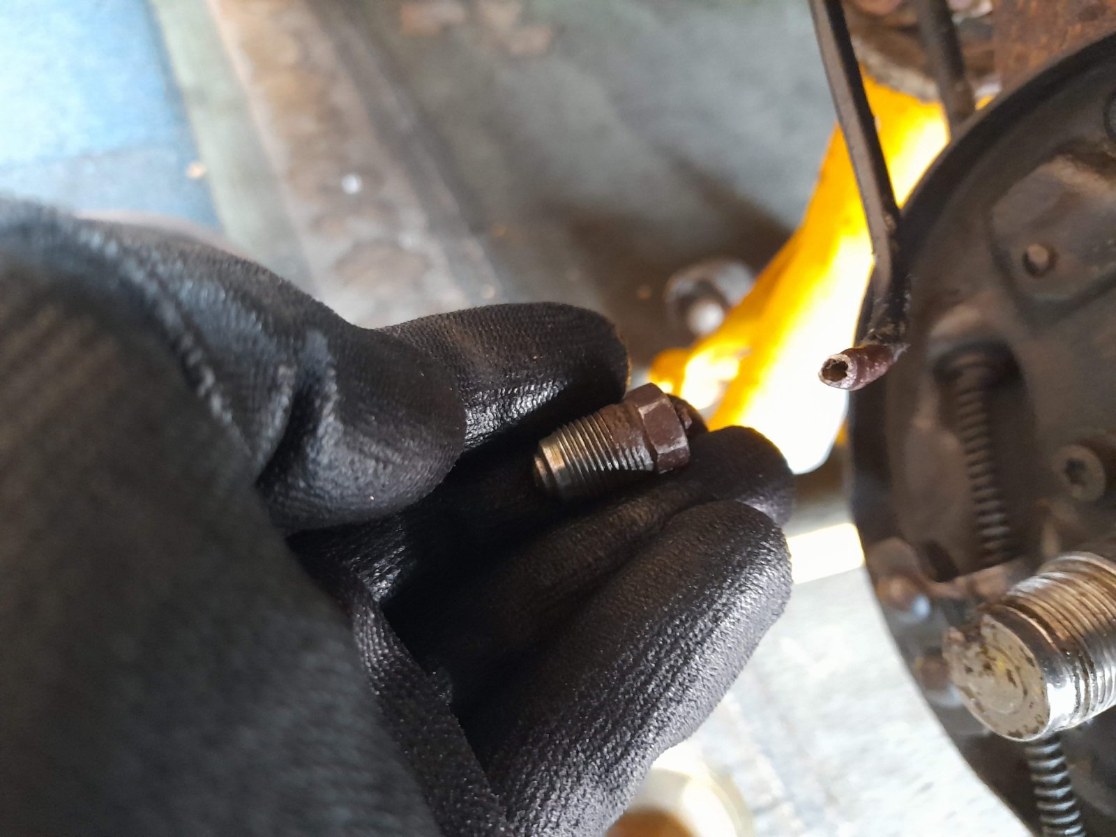

And then it all escalated a bit... The pipe union going into the cylinder was seized to the pipe. I knew this was the case from weeks back and hoped regular Plus Gas soakings would free it off...
Sadly not... This happened...

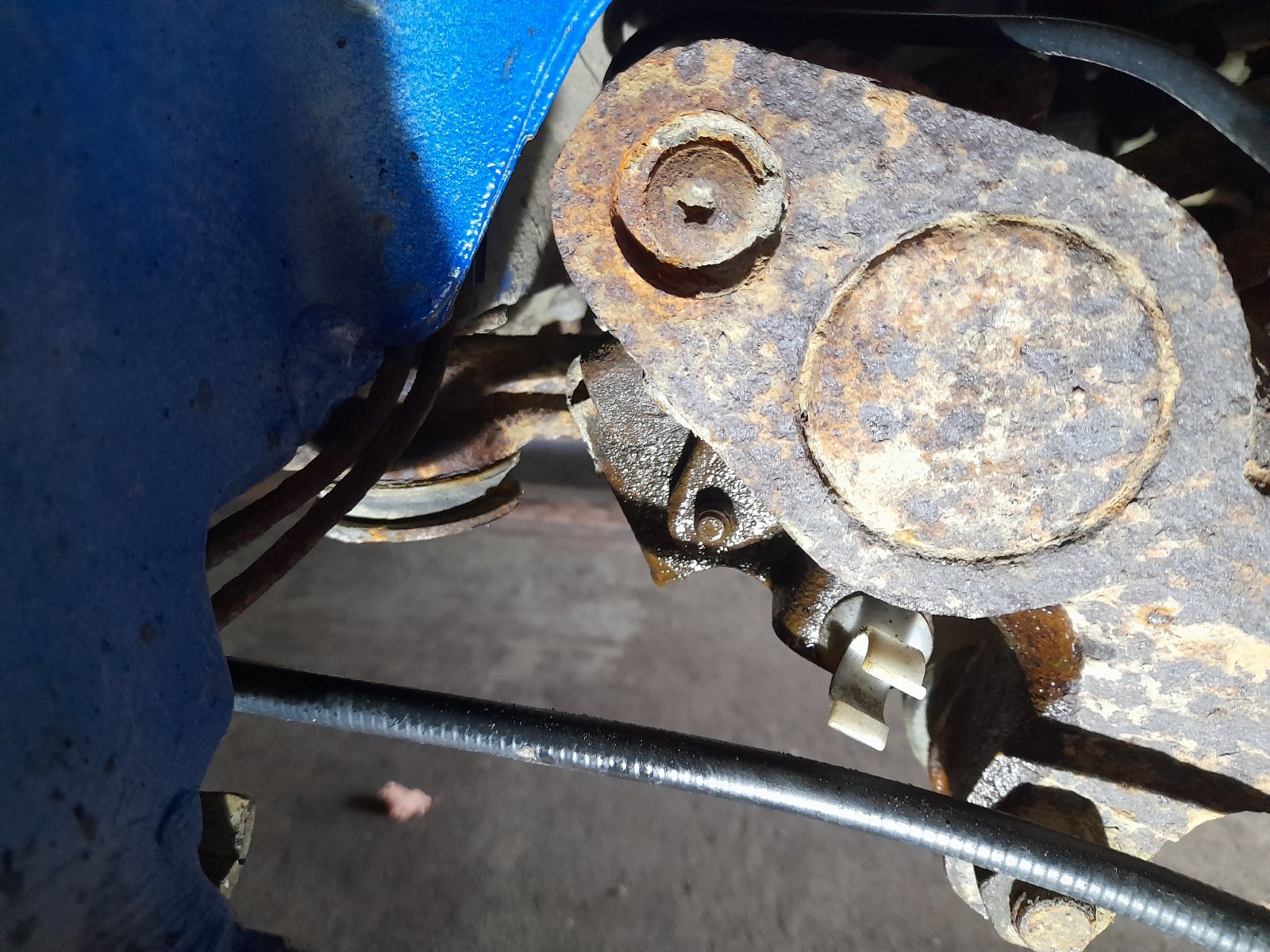

No great worries as I'll just make up a new pipe... The other end, where it meets the trailing arm flexi-hose looks inaccessible but by undoing one 10mm set-screw it'll all become accessible... Said set-screw is now soaking in Plus Gas and payers are being said...
It's not easy to see in this picture but the bit soaking is the thread end of said set-screw holding the flexi-hose bracket to the trailing arm...

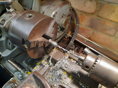

The wheel cylinder union is a special and not standard as found in pipe flaring kits so I needed to rescue it...
No way was the remains of the pipe going to come free easily, even a punch would not get it moving so it was a case of drilling it out on the lathe!
That did the job :D Often I wonder what I'd do without my lathe... It's so valuable... Not used every day but by gosh, when needed it's a lifesaver...

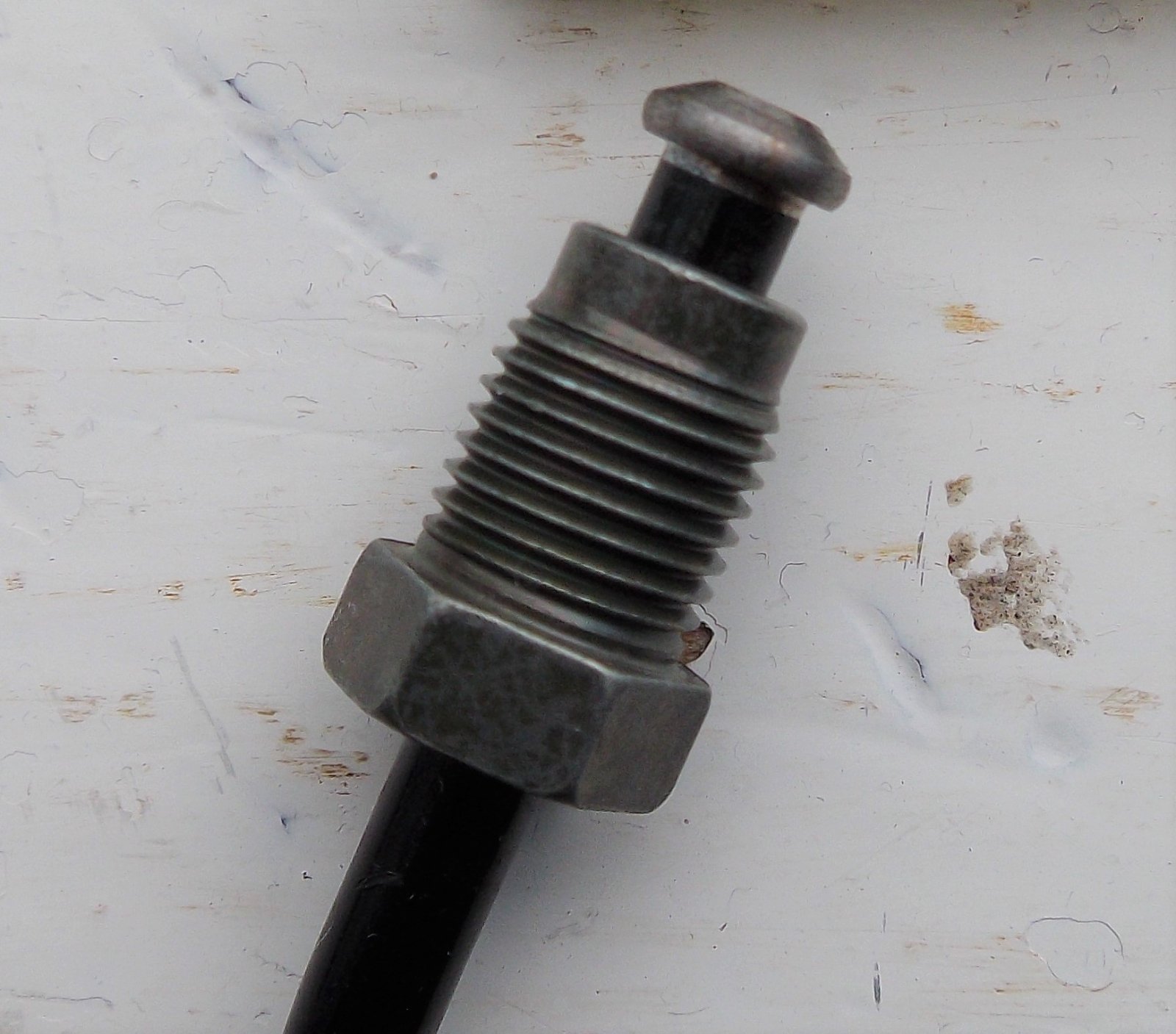

Hopefully I've struck lucky today... After yesterdays setback I found I could tease a bit of spare length out of the pipe, trim the end and form a new flare.
The old union was incredibly tight on the pipe and it was no wonder I failed to free it yesterday. I had to clean the bore out with a drill... Amazing how much rusty stuff it drilled out!
Hopefully it'll be successful and prima-facie I see no reason why not... I ran out of time to test it today and now the earliest I'll be able to will be Monday...

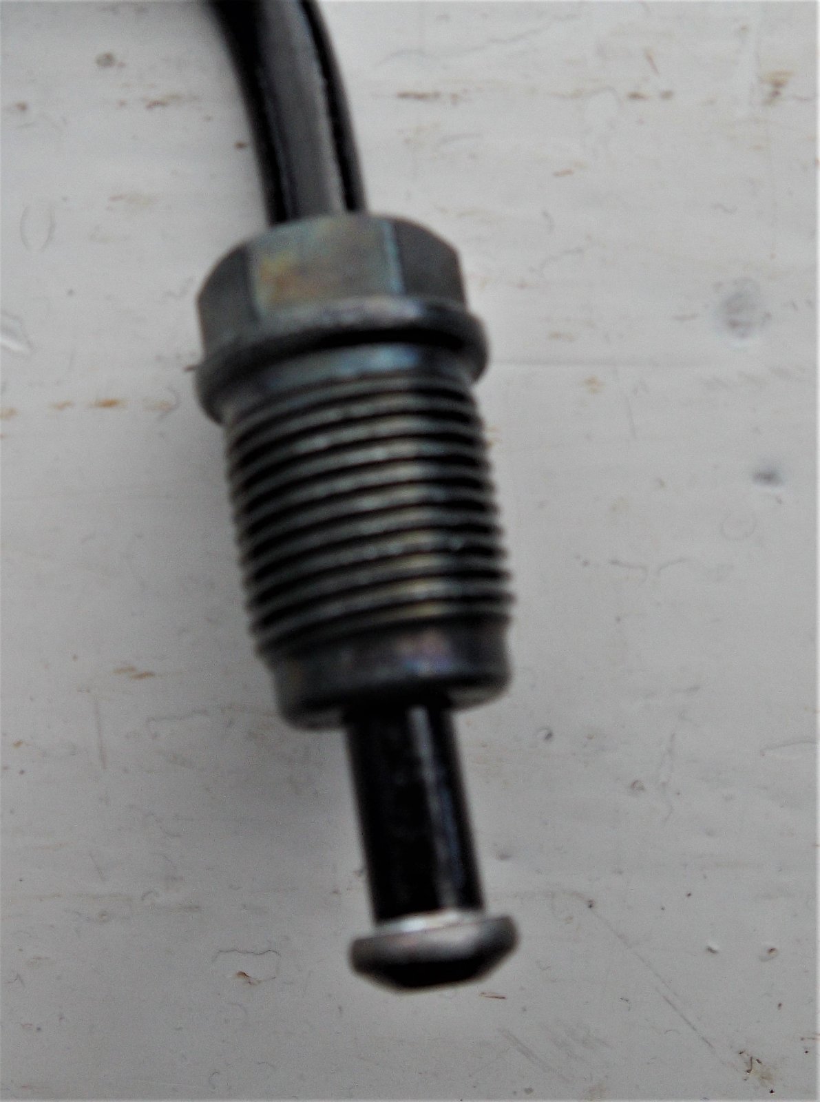

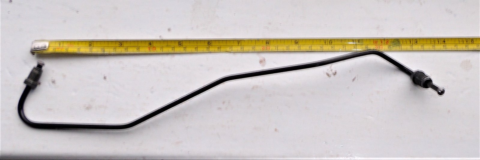

Looking at your brake pipe Jim reminded me of this, it's on my shelf in a genuine Citroen parts bag but the part number has been rubbed off.
I've wondered for a long time what it might fit.

Gibbo2286 wrote: 23 Oct 2022, 10:47 I've wondered for a long time what it might fit.
If that's not an AX/Saxo/Pug 106 rear flexi to cylinder brake pipe I'll eat my woolly beanie Eric!
I'd be more than happy have it in return for some appropriate remuneration of your choice ;)

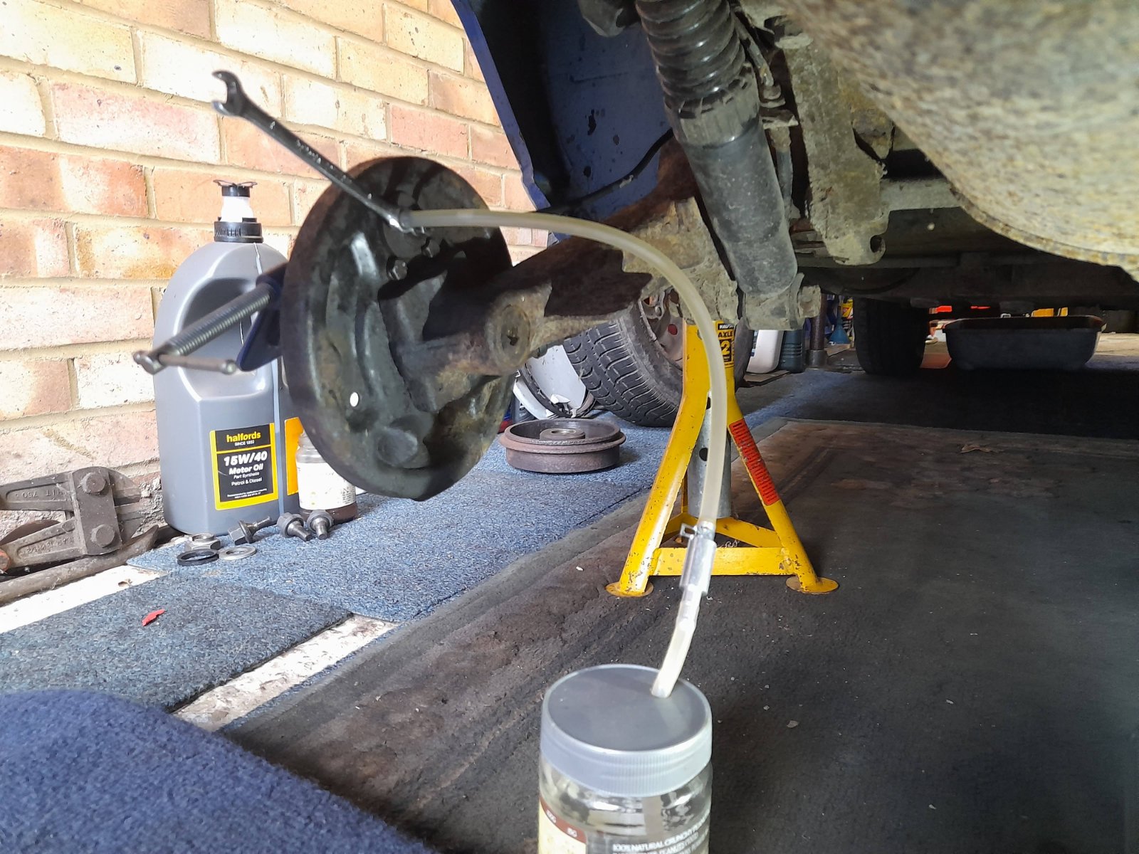

Once home and sorted out, despite being just a little tired I was keen to see if my brake pipe repair had worked...
Firstly, I stripped and cleaned the old weepy cylinder as I was keen to see how bad it was... It cleaned up reasonably well so used it just to see if it was now fluid-tight and to test the pipe seal...
After bleeding using my one-person bleed kit...

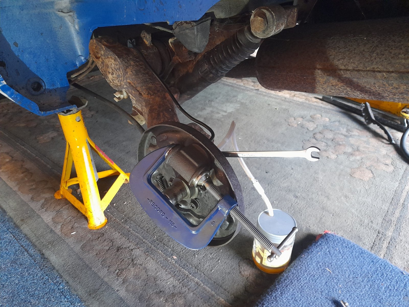

And success, both as dry as we all wished Dunstable Downs was earlier today :D
To stop the cylinder pistons popping out during testing with no shoes or drum in place, I cunningly used a G Cramp...
Tomorrow I'll reassemble with the new cylinder and the revived shoes...

CitroJim wrote: 23 Oct 2022, 16:02 To stop the cylinder pistons popping out during testing with no shoes or drum in place, I cunningly used a G Cramp...
I bet that hurt, Jim!
It made their pips squeak James :lol:
