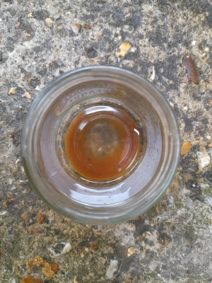

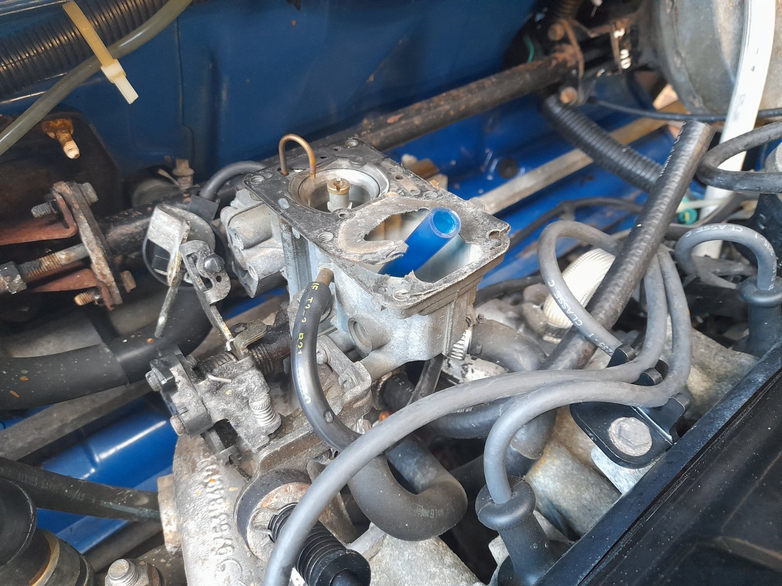

I gave Bluebell's carb a good clean today and found quite a lot of sediment in the bottom of the float chamber.
After a good clean and blow-out of all the jets and passages I reassembled...
To replace one of the jets I needed to make a special tool from some plastic tube!
Bluebell now runs beautifully :D I'm sure the TU engine runs sweeter on carbs than ever it does on the monopoint injection fitted to Sally and the S2 AXs...

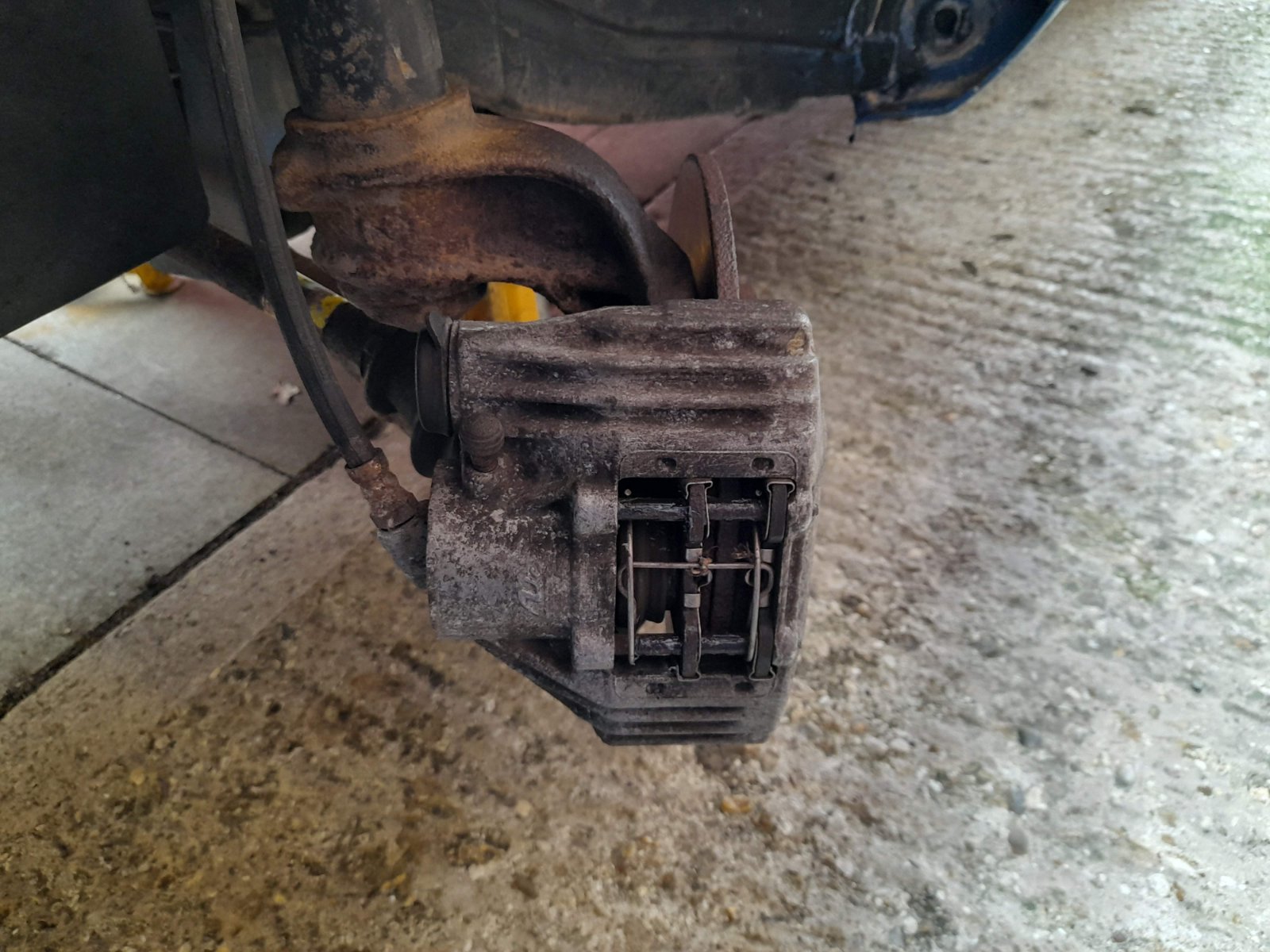

CitroJim wrote: 13 Oct 2022, 15:40 Nearside front caliper now nicely unseized and sliding freely...
Now to do a bit of work on the carb and see if I can get the engine running sweetly ahead of the arrival of the overhaul kit...

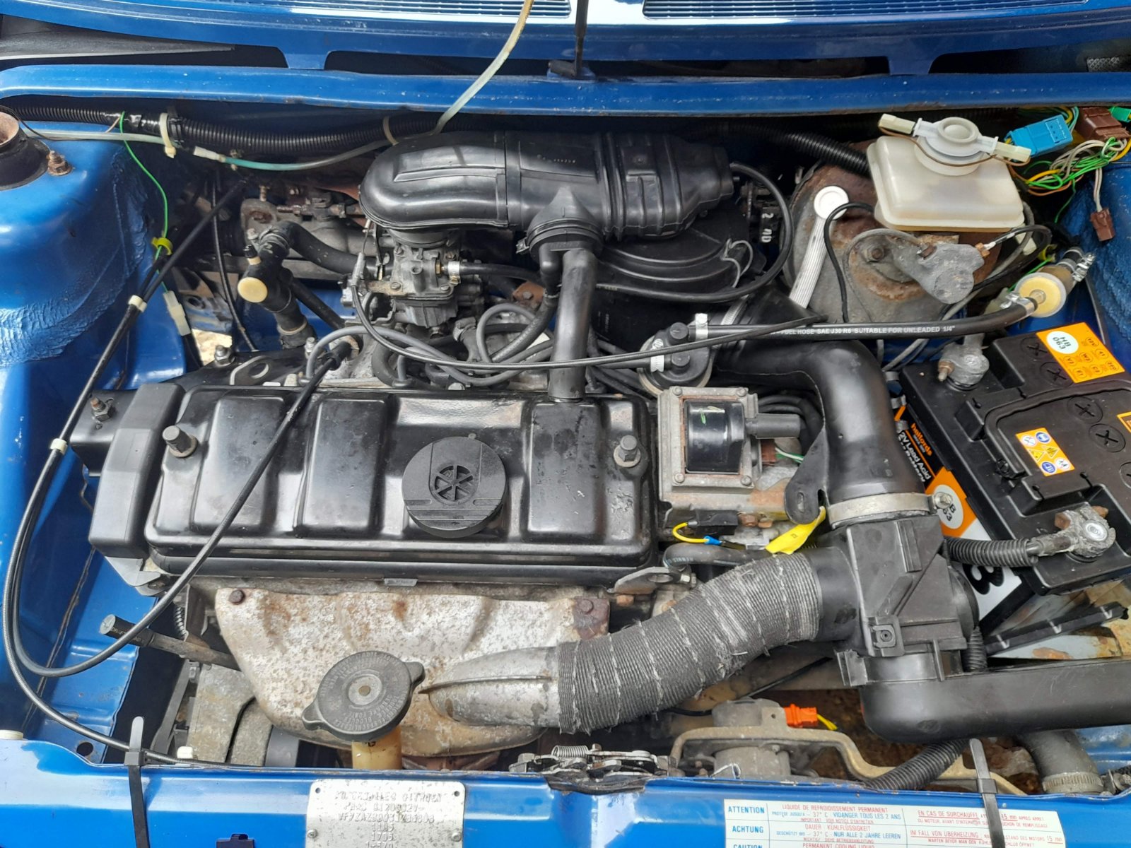

All under the bonnet is now fully reassembled :-D
This morning I've run the engine up to full temperature and bled the cooling system... In the process I was delighted to find the cooling fan works...
Quite a discovery knowing the thermoswitch is not the most reliable of components... But then again, on the AX it's only single speed so all simpler...

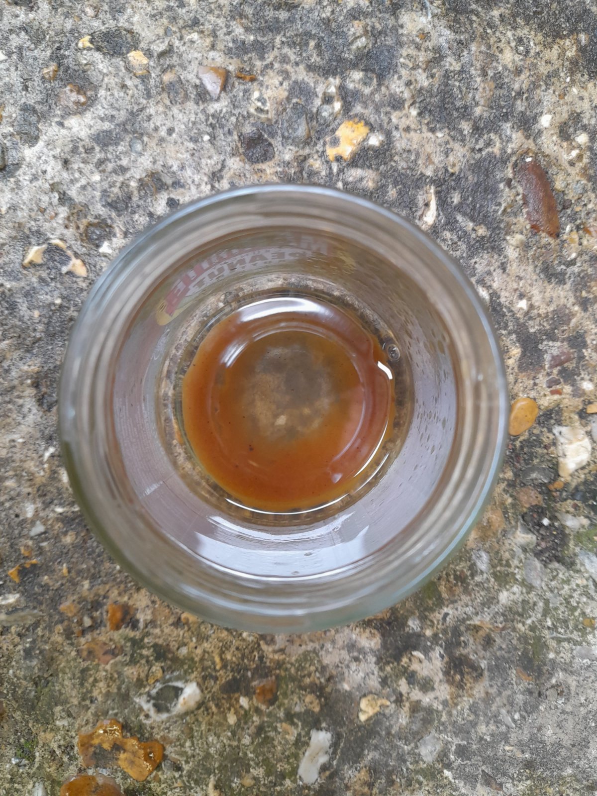

I have a couple of new fuel filters on order... I feel I'm going to be changing them fairy frequently for a while as during the initial runs yesterday and today quite a lot of rubbish was sucked up into the filter from the tank - as seen in when draining the filter...
At all times the petrol leaving the filter was nice and clean and now, after a good run I see the fuel flowing into the filter is looking clean...
It's won't be rust in the tank as it's plastic... Most likely rust from around the filler cap bayonet which was quite rusty... In cleaning it up it's very likely a bit of the rusty dust from it fell into the tank...

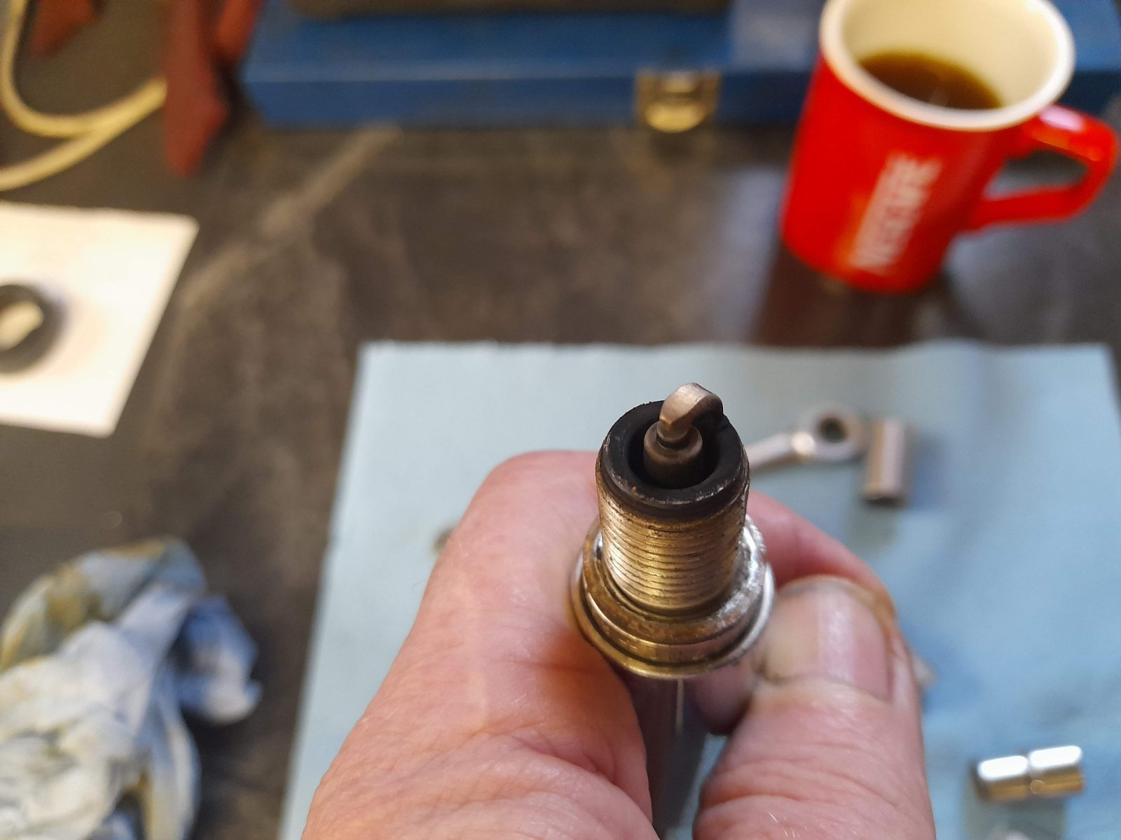

I did a plug reading as when I initially had her running at Alasdair's she was running very rich and really sooting up her plugs...
Things now look a lot happier :)

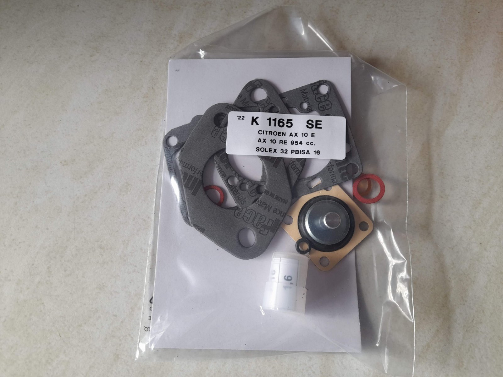

When I got home I was delighted to see Classic Carbs had delivered... Two days! Awesome service, especially as our Posties were on strike yesterday...
That it's for an AX10 is irrelevant as both the 10 and 11 use the same basic carb. Only the jetting is different and the 10 does not have the vacuum-assisted choke...

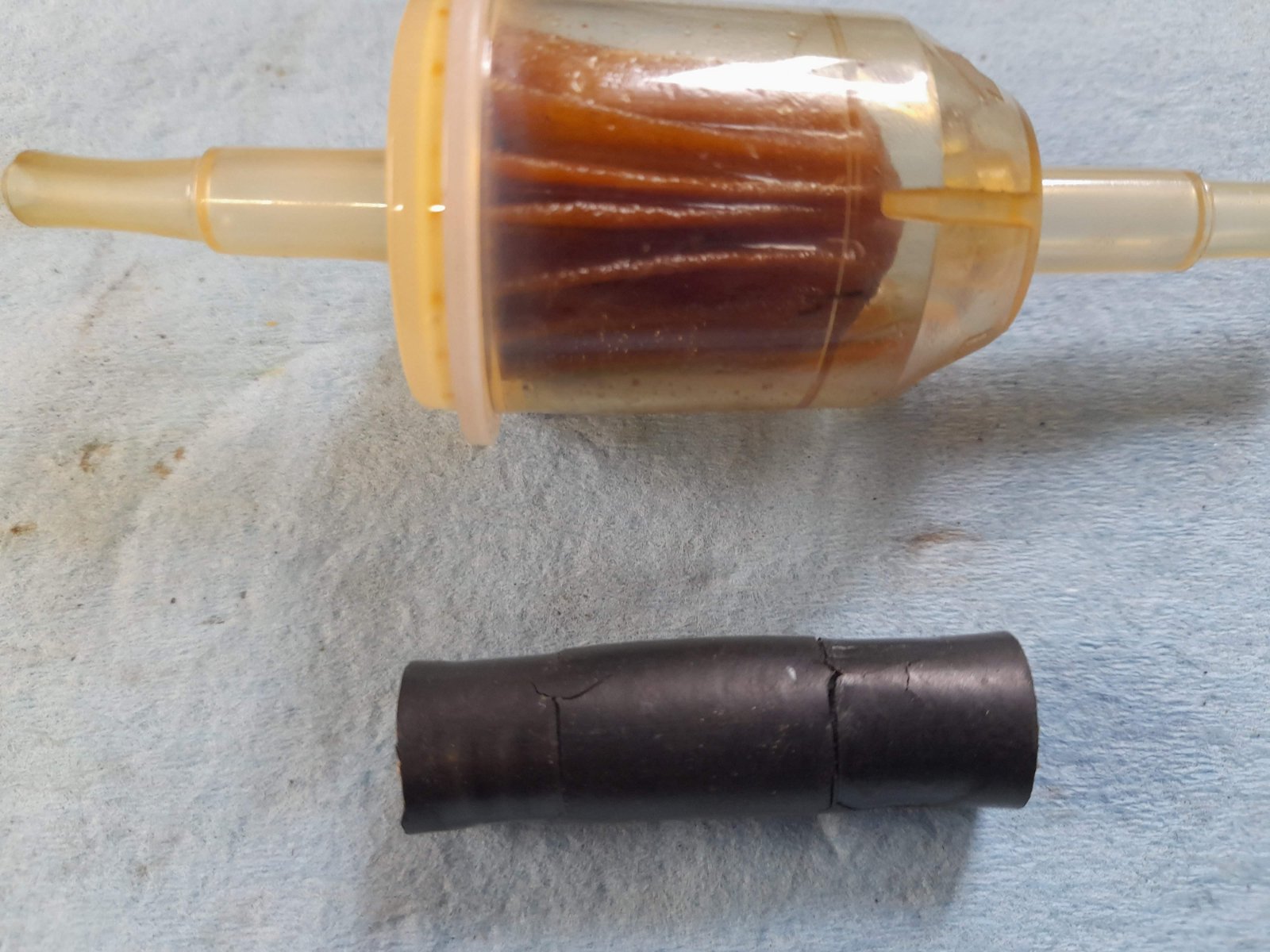

One little job I did do today was replace the old fuel filter. I was pleased I did as I found the fuel lines between the pump inlet and the filter and onward to the head of the tank pipe were both a loose fit on the unions and showing signs of cracking and deterioration... The poor fits may have been allowing air to be drawn in. These fuel lines have now been replaced with new pipe and the fit is nicely snug on the unions... I'm happy to see there's no run-back to the tank when the engine is not running...
The new filter is clearly flowing a greater volume of fuel and the fuel on both side of is now looking nice and clean...

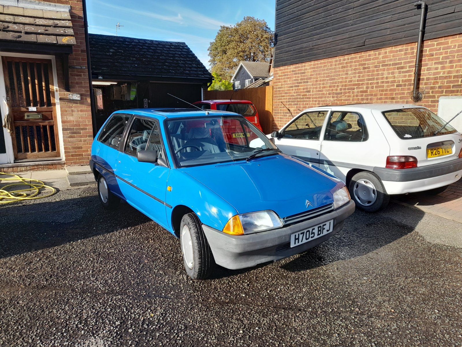

Last job today was to give all the cars, including Sian's Pixo, a good clean, both inside and out :D Here's the two Citroens enjoying the sunshine during their baths :D
They all scrub up remarkably well...

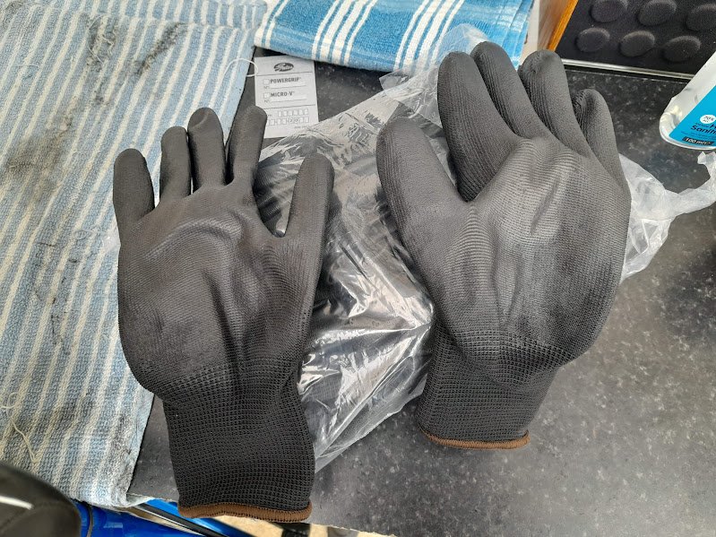

Serious spannering is now on hold for a while due to a nasty infection under one of my fingernails... Most likely from mucky old bits of AX getting under there and doing a bit of mischief 😡 Surprisingly painful too...
That'll teach me to play around with old French cars without taking adequate precautions 🤣
Now on a course of strong antibiotics and getting a tetanus jab this afternoon...
Proper mechanics gloves now procured.. No more going in bareback for me 😉🤣

Due to a nasty infection under a fingernail - likely as a result of unprotected spannering on an old Pug 106 scrapyard parts donor - I'm currently out of action... Unbelievably painful :evil:
I'm on antibiotics to treat it and they're working although causing some unwelcome side-effects :twisted:
I also received a tetanus jab - just in case...
From now on I'll be wearing mechanic's gloves when working on cars and have just received a good stock of them...

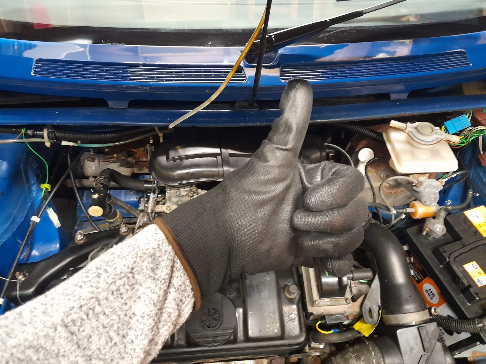

Wearing my full protection :-D
And all set for a good spannering session today :)
