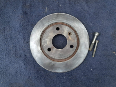

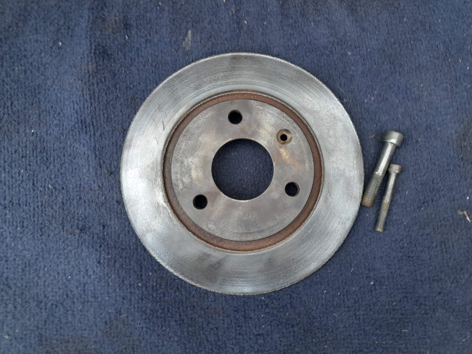

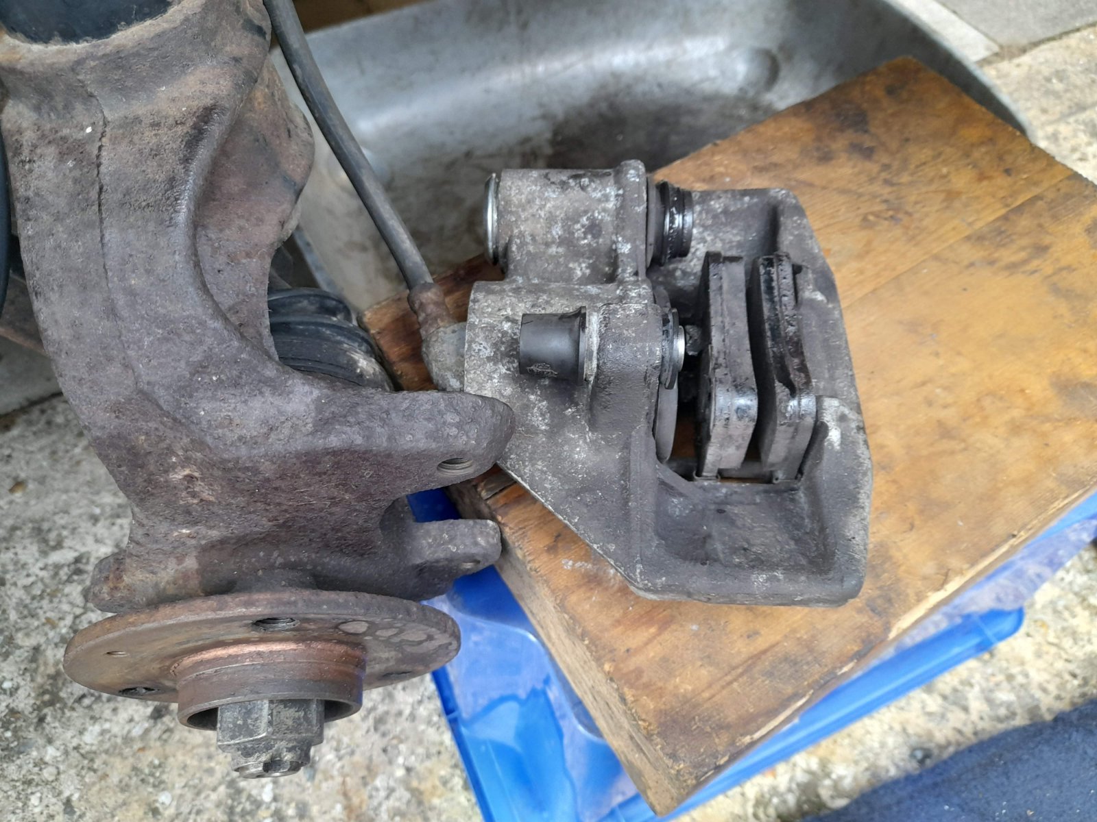

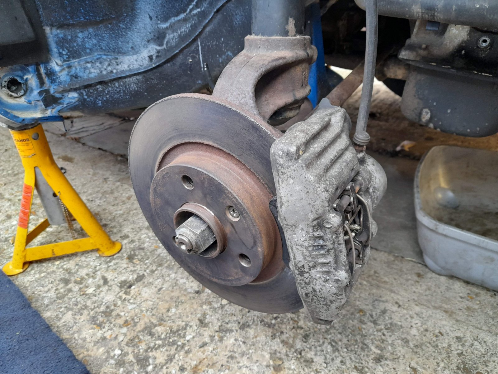

After that I got well stuck into Bluebell's seized front calipers and had a good measure of success at freeing off the seized sliders and re-lubricating them with the proper stuff...
The discs are almost unworn an came up well
The pads too are serviceable and both discs and pads will be good enough for the MoT which is the priority... Once the MoT is done and I can properly re-register the car and I will then send the calipers off for a full professional refurb as I can't move the pad retaining pins however hard I try and also, the bleed nipple - unsurprisingly - is stuck fast... She's worth it...

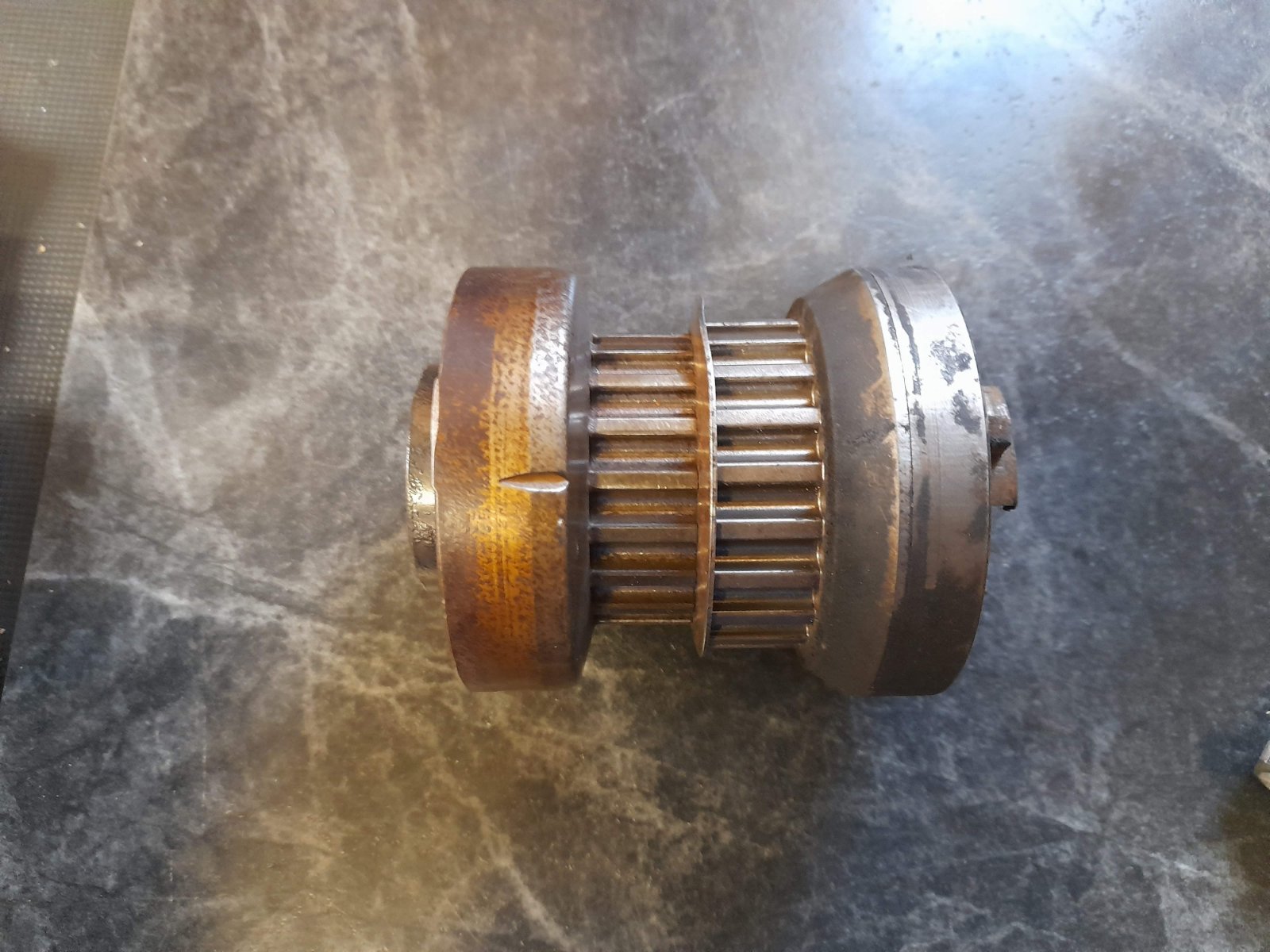

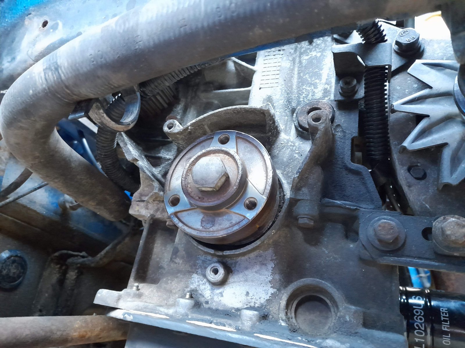

Flushed with the success there I then started to reinstall the cambelt and fit the modified hybrid crank spacer and drive sprocket...
It all looked good...
Until I tried to tension the cambelt!
Spot the difference...
The original early TU sprocket is on the right...
You couldn't make it up! Small detail differences between what are essentially the same engines which make them totally incompatible...
So back to square one... I will now redouble efforts to find a correct replacement flanged spacer but for now - and to get her through an MoT - I have a plan which does not involve experiments with early and late engine hybrids...
I'm keeping shtum for now but will reveal all if it succeeds...

It looks like I may have sourced a flanged spacer
I'm going to collect a complete 1.1 TU bottom end tomorrow that should yield my needs and be a generally useful source of spares...

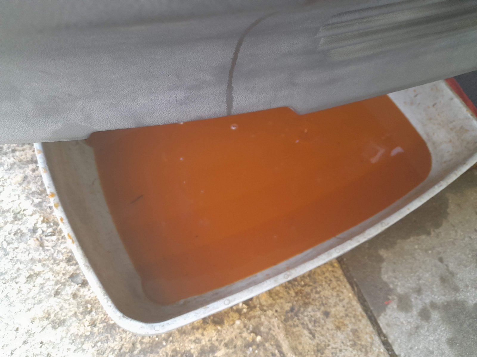

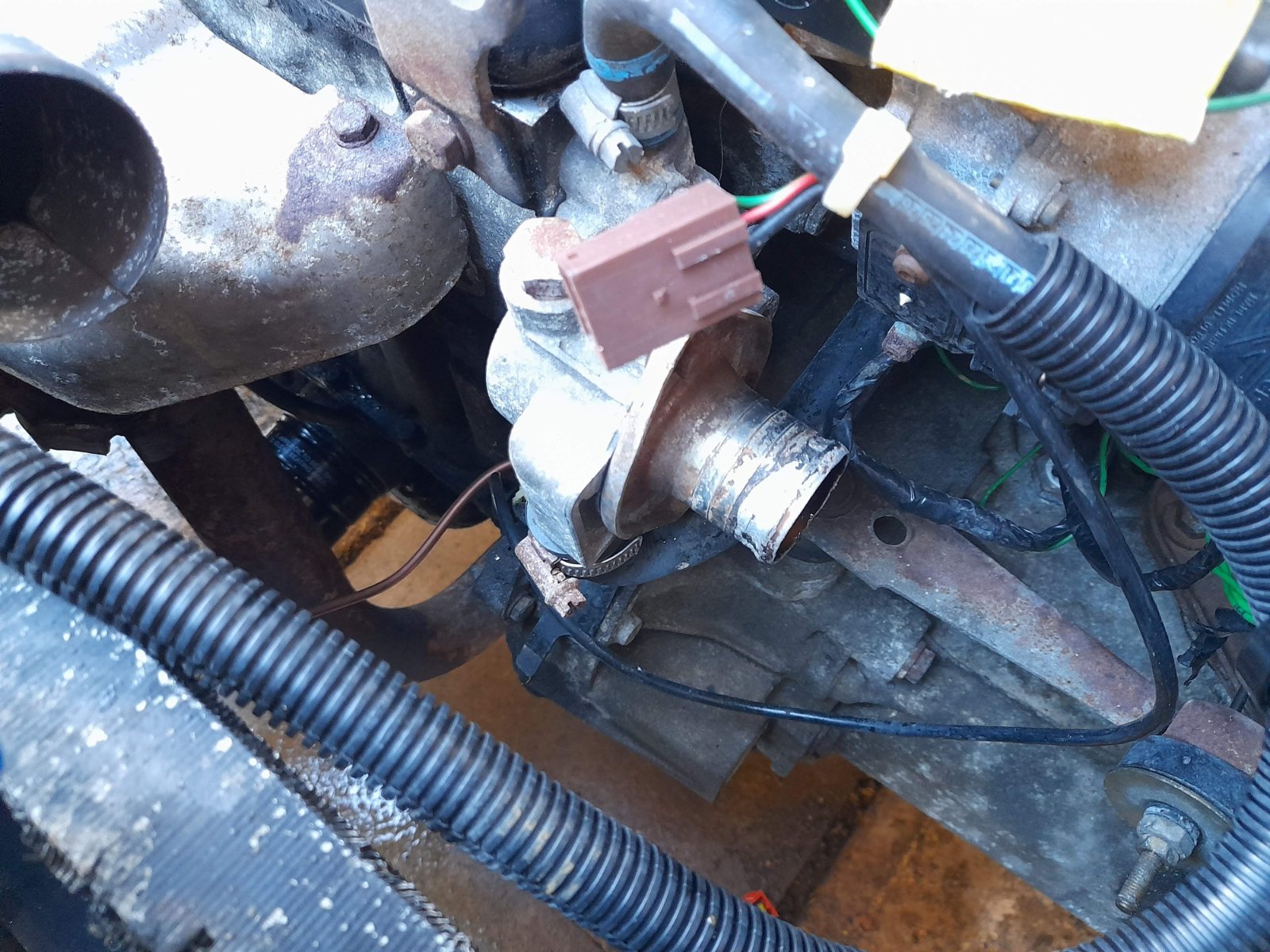

Meanwhile, I believe Bluebell's coolant was well overdue for a change
I've now given the whole cooling system a good flush and will be refilling with new coolant. I did think of using OAT but I'll use barley water instead I think
Seriously, it's an old engine so it'll have what it was designed for - ethylene glycol...
I'm amazed at how good the hoses and rad are... Fully serviceable and cleaned up a treat... The cooling system has never corroded as witnessed by how clean the top hose to thermostat housing spigot is... So often these are a veritable sea of corrosion after a few years of neglect...

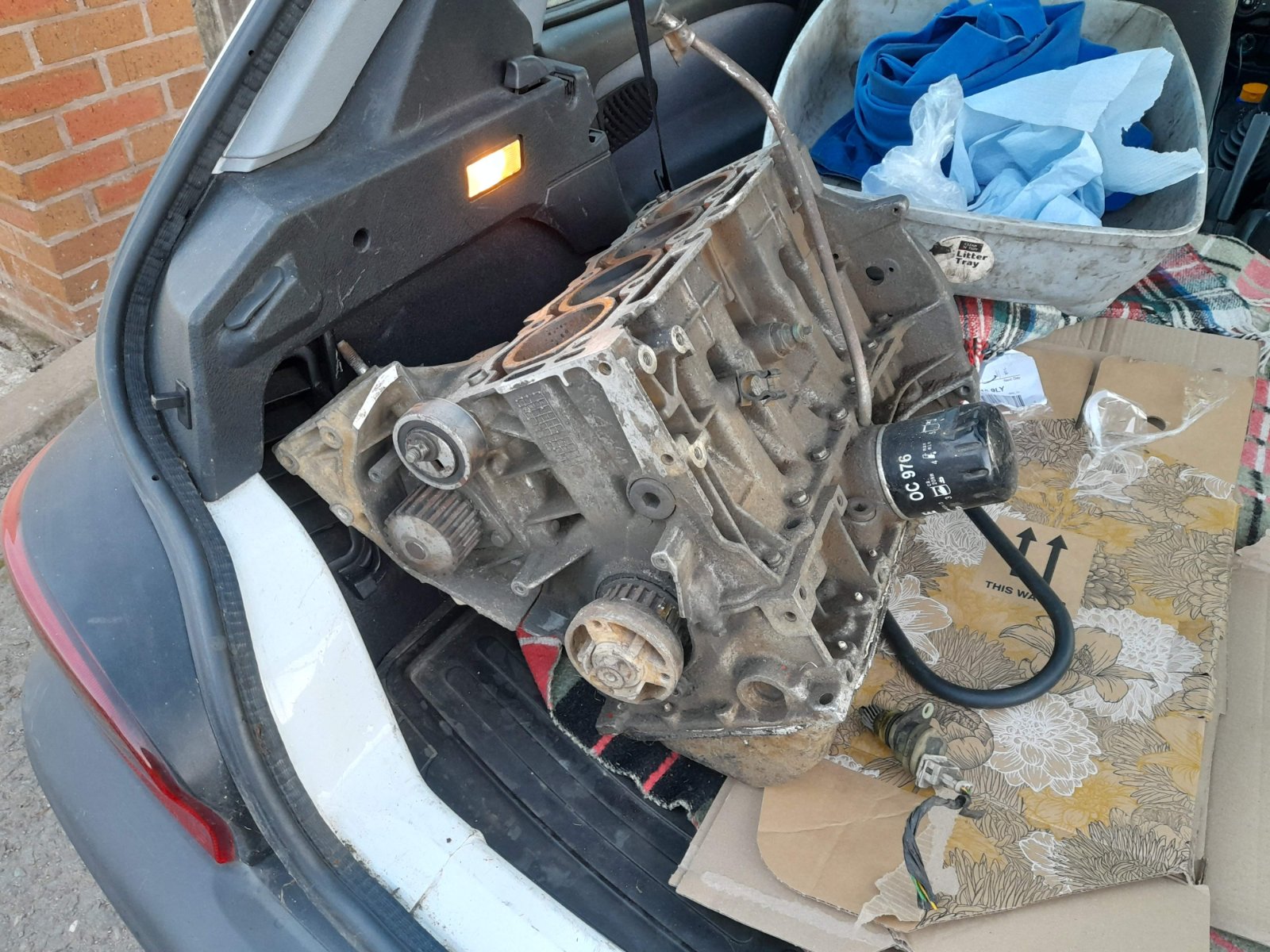

Yesterday I collected this...
Just for the flanged spacer... It came from a banger racer whose 14 year old daughter raced in the junior small car class and raced many a Pug 106 and latterly Nissan Micras!
She's now moved up a class and racing Astras...
It was a great evening out

Yep, that's the plan Mick
Firstly I have to bolt a bar across the top of the block to lock the engine so I can undo the crank centre bolt and recover the flange..
It's got no flywheel fitted so that's the only way to lock it up...
One advantage of a headless and flywheel-less TU engine is it is fairly light and easy to move around...
One thing I had to take care of bringing it home is that it still has a sumpful of oil!
