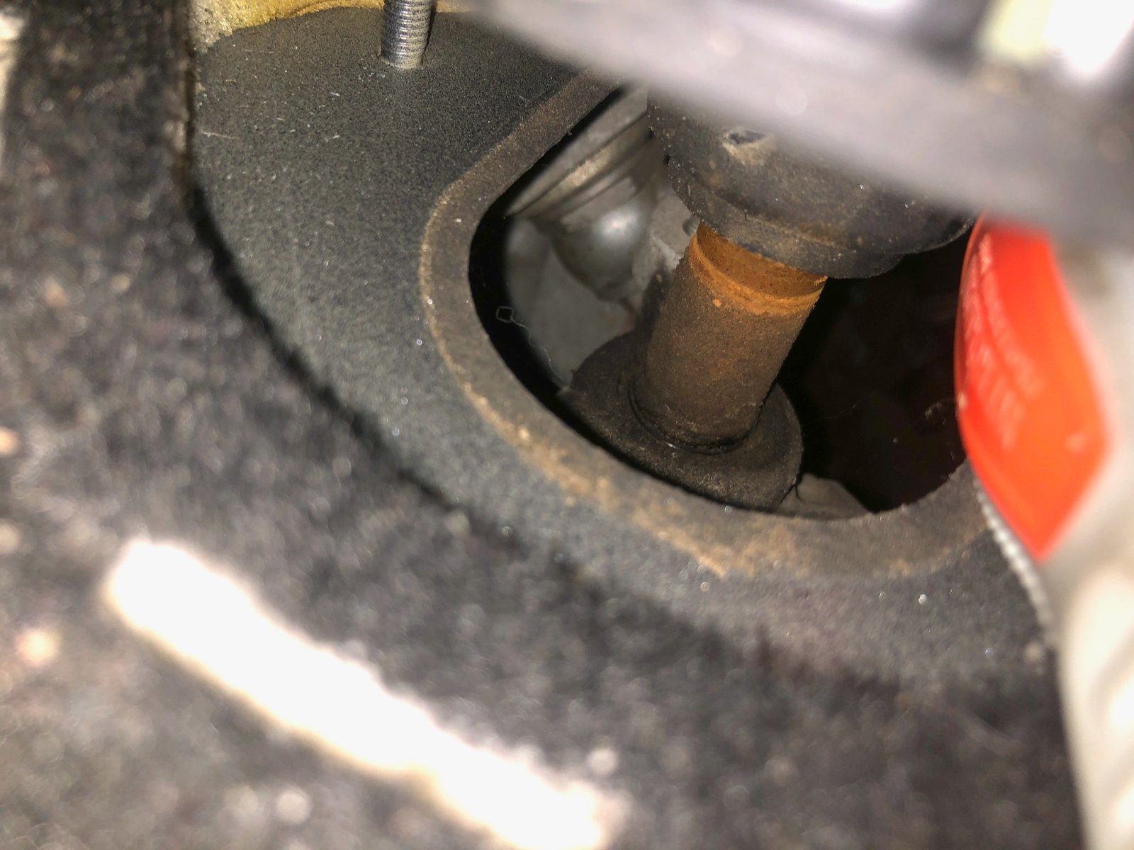

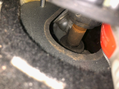

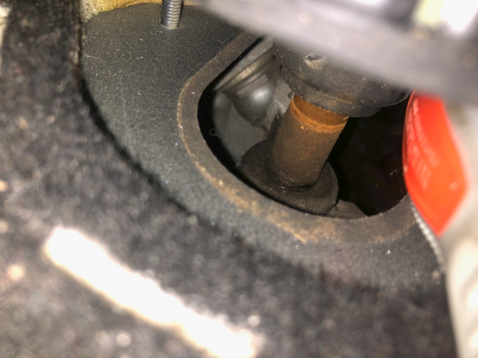

So after reading the horror stories in this thread I was dreading checking mine this morning. I had reached out to others on the french FB groups and the consensus is that although it does happen on LHD cars, it's quite rare. The thoughts are that the airflow around the area are better on the LHD cars and with the engine running, as I removed the cover in the footwell, there was a huge blast of air that came through from the engine bay, supporting this argument. Anyway, as you can see from the photo, although there is some rust present, it's no-where near what I have seen on this thread. It now has a copious coating of marine grease to prevent anything further.
This is a 2009 car with 166,000 miles equivalent (but also French so no salt to contend with).

The French do spread salt. Many a time I've been over the Massif Centrale or the RN7 and seen the signs "Salida" (or something like that).

That looks like it is starting to go alright I had a similar issue with LDS leaking through the boots but I replaced them and it seems to be holding I also fitted a silicone rack boot over the pinion. The CV boot is too big and just won't work. I think the problem with reconditioned racks is just that. They need to be remanufactured along with the pipe work but unlikely to happen now given the age of the cars. I think owner ingenuity and perseverance is all that will allow our cars to stay on the road.apart from when they are being worked on which they really like.

Yes, you are correct - I didn't realise that as my region doesn't get really cold temps or snow so we don't see it - but I did discover that it is used in some depts. ThanksPaul-R wrote: 19 Jun 2024, 12:56 The French do spread salt. Many a time I've been over the Massif Centrale or the RN7 and seen the signs "Salida" (or something like that).

Yes, I was so glad that I took the time to read this thread and to investigate. I think it would have lasted another year or so but without treatment is was a case of when and not if. Hopefully its coating of marine grease will slow it down a bit. It just seemed to be happening at an older age/more miles than some of the RHD vehicles. Also the pipework shows no signs of corrosion.
