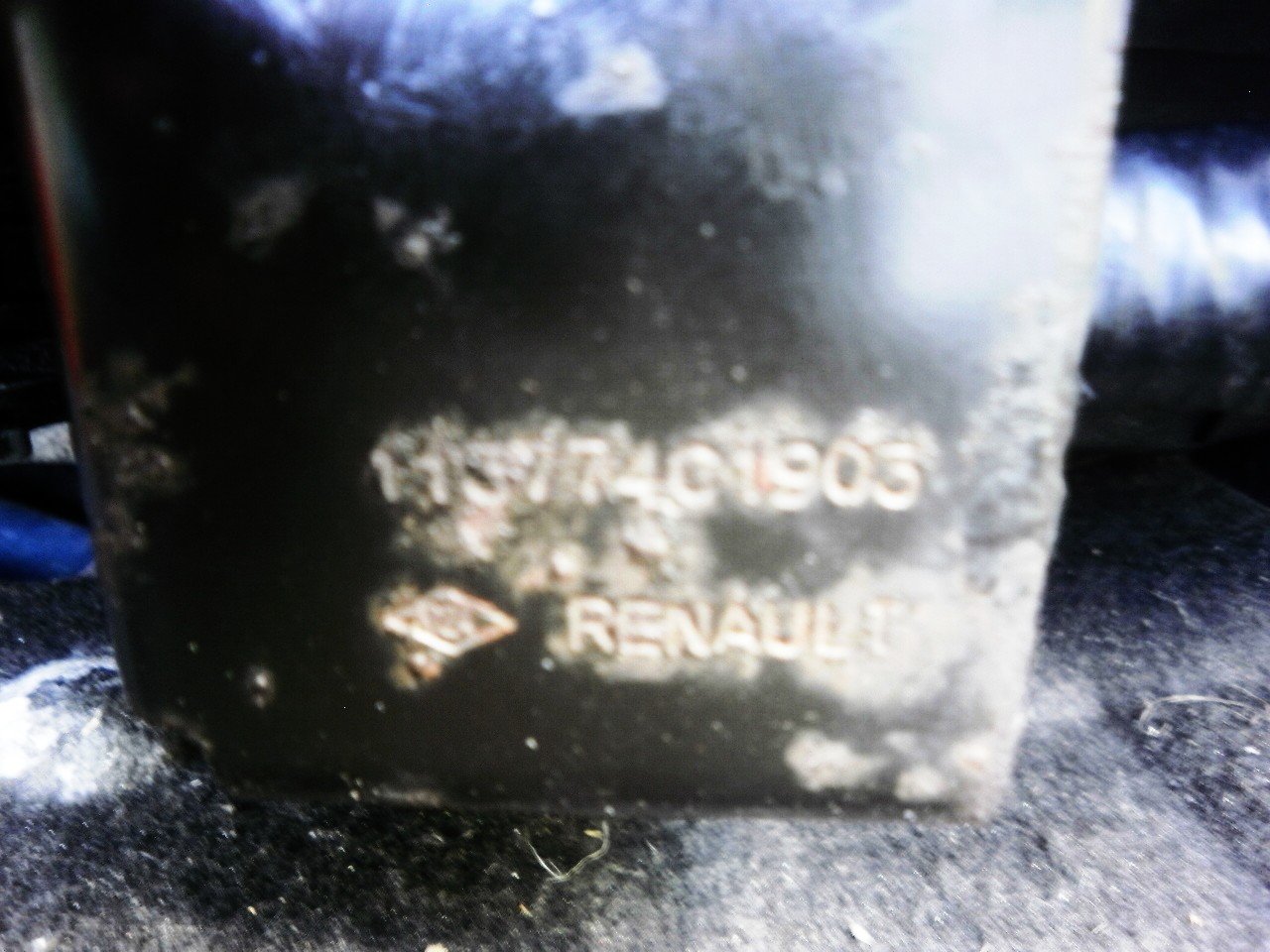

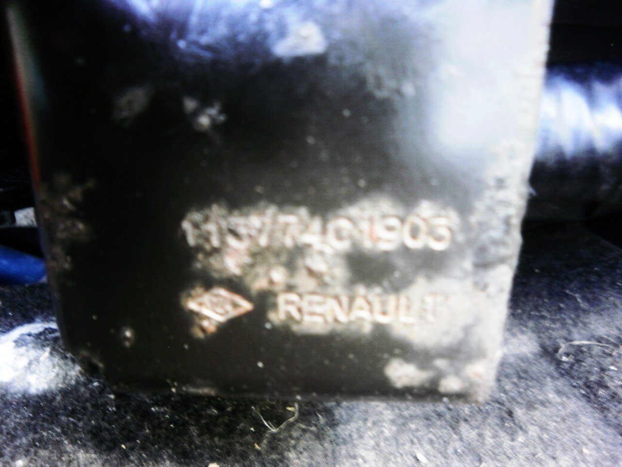

The Clio likes a bit of plastic. This is hidden behind the front right wheelarch liner and I think its number 6 in the diagram even though it is placed at the rear in the diagram and its actually at the front of the car.! Don't think that or its pipework is the cause of the hesitation power loss stutter then instant-ish is recovery to full power experienced from time to time.
The 23 year old injectors clearly work fine when the temporary blip in power/hesitation/stuttering is overcome, and the engine has as much poke as the day it came out of the factory, absolutely nothing to complain about on the power front when the stuttering is overcome!
I think we need this thread to come to a positive conclusion, yes for my own selfish reasons and a niggle which to be honest doesn;t actually require to be resolved but for a desire not to leave an unsatisfactory puzzle not solved! So many threads on the Renault forums and in many other forums on the subject of these intermittent but regular hesitations. stutters blips, flat spots and misfires turn into unresolved sagas! We need a success!

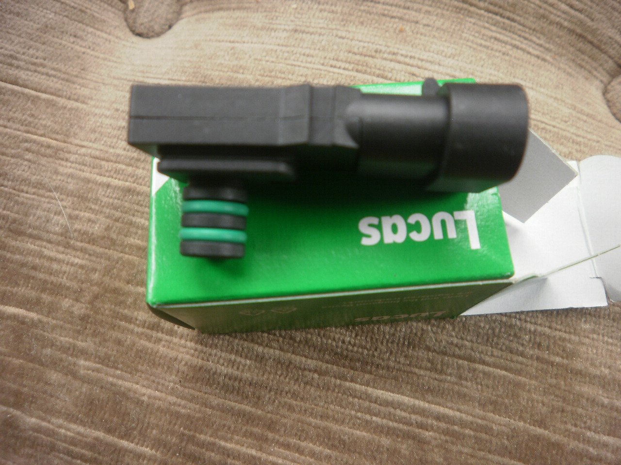

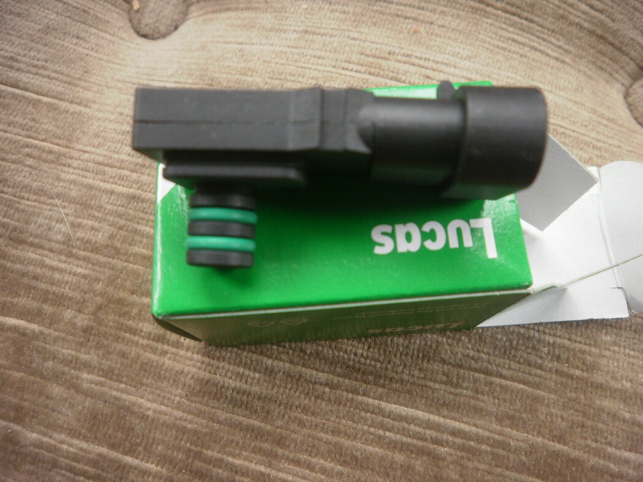

MattBLancs wrote: 13 Mar 2026, 12:20 Neil, has your new MAP sensor been installed as yet?
There is a little bit of jeopardy with the MAP sensor, which may well have been in place for 23 years. It is easily broken and bits can fall off it on the removal process into the inlet manifold. Then there is the Schrodingers cat phenomenon, the replacement MAP may or may not reveal a living "cat".
While the two possibilities exist there can be a period of optimism that the replacement sensor could produce a living cat.
A reply of "eh?" would be understandable Matt and the short answer to your question is "No I haven't installed the new MAP yet! I will of course, but I will pick my moment. It may be after taking the plunge and removing the inlet manifold and seeing what is revealed, and has the advantage that any potential breakage of the old MAP could easily be retrieved.
I am not that convinced it's the whole problem, but may contribute to it. I think fuel delivery from pump to filter to rail to injectors is the leg of the system most likely to be responsible for the hesitation/stuttering than back to full power.
Plenty vids on injector testing and cleaning and refurb with new seals and their tiny little filters..inlet manifold needs removing to get access to them anyway.

Ahhhh, with you on the mention of Schrodinger's Cat now!
Yes good plan to take the inlet off (for cleaning) and gave the bonus of catching any MAP shrapnel in the event that goes awry! :)

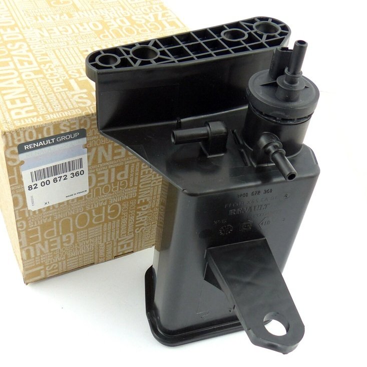

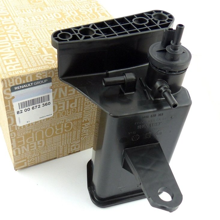

There's more to this cannister thing than meets the eye. I thought it was just a passive thing, various tubes from various places connecting into some sort of chamber but it incorporates a solenoid operated valve...which clicks...in the BB Clio's case even after switching off. Thought the clicking was something to do with the AC but no, it is this valve/cannister mounted behind the offside Headlight bahind the wheel arch liner.
The solenoid valve in a Renault Clio 2's canister controls the flow of fuel vapour, allowing it to be purified and preventing it from being released into the atmosphere. It operates by opening and closing to regulate the vapor entry into the carbon canister, which cleans the vapour before it's released.
and...according to internet wisdom, symptoms of a failing carbon canister in a fuel-injected engine include a noticeable fuel odour around the vehicle, a check engine light activation, poor engine performance, reduced fuel efficiency. Some ticks there as well as the actual ticking of that solenoid valve.

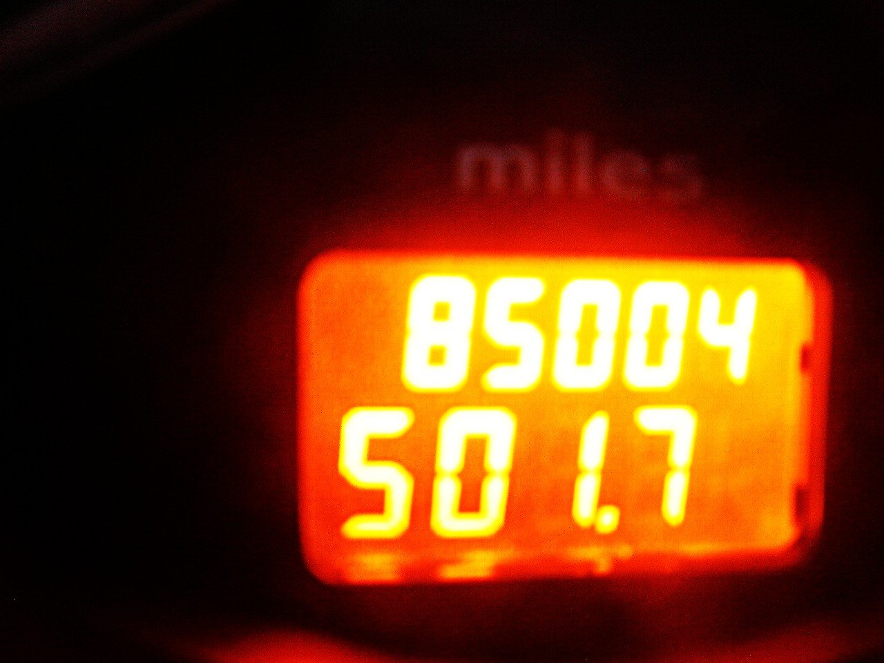

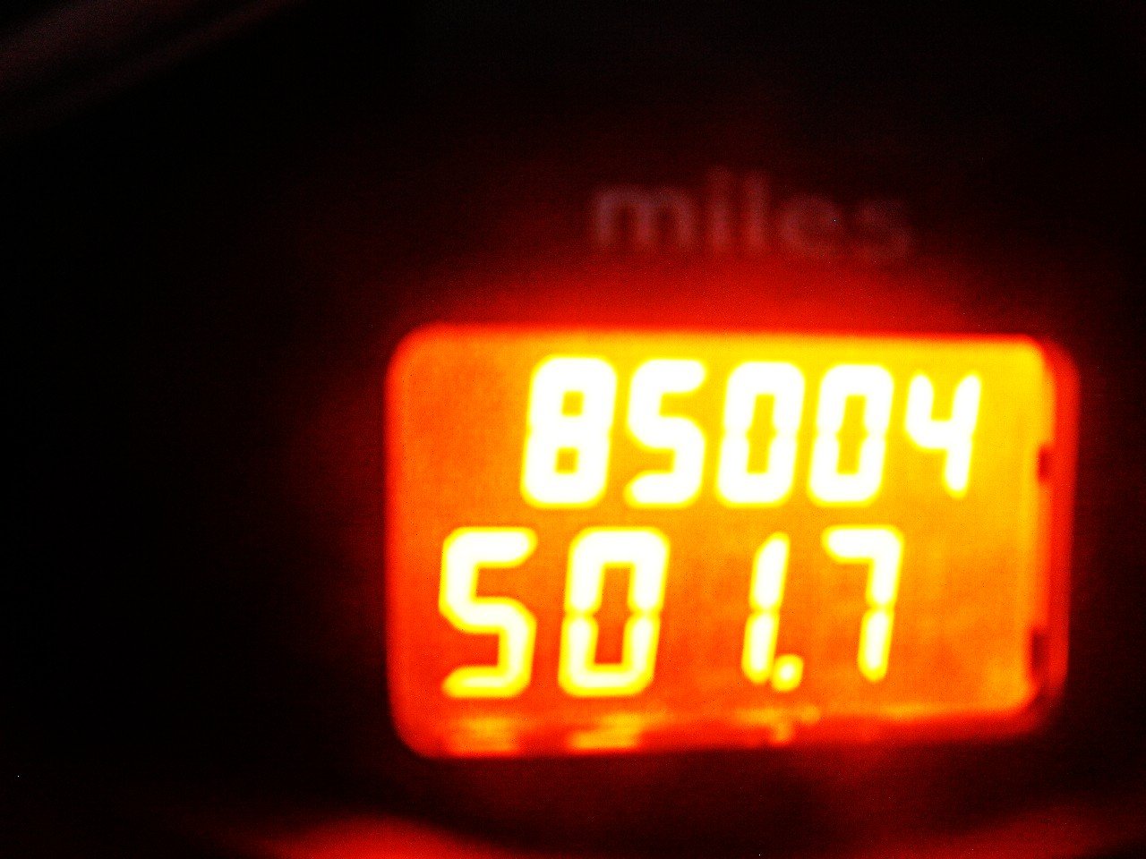

A little run has ticked the BB Clio's milometer past 85,000 miles.
No interventions by me as yet apart from one...
The return journey threw the stuttering up when under load up a hill, picked up but that little stutter did put on the P0130 code.
Cleared it when stopped at home, and when stopped ("ignition off") that EVAP valve solenoid was clicking away for a minute or so with everything switched off. Probably an aside but after 23 years of "purifying" the vapour emissions and discharging them, I imagine that the carbon canister is not what it was when the car exited the showroom in 2003. Probably an aside...
...anyway back to the Falcon intervention. I call it "The Laying on of Hands", in particular to the wiring loom going into this thing. A smoothly running but fluctuating revs idling was returned to a smoothly running idling by the laying on of hands to the wiring bundle as it entered the steel "security cage" which Renault deemed necessary to make it difficult to tamper with the ECU.
