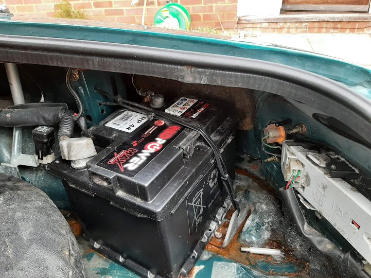

I've started work on the car and found the boot leak appears to be caused by a failed bootlid seal and this is allowing water to drip on top of the battery... Now proving this is indeed the case...

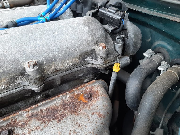

The oil leak is from the exhaust cambox lid and appears to have reduced since I I rook it for a good warming drive... I can see the cambox cover has been off at some point in the past judging by the excess instant gasket around it...

Parts supplies are pretty damned good for them - no shortage of new and second hand supplies for just about everything. Try https://www.mx5parts.co.uk and http://www.mx5city.com/ for new bits, but there's plenty other suppliers out there. Ebay for second hand stuff - you'll be spoilt for choice.

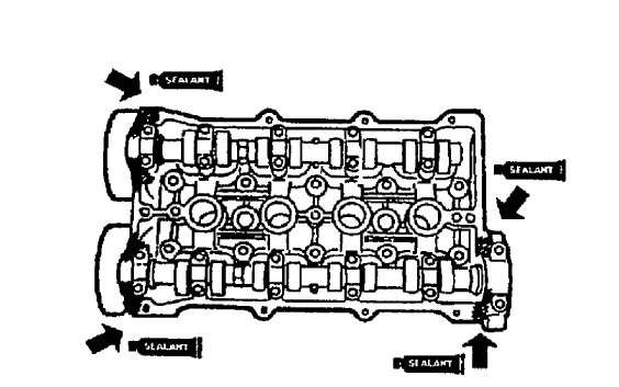

Cambox cover gaskets are known to leak - they resemble black spaghetti so no wonder
Only use genuine or very good quality cambox gaskets. I think I have a spare Reinz one somewhere if you want one, but I'd have to go exploring to find it
IIRC, there's supposed to be a couple of splodges of gasket sealant in very specific areas, but the rest is 'dry' fit.

Thanks Bobinsbobins wrote: 05 Mar 2021, 07:03 Cambox cover gaskets are known to leak - they resemble black spaghetti so no wonderOnly use genuine or very good quality cambox gaskets. I think I have a spare Reinz one somewhere if you want one, but I'd have to go exploring to find it

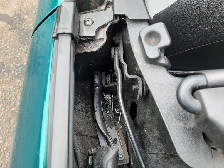

Had a good session on the MX-5 today... Really enjoyed myself... It's good to work on something a bit different
This is where the cambox appears to be weeping:
And this is where the bootlid appears to be leaking... You can see a little 'bump/swelling' on the skirt of the seal and under here it is split and rusty... It's right above the battery..
I've now put a little plastic dish just below it and resting on the battery in order to prove this is the case...

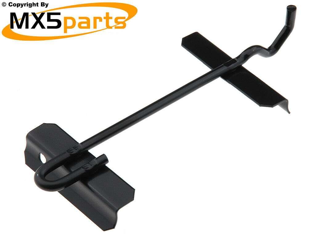

The amount of rust around the battery shows it's been leaking for a while.... Removing the battery is not easy as it's held in with a collection of large cable-ties... The original clamp has disappeared.
A picture or diagram of the proper battery clamp would be appreciated...
I gave the interior a jolly good clean and took up the footwell mats which seemed to be the worst offenders for the musty smells although quite a lot of mould was found on many surfaces... A warm weak bleach and water mix shifted all the mould a treat..
There's no puddles in the car and there's no areas of wet damp so I'm wondering if the damp is just normal soft-top condensation as a result of not being used over winter... I'm on new territory here...
With the roof down I checked the drains and both are fine
I left the roof down all day to air out the interior and will do the same on every nice fine day from now on... I'll also leave out the footwell mats as they do seem to act as 'sponges' for any moisture...

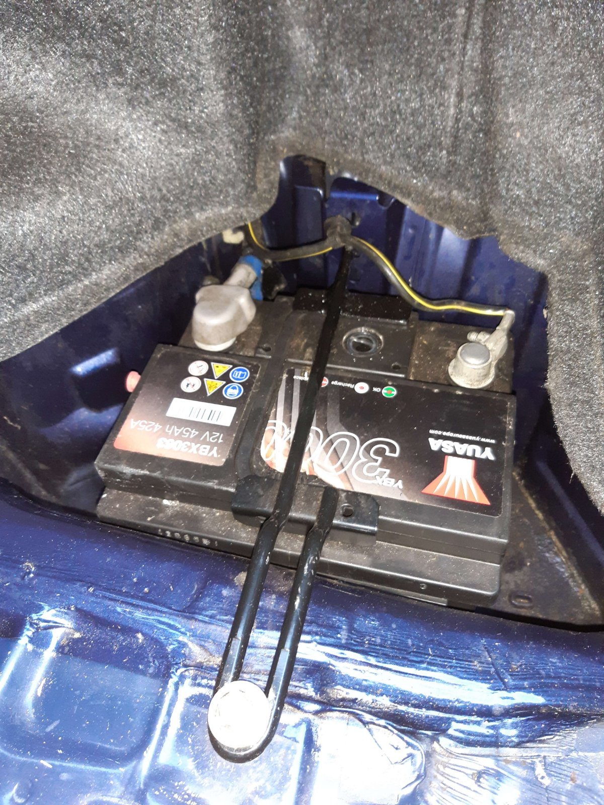

- Posts: 6847
- x 3566
Re: Citrojim's AX, Saxo, Pixo, Running and Cycling Tales

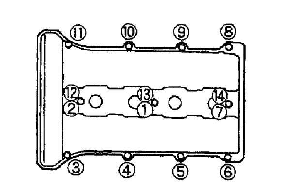

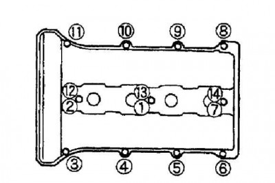

Sorry for the dodgy picture, but you can vaguely see where the 6 splodges of sealant is supposed to go in this diagramCitroJim wrote: 05 Mar 2021, 16:59Thanks Bobinsbobins wrote: 05 Mar 2021, 07:03 Cambox cover gaskets are known to leak - they resemble black spaghetti so no wonderOnly use genuine or very good quality cambox gaskets. I think I have a spare Reinz one somewhere if you want one, but I'd have to go exploring to find it
IIRC, there's supposed to be a couple of splodges of gasket sealant in very specific areas, but the rest is 'dry' fit.That's really appreciated!
Tightening sequence - tighten them to 6lb ft. Yeah, right !
Here's my battery clamped in, but mine is a Mk2.5 so your clamping arrangement basically needs to turn 90°.The amount of rust around the battery shows it's been leaking for a while.... Removing the battery is not easy as it's held in with a collection of large cable-ties... The original clamp has disappeared.
You'll need a Mk1 battery clamp which does appear to be slightly different to the Mk2 / 2.5.
Here's a Mk1 batt clamp:
https://www.ebay.co.uk/itm/MX5-Battery- ... 2795921082

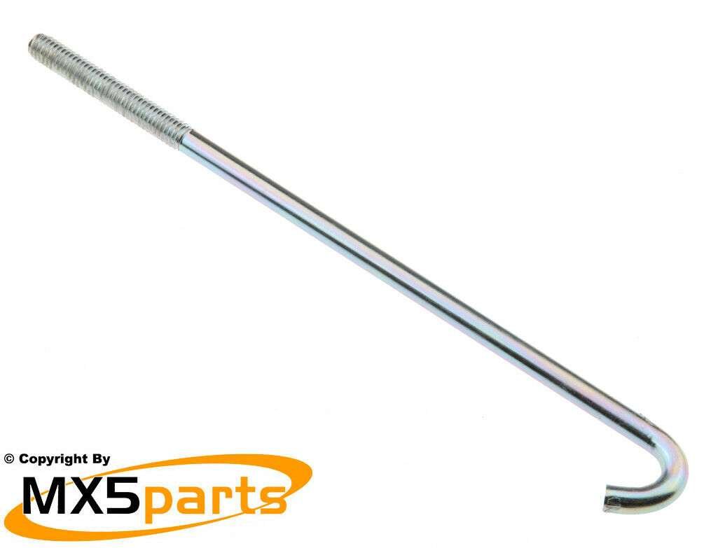

You'll also need a suitable 'J' bolt:
https://www.ebay.co.uk/itm/MX5-Battery- ... 2795917637

That's absolutely excellent! I'll have a word with the owner and see if she's happy for me to purchase a proper battery clamp and some dehumidifier pads...
I did notice there was some more mould on the underside of the soft-top when I put the roof up late this afternoon... I missed it when I did my clean-up so will have to attend to that tomorrow... More support for just overwintering/disuse condensation maybe?
Seems odd the battery clamp went walkies but not so long ago almost £3K was splashed out on the car for a full respray and maybe that's when the clamp went missing...
The respray was a good one... The pictures don't do it justice but the paintwork is of the highest quality... I'm not normally a fan of green but this one I do like
Under the bootlid seal there's not a spot of rust, even where it appears to be leaking... I'm surprised this was not noted during the respray and the seal replaced then...
