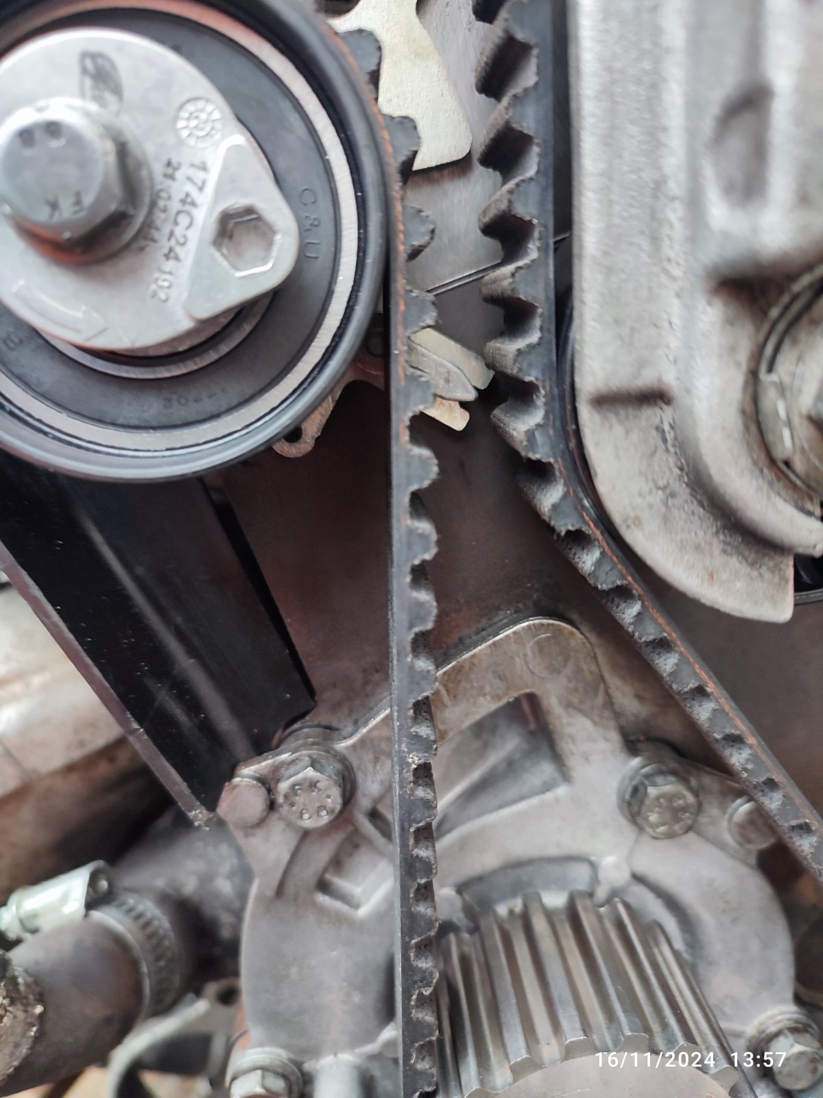

Re: Injectors misbehaving but trying to understand the numbers
Ok so I took the serpentine belt off and checked all the pulley's. They all seem fine no binding so I'm thinking it could be timing belt tension is too tight. I'm going to pull the top cover and have a look at the belt. I know I had it tensioned correctly but something might be rubbing. This is from when I set the timing belt. As you can see it's spot on so I can't understand what could be squealing.
Darren
Darren,
Have tried spraying all the pulleys in case its a dry bearing squealing.
Kenny
