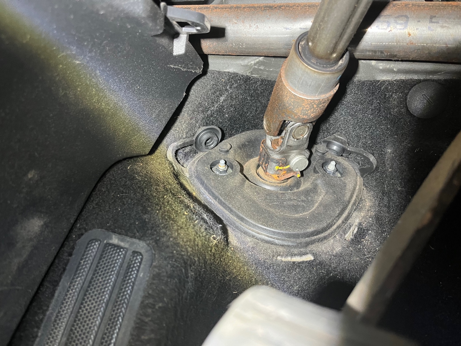

Well I've been reading up on all these horror stories about the steering rack for a few months now and it seem the reading of said stories encouraged mine to let go big time!
Not entirely sure where it's coming from, but I'm guessing the pinion seal as oil trail pattern is high up the pinion upper body.
I can't believe the amount that its losing overnight (car is a steel spring version so only small stand alone tank).
Did anyone come up with a theory as to what steering position makes it leak the worse or is everyone's different?
Just about to remove the large rubber grommet under drivers pedals ......
58 plate (2009) C5 Tourer 2.0 HDi VTR+
bigblackfalco
- Posts: 179
- Joined: 21 Feb 2010, 13:56
- x 11
Re: C5 X7 Steering Rack - Again!
well there's your answer lady .... looks like it's been at the bottom of the North Sea for a few years!
You know it's not good when you remove the footwell upholstery and the rubber plugs are already off the bolt heads!
Is the drive-in supply and fit place in Wakefield Yorkshire still in favour?
