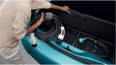

Regarding charging cables - the Zoe would have originally come with a three phase 16/32 amp Type 2 to Type 2 charging cable.
It should look something like the one below on the left:
This can be used at "slow" public chargers, or on dedicated EV home wall chargers like I have. It can also be charged on the AC connector on a rapid charger - not all modern rapid chargers have AC connectors any more (Instavolt and Ionity do not) but many do.

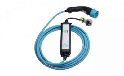

A "granny" charger was not supplied as standard but can be purchased for use with the Zoe to charge it through a 3 pin plug however it's not the recommended method as the Zoe doesn't charge very efficiently at very slow speeds (2kW) due to the design of its charger.
It's also not recommend to charge from a 3 pin plug long term on any EV just due to the risk of overheating the plug/socket. But it's Ok to use for a while. I charged my Ion from a 3 pin plug for about 6 months before I got a proper wall charger installed but I did keep a careful eye on the temperature of the 3 pin plug. A waterproof outdoor socket would be the best way to use a granny charger as using an extension cable has overheating risks due to the quality of many extension cables.
The Zoe granny charger looks like this but any equivalent 3rd party one with the same connectors should work:

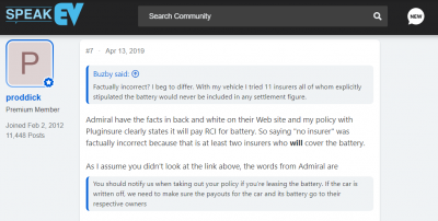

I'm sure one of the video's probably one of the lengthier ones covered INsurance with a leased battery. This is it here Used Renault Zoe Can a case be made to buy one
This thread on Speak EV mentions some practical difficulties in the event of a claim and a bit of the usual "tit for tat I know better than you" which I find both unnecessary and irritating, and one of the reasons I dont participate in that forum. Key thing I took from the thread is that some of the key players eg Admiral are more switched on than the others.
In the event of a claim RCI who own the battery will expect to be paid the full value of a replacement battery as their loss. They will get that one way or another either out of your pocket or from the insurance policy you have taken out.
Worth getting the clarification you need direct from the insurers when taking out a policy, and try to find one that has some clue about the battery lease arrangement.
Generally recommended or indeed its pretty compulsory that the value of the car is stated to include, the payout to RCI for the loss of their battery.This contribution quoted from Admiral
https://www.speakev.com/threads/insuran ... ry.137584/

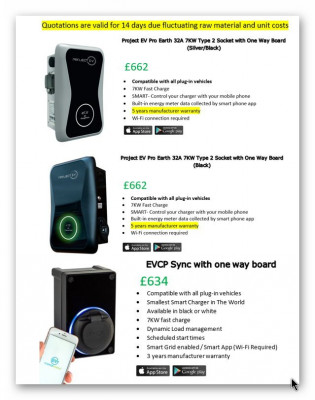

These quotes arrived today, what do you guys think?
