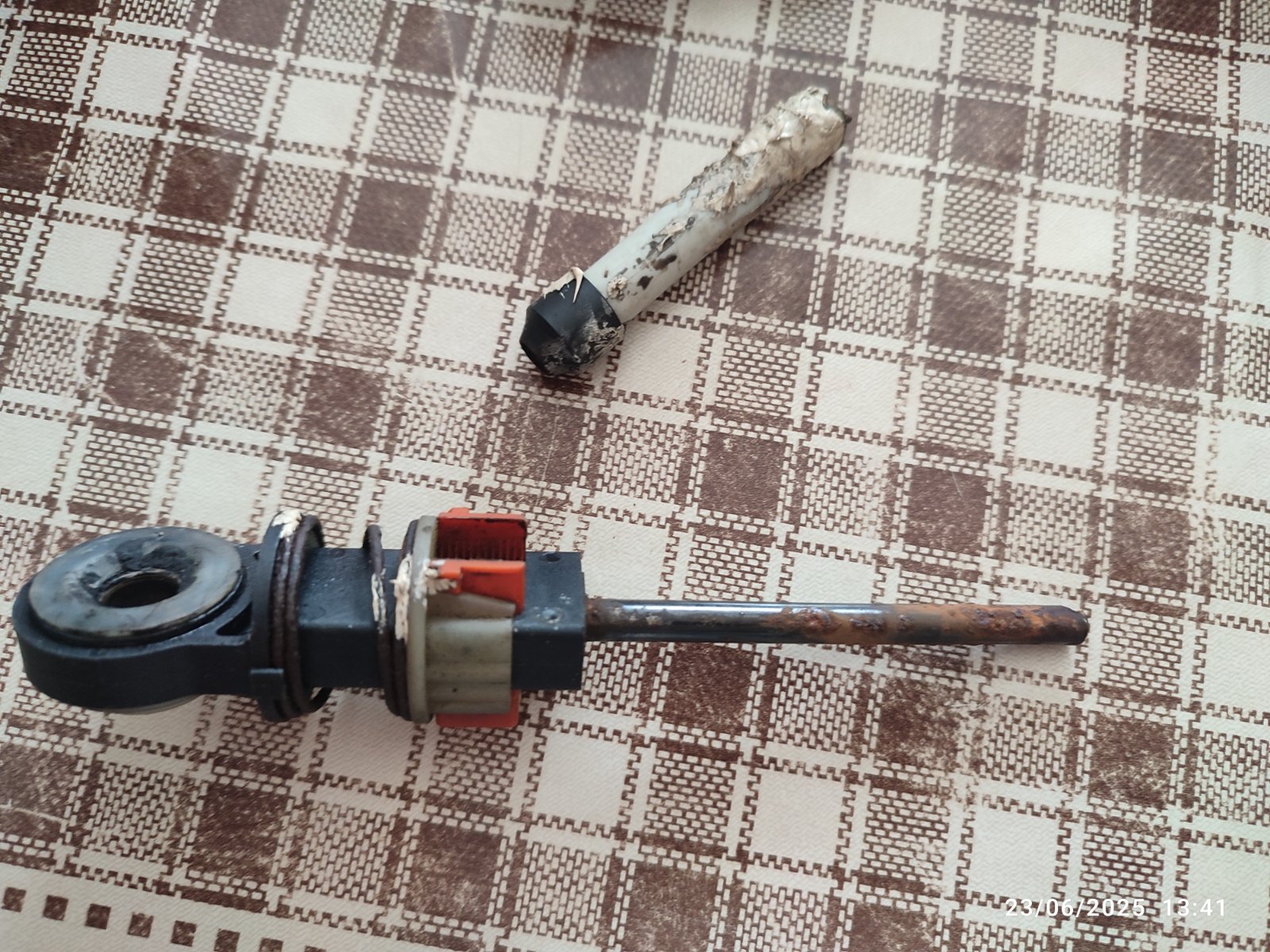

. I couldn't get her into reverse tried bleeding clutch again no joy.. Rediscovered some of Gunther's ( my pet name for the previous owner) handy work,he was at the cables for the gear linkage. I had noted it but chose to ignore it until this morning. I have to replace it now as well so NCT is postponed for a couple of weeks.I have a pain my choose your expletive.found a replacement for €120 on eBay so have to wait on it to make the camel journey from Lithuania.

Oh dear! Keep battling it!
Be slightly grateful it broke down in a semi convenient location - I was forty miles from home when my (C4) cable went! Thankfully it was the "left-right" one of the two so still had choice of third and fourth so was able to limp home :)

Yeah I was getting ready to bring it for a spin to see how it went glad it went when it did. Could have failed on the road which could have been very dangerous on my road.
