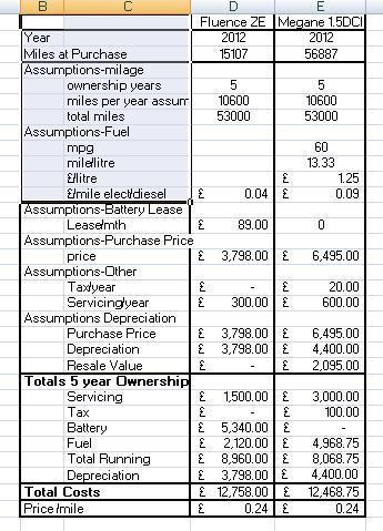

https://vcache.arnoldclark.com/imageser ... V-H-/800/f
This is a nice secondhand electric vehicle, 22KWh so not in the top drawer of range, but it is a Renault and it will have the battery lease. Talking of little spreadsheets, I had a bit play around with a few assumptions, including a harsh assumption that the Fluence ZE after 5 years of ownership would be worthless.
Tried to pick out a comparible ICE vehicle and plumped for the Megane 1.5DCI of a similar age, and ran a few not very well researched assumptions in, but in general what I would term "roughly reasonable" ie diesel will cost more than electricity (twice as much is probably conservative) and published mpg will be an overestimate so scaled it back from 67mpg to 60mpg for the diesel.
Works out roughly the same on my calculations.....second hand electric vehicles with leases are pitched at a purchase price less than comparible ICE vehicles, and open for a bit of hard negotiation below the price ticket on the windscreen. They depreciate faster (I have assumed back to zero), but the ICE cars also depreciate, and fuel, tax and running costs all run in favour of the EV.
Lies, damn lies, and my spreadsheets, assumptions can always be tailored to give you the answer you want :!: :-D Even with the battery lease you could make an arguable case that the EV comes out broadly the same as an ICE equivalent.
