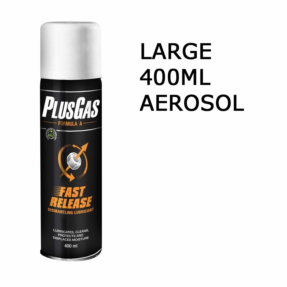

How about "DON'T DO IT?"
It's a job I've been putting off on mine for years.
First thing: Order some replacement manifold studs as I pretty much guarantee your existing ones will probably be like mine (ie corroded so badly that they risk snapping and at least one of mine is about half the diameter it should be at one point).
Get some PlusGas and go through a period of pre-soaking the nuts to break down the bond between the nuts and the studs and NO you cannot use WD40 or anything else. PlusGas is your best friend. DITCH your current best friend!
Stock up on patience and practice undoing seized nuts. Slight tighten, slight loosen, retighten, loosen, retighten, loosen, ad infinitum until ANY rust ahead of the nut clears and does not cause the nut to bind and snap the studs. It's the single most useful tip ever if you don't already know it.
This is PlusGas (don't buy make the mistake of buying the liquid PlusGas cylinders I see they sell in Aus).

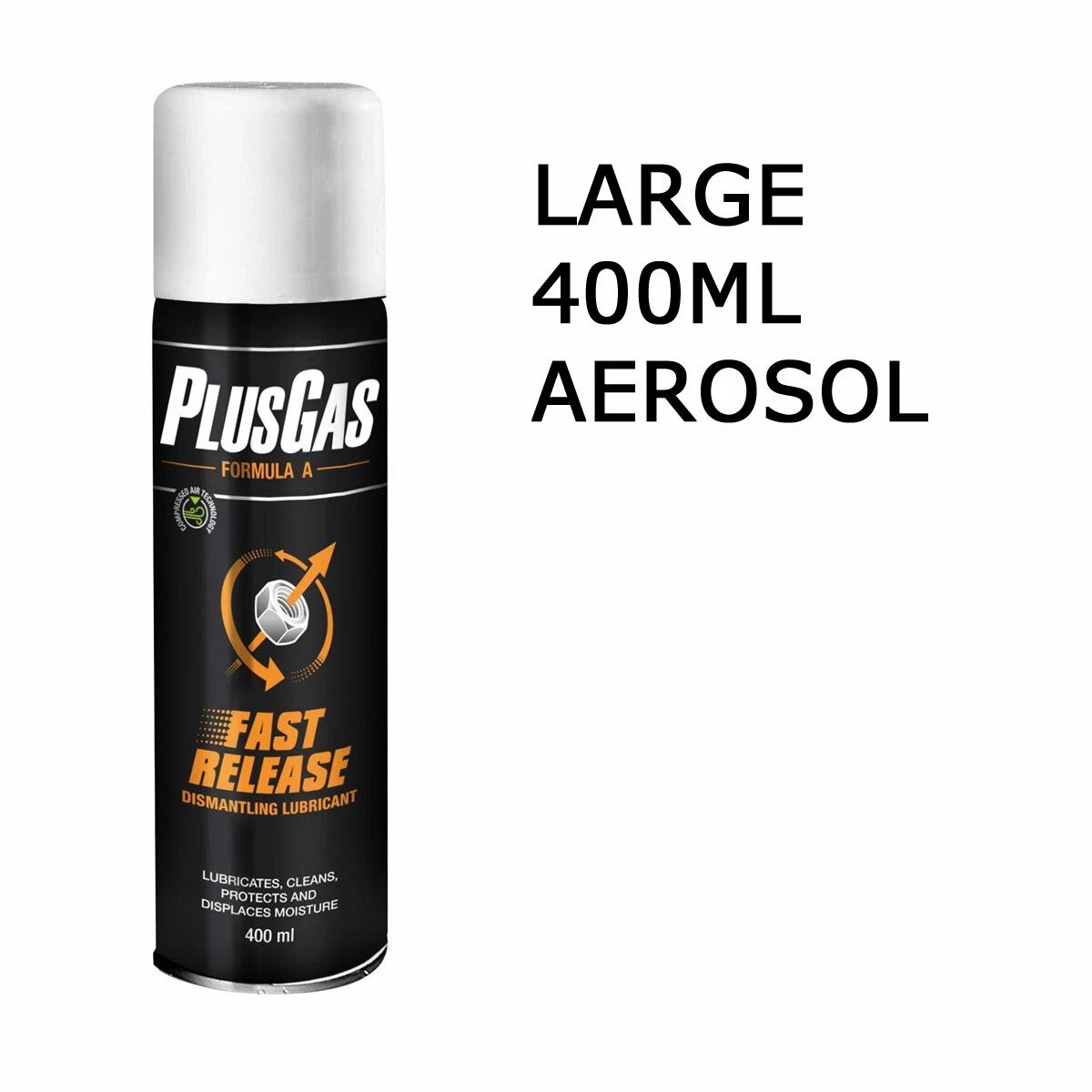

How can you just put off doing the job? (Unless you pay (or bribe) someone else to do it for you!)
I haven't seen or heard of PlusGas (either variety).
If this Wurth product is an equivalent, I have a small quantity of it.
But maybe this Wolfchester product is an equivalent. And Wolfchester claims to be better than Wurth. (Don't they all?) But they seem to be cheaper. I have a small quantity of this one, also.
And no, I would never consider using WD40.

PASS! You would have to check their comparative qualities. They sound similar for sure but only experience in all products would trump actual data sheets.
You can get PlusGas in Aus as I've seen it on Ebay specifically. I did a check before posting.
