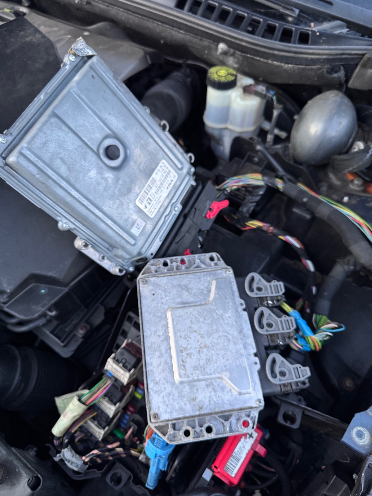

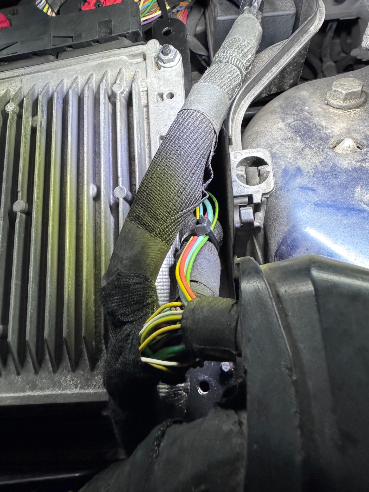

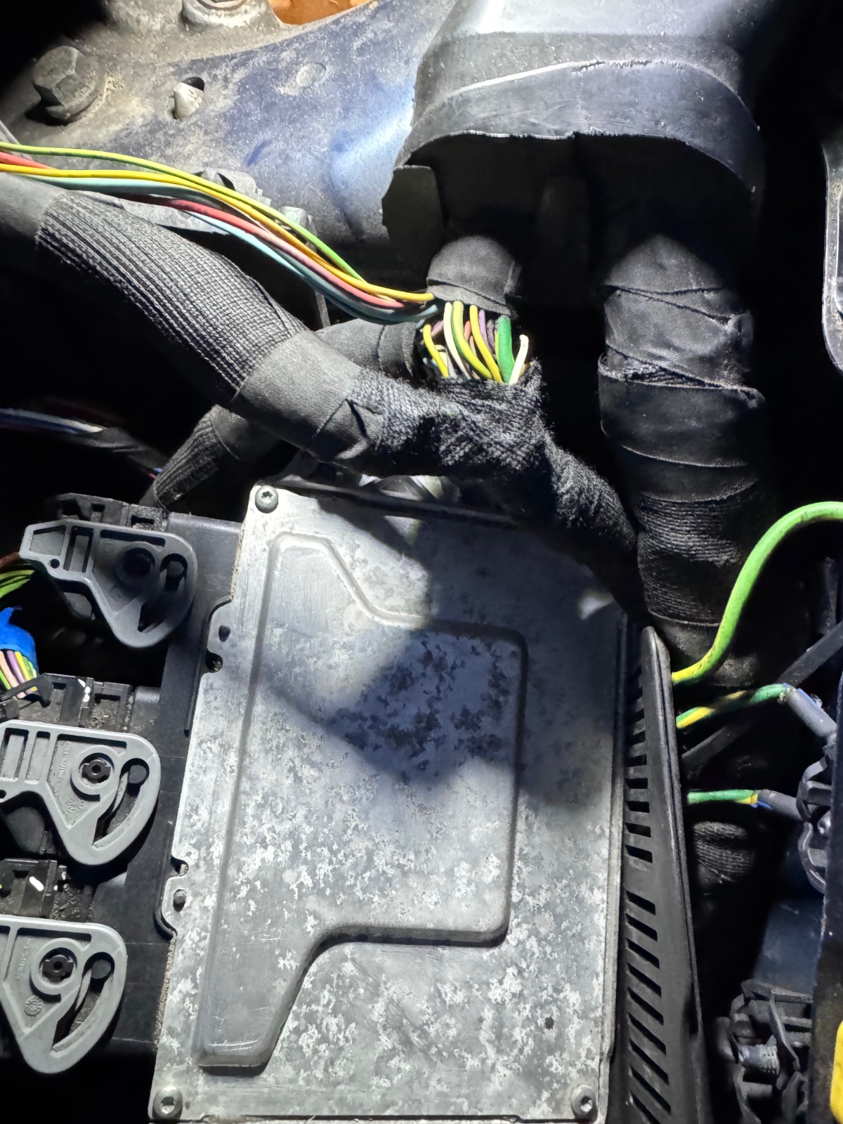

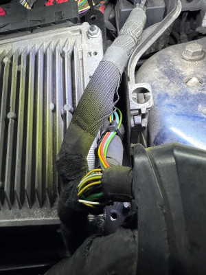

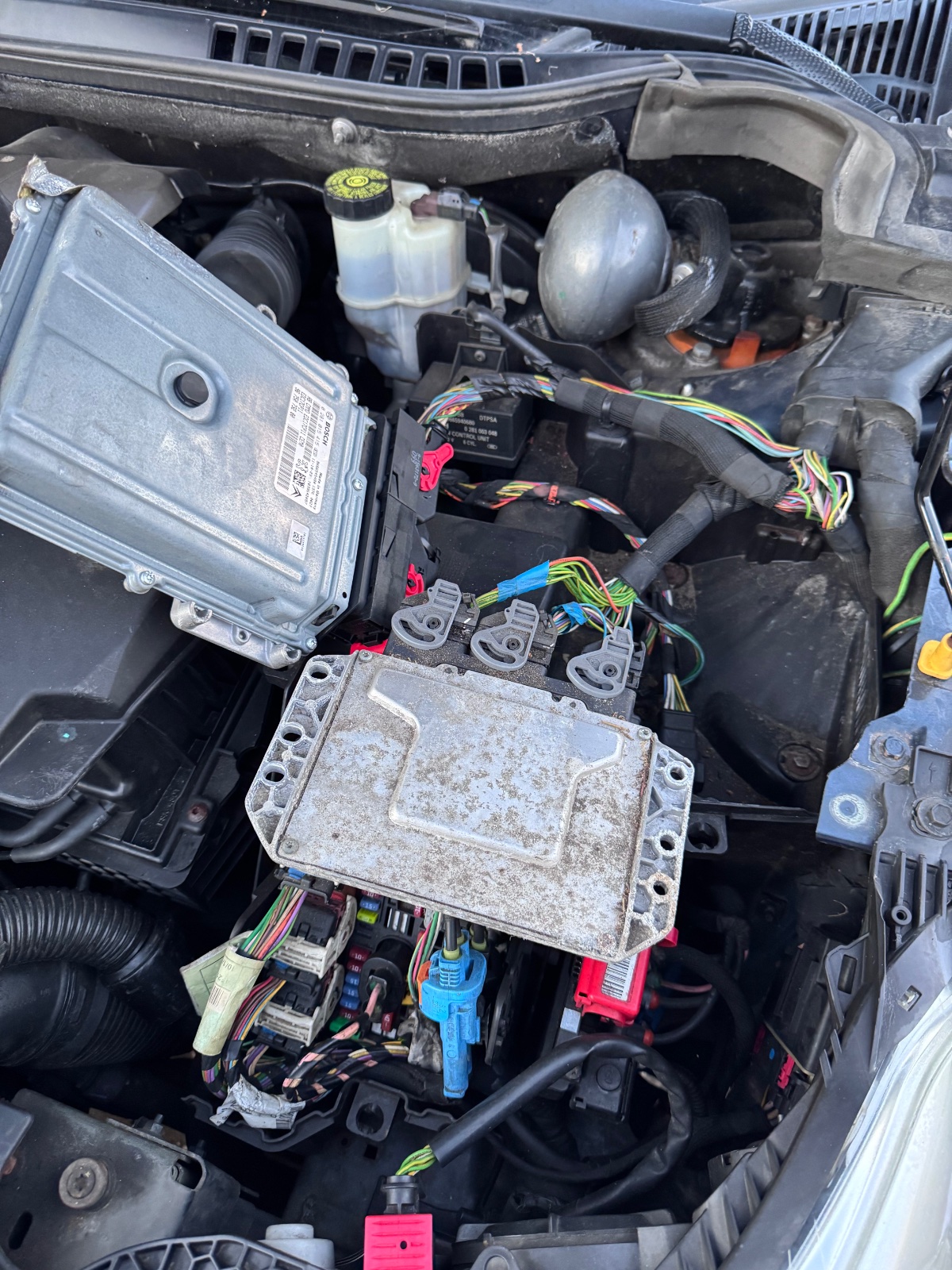

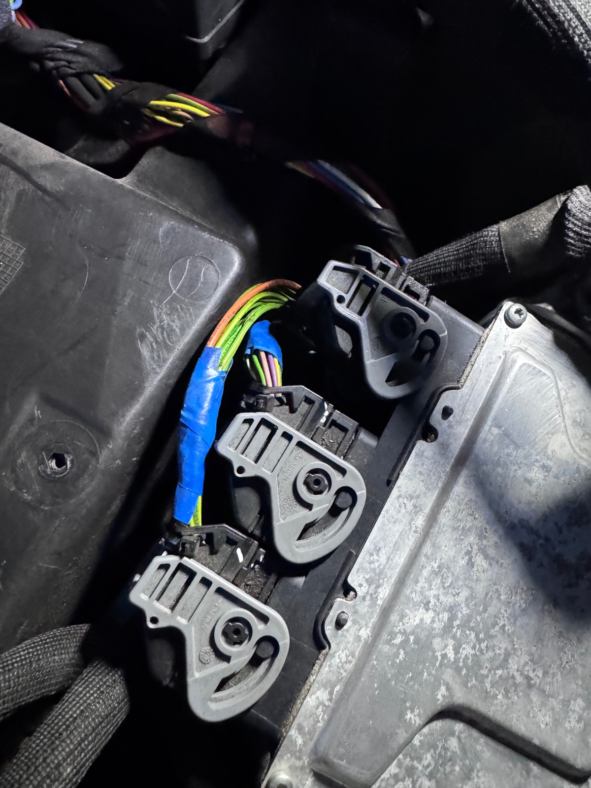

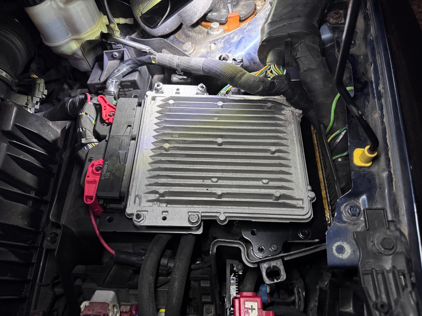

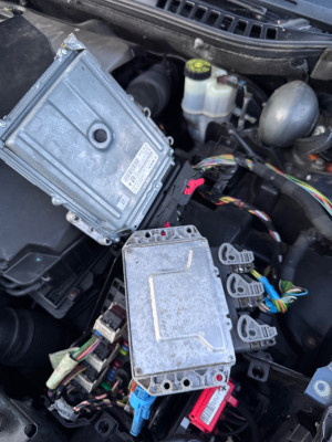

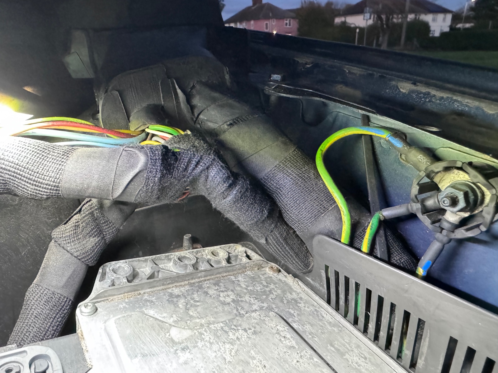

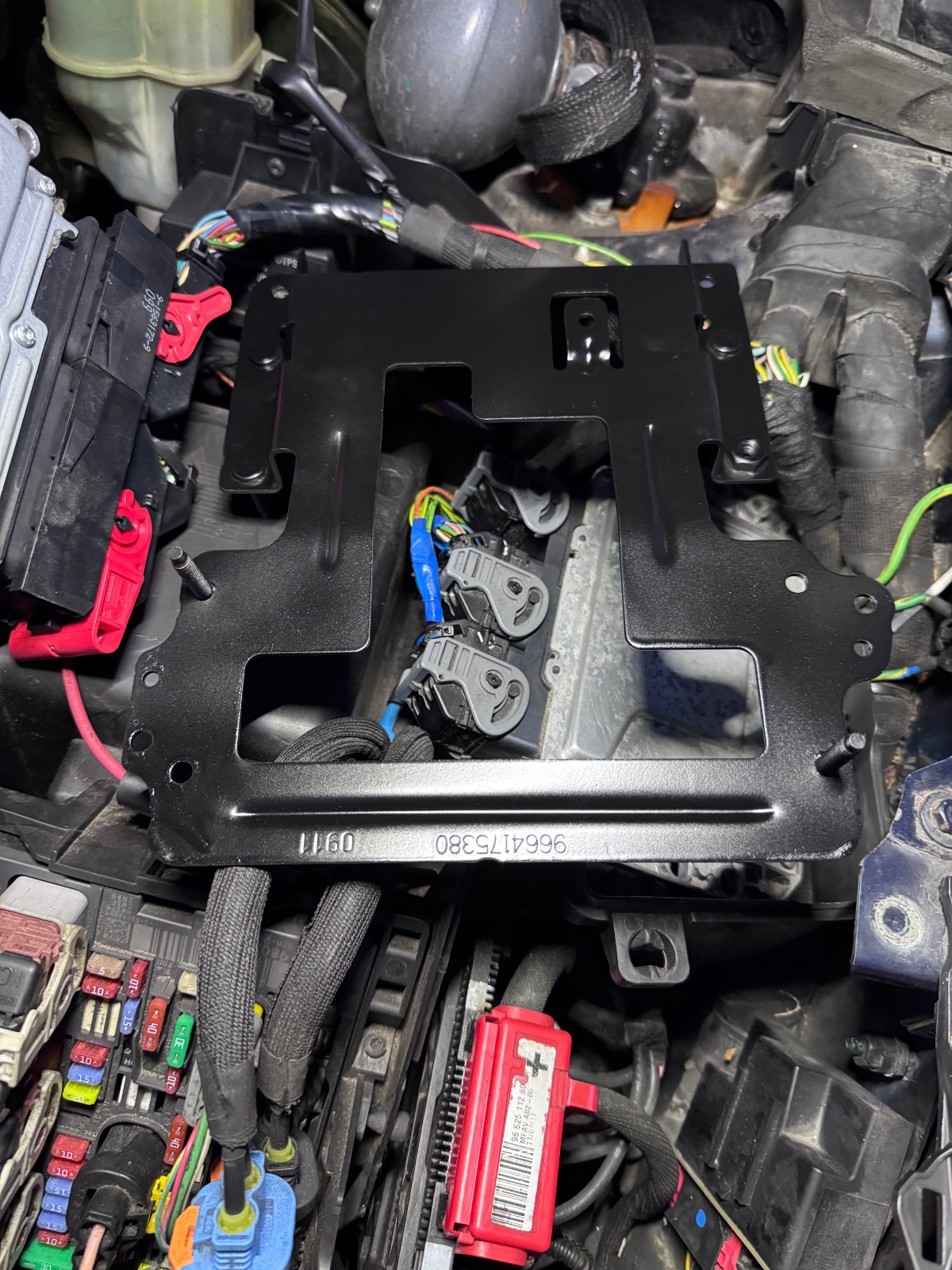

Just to close this off, now a month on and it hasn’t missed a beat. No idea what the cause was - which I hate!
I took the ECU frame out (due to minor surface corrosion, which for no functional reason, I just couldn’t ignore) wire brushed and satin black hammerite spray painted it.
Brass wire brushed off the surface corrosion on the ecu’s, cleaned out all the dust, dirt, some odd (what looked like shredded nut shells from a rodent taking something into the engine bay to eat?), re-wrapped the looms where the original insulating tape had come loose (kept to the same black and blue colours because…) changed the tie-wrap round the loom on the main ECU plug (thicker cable tie that I think is less likely to cause pointed specific chaffing) wrapped the bare loom in the ‘y’ split area in fabric look tape, reinforced the loom wrap with additional layers of fabric tape where it ‘rubs’ on the corner of the ECU, cable tied the spare/loose wires against the main loom (so it’s no longer flapping around) and then reassembled it all.
Didn’t take pics at every step because I just wanted to get it done and then light was running out, but a couple for what it’s worth and in case there’s any useful info for someone going in there in future.
