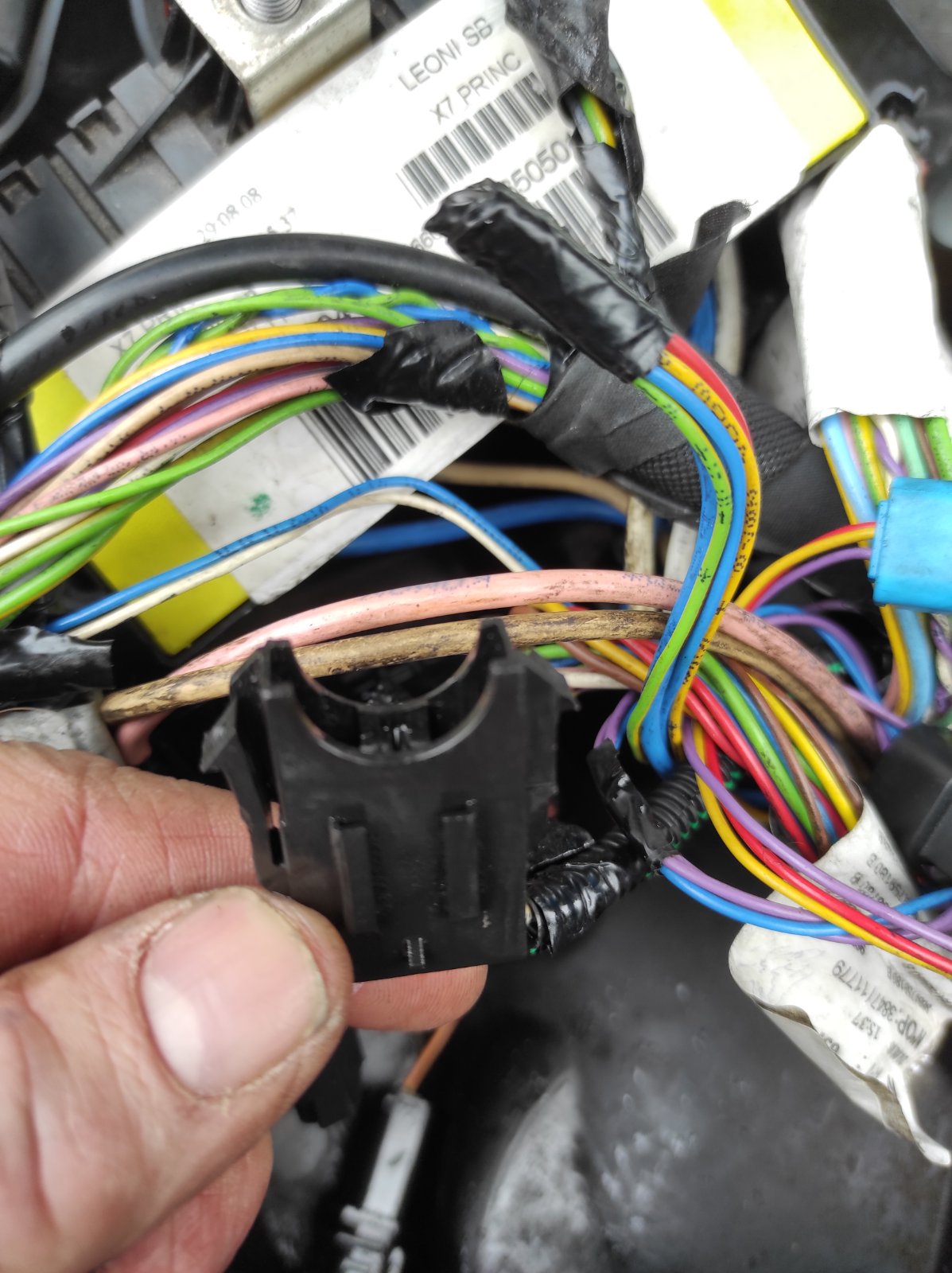

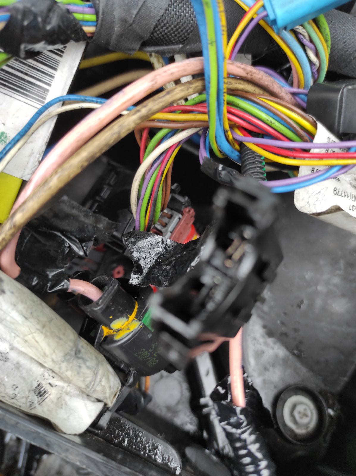

I would replace those earth wires as this could be responsible for a lot of your problems. I think you are almost there.

I am almost there I want to see if it's possible to split the connection enough to replace the cable it looks like its welded along the seam. I will wait until the replacement arrives just in case.

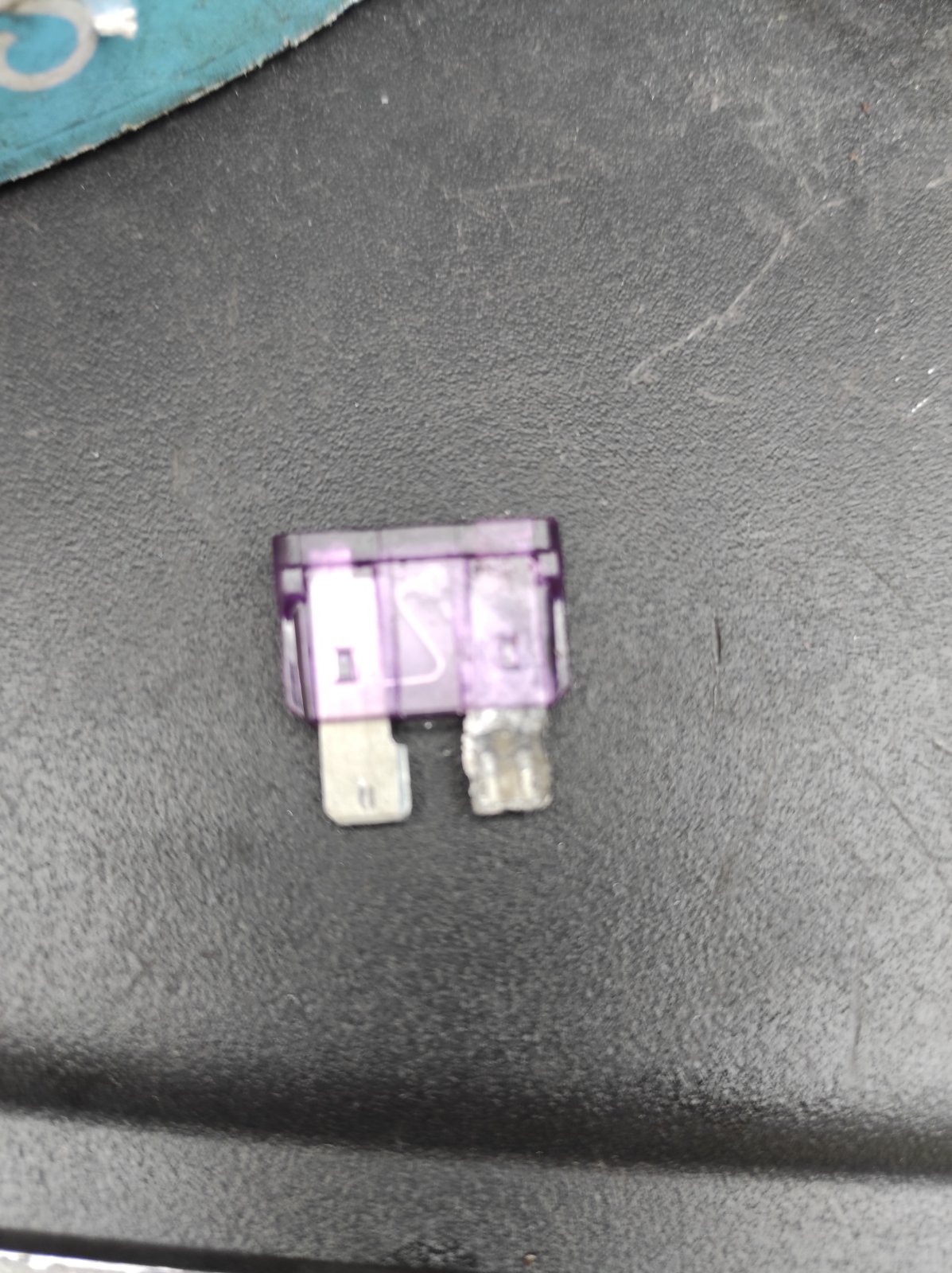

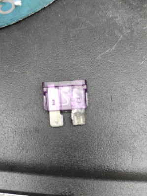

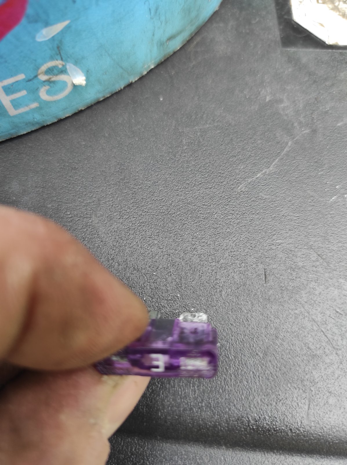

I did however find a blown fuse on the positive side of the battery it's a 3 amp fuse and it was heavily and blown corroded on the leg on the battery side. (could be my open circuit).
I don't have any of these types of fuse so I will need to pick some up. I wonder if this is supposed to have a cover over it. Can someone have a look at theirs and see please? It attaches to the live side of the battery and if you wouldn't mind would you take a picture of the inside of the ECU and fuse box cover please.i don't know how I missed it.
(A) what size fuse it should be?
and
(B) Should it have a cover mine was in the ECU housing no cover but looks like it should have see pictures below.
and

Re the fuse I know mine is hidden under the BSI and NOT protected.

Ok thanks Kenny, so they are not protected. I will just swap it out, hopefully this will be the answer to my problems.

The fuse has blown for a reason!!!
Do we know what it supplies yet and whether the rating was correct?
