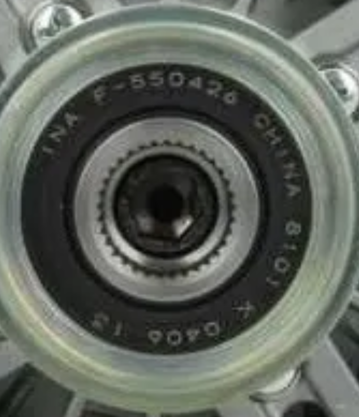

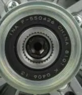

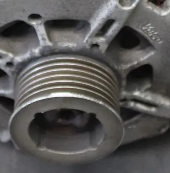

Trying to confirm what fixing types I'd need in the alternator,
This one: https://www.ebay.co.uk/itm/255881302348
Looks like splined outer and Allen type fixing in the shaft.
Where as this one looks like... I've not a clue!! https://www.ebay.co.uk/itm/394537577310
Not many second hand ones have lost the plastic clip on cover over the end of the pulley, so pictures of what's within hard to find!

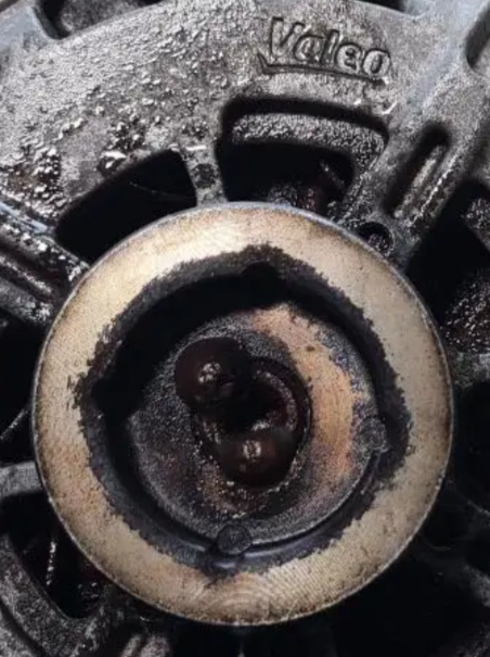

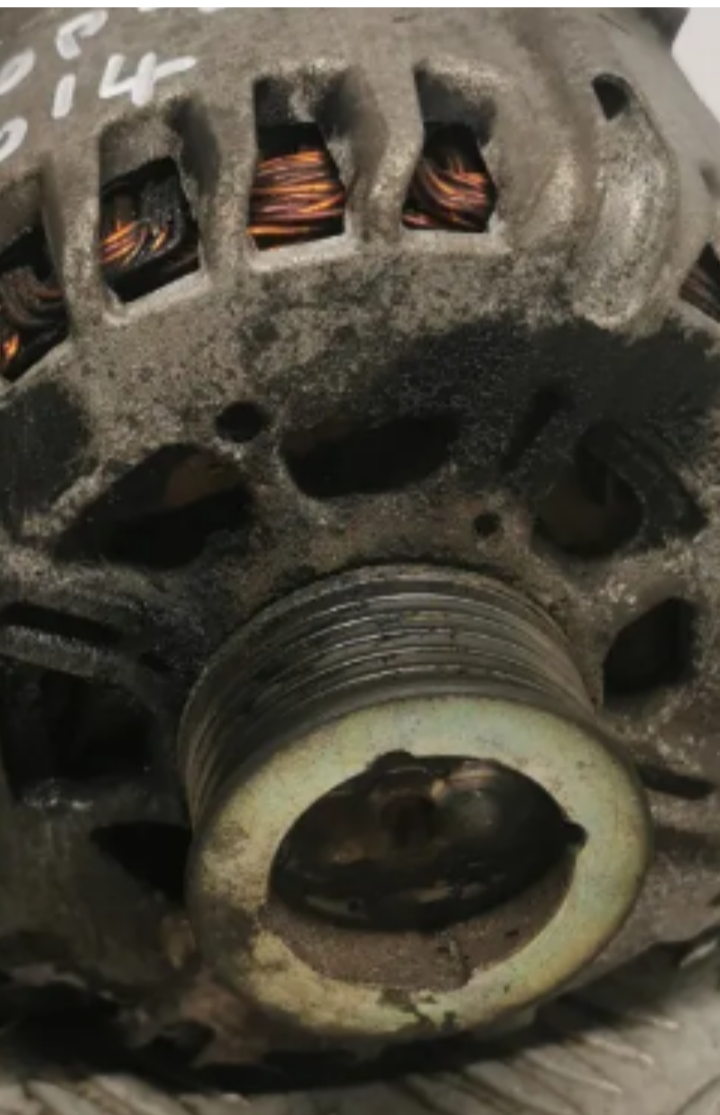

Splined outer and... Too dark to see shaft
https://www.ebay.co.uk/itm/364117855924
Hmm, another weird looking one: https://www.ebay.co.uk/itm/115751064910

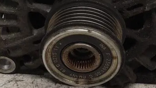

Ahhh, a pretty clear image of the weird version, and to be honest I understand it even less seeing this!
https://www.ebay.co.uk/itm/204296686411
Almost looks like two blobs of weld on this image,
Weird version are all on Valeo units, the others are an INA pulley on a Mitsubishi manufactured alternator.
Existing alternator fitted is Valeo, the cheap replacement I've bought is Mitsubishi.

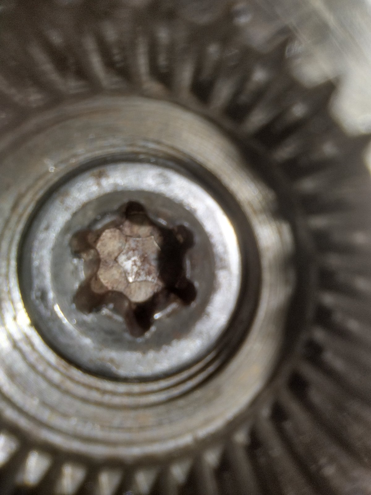

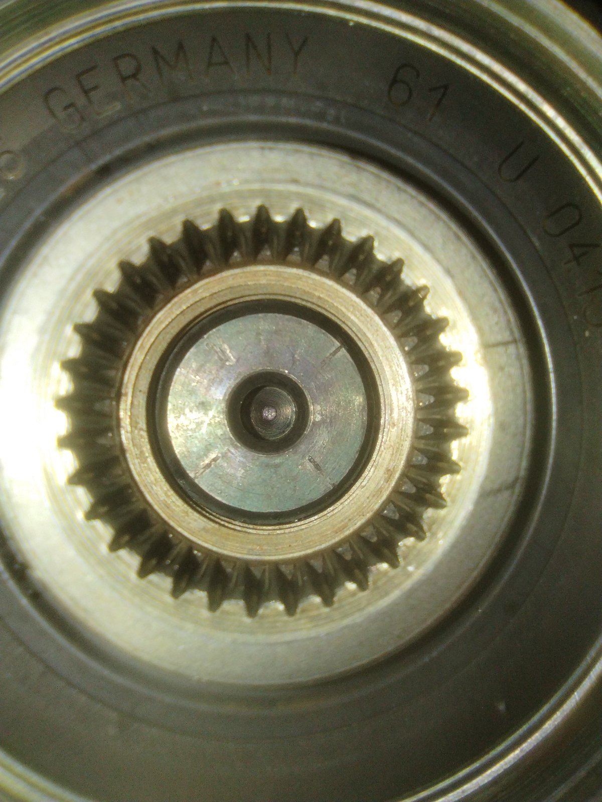

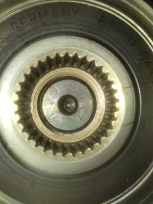

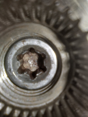

Held off ordering a tool kit, wanted to try and confirm what I've got at present. Plastic cover prised off and couple of terrible phone pictures:
Splines outer, Torx on the alternator shaft.
Kit on order shortly

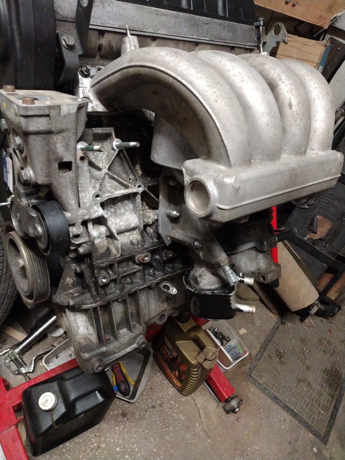

Back to the 406 Coupe and EW10J4 to EW10A swap preparations.

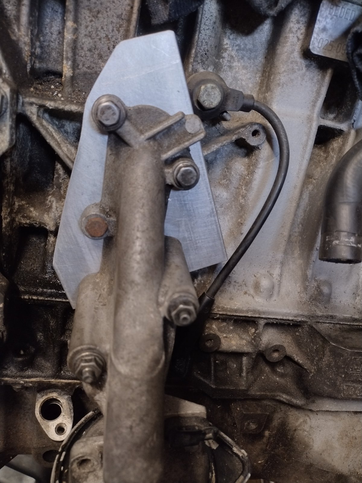

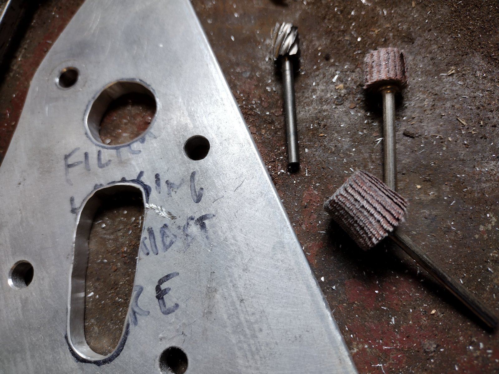

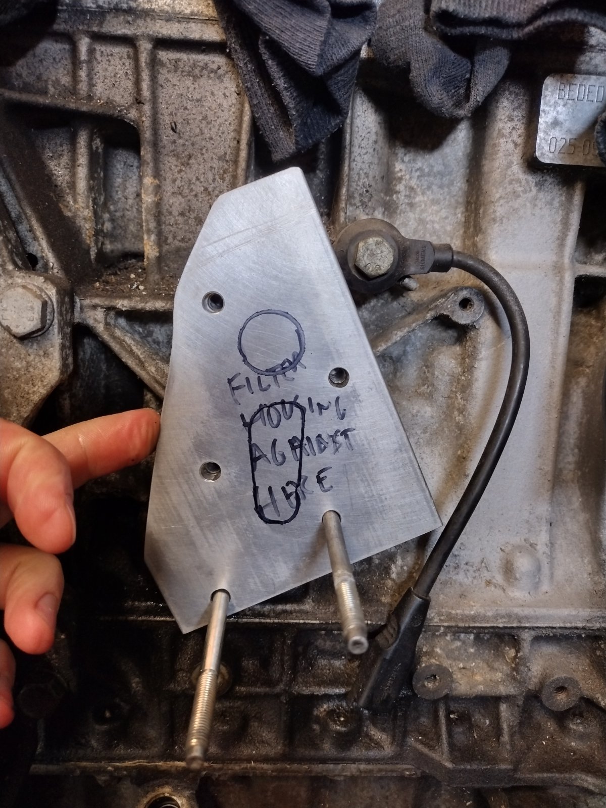

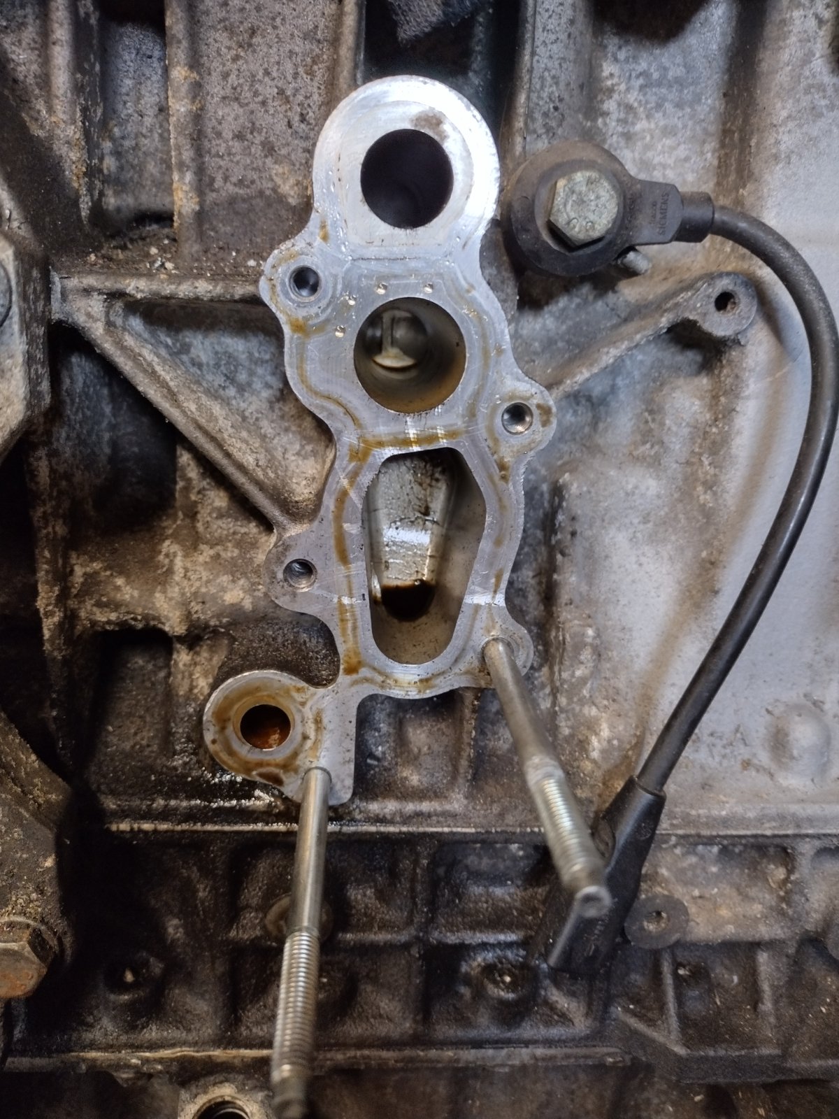

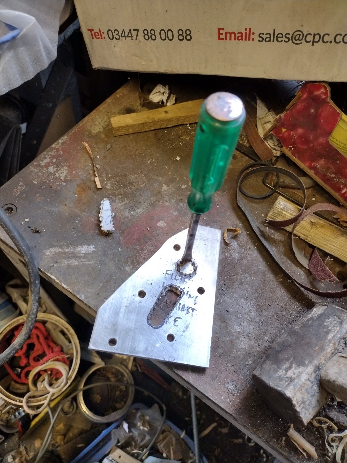

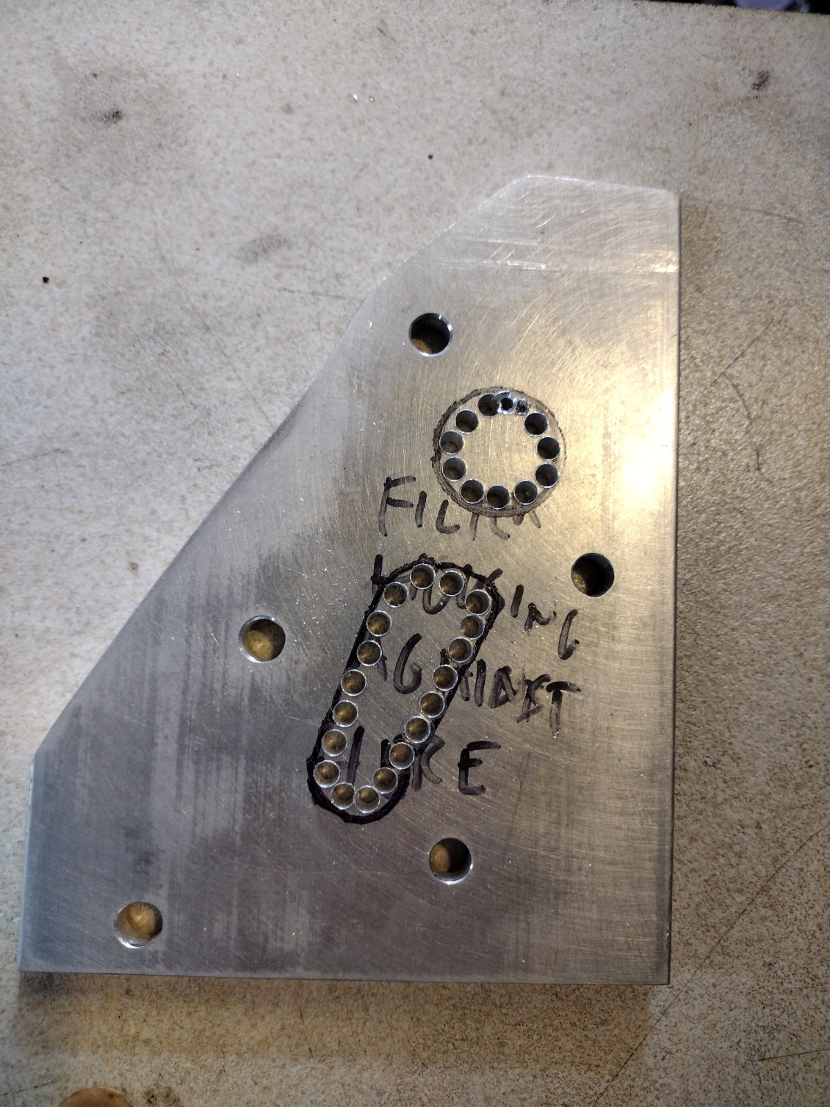

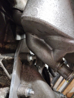

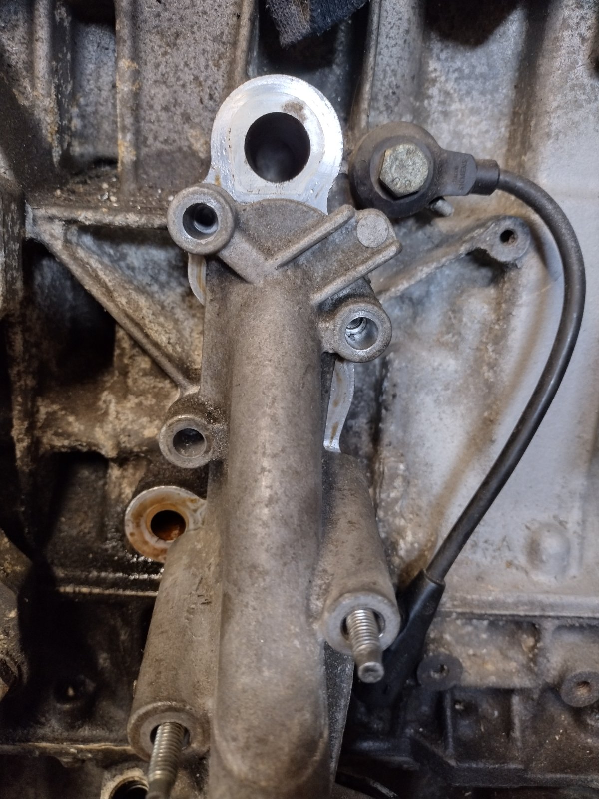

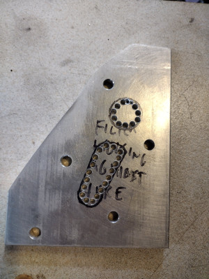

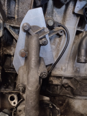

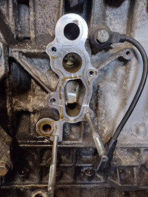

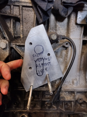

Oil filter housing (incorporating oil/coolant heat exchanger) on EW10A has two additional ports between it and block.
EW10J4S inlet manifold clashes with heat exchanger, so swap to EW10J4 oil filter housing instead, but need to deal with the redundant ports Longer bolts and studs required, but another head scratching point dealt with

That's a top job Matt

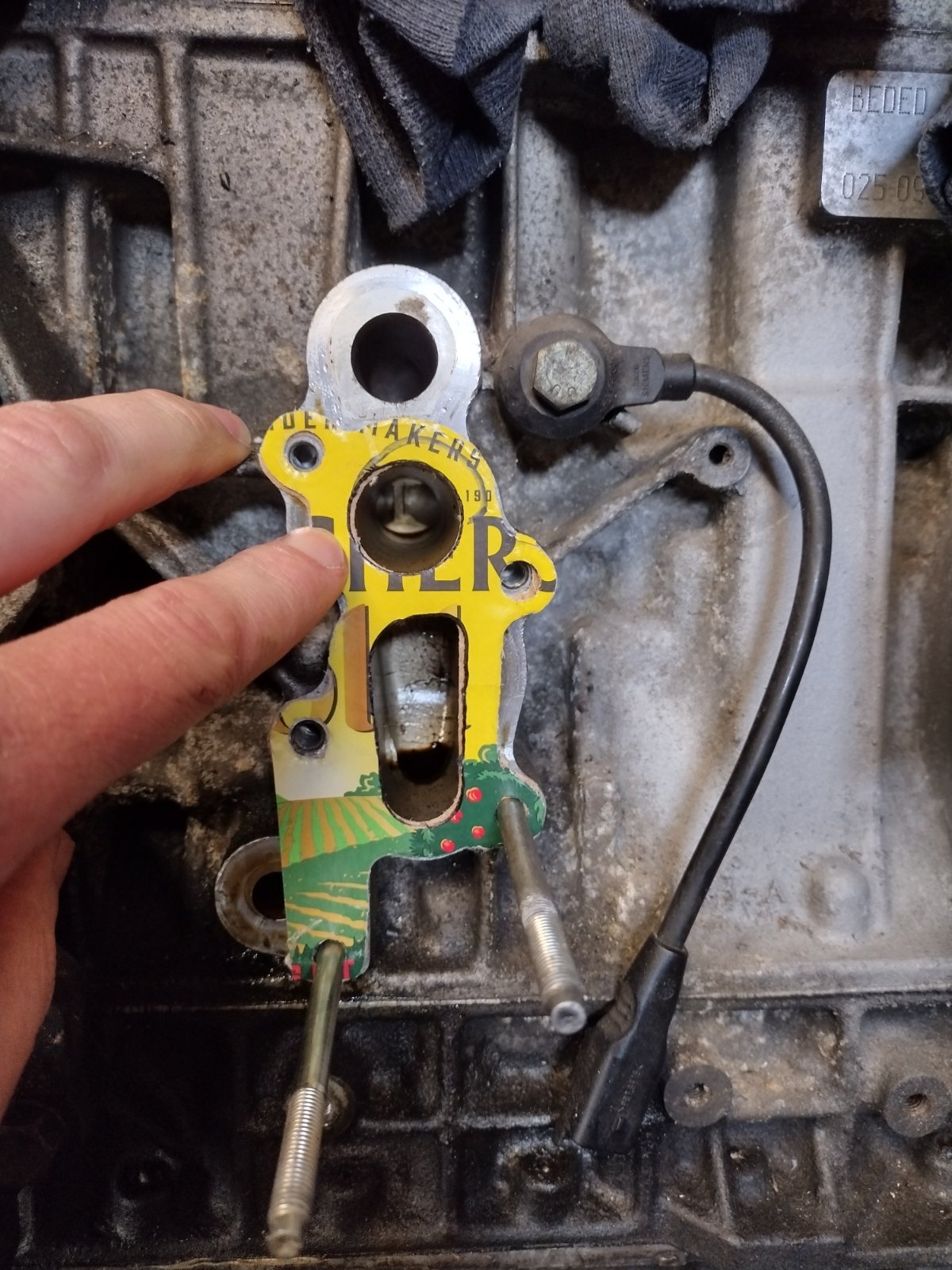

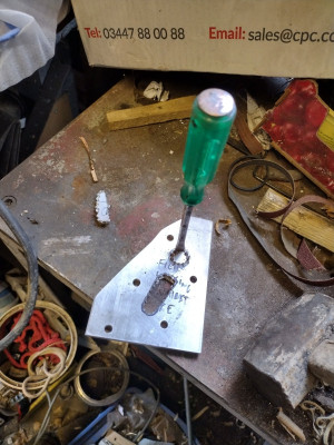

Cornflake boxes ok, but strangely the grey cardboard they use is quite a bit weaker than the brown cardboard that beer, cider and oddly, Weetabix type cereals come in!CitroJim wrote: 10 Apr 2023, 15:45 That's a top job MattLoving the gasket material! Definitely a step up from my old staple - cornflake packets
Gaskets formed by the "tap it out" technique - the EW10A doesn't have a flat gasket, instead a molded collection of O-rings as standard, so have to be a bit more inventive on this area.

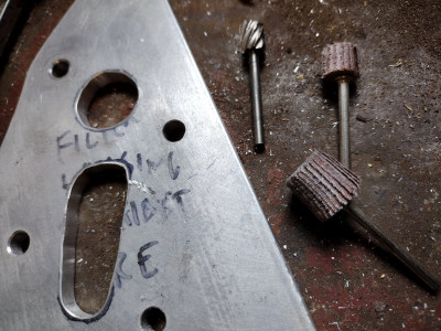

Tapping out gaskets is one of those "strangely enjoyable" tasks. It's proven very handy on this job as allows me to tap a gasket from each half of a pair of mating faces - that way I can confirm compatibility of bolt positions as well as e.g. oil, coolant passages etc. Have done same for EW10J4S inlet manifold Vs EW10A head - there's some tweaking of the ports there as injector positions vary between the two it seems (would result in injector spraying against flat surface it appears!) So work to be done there and the couple of "gaskets" (which are the grey cardboard in this case:) ) will be my guide as to if I have done what's needed.

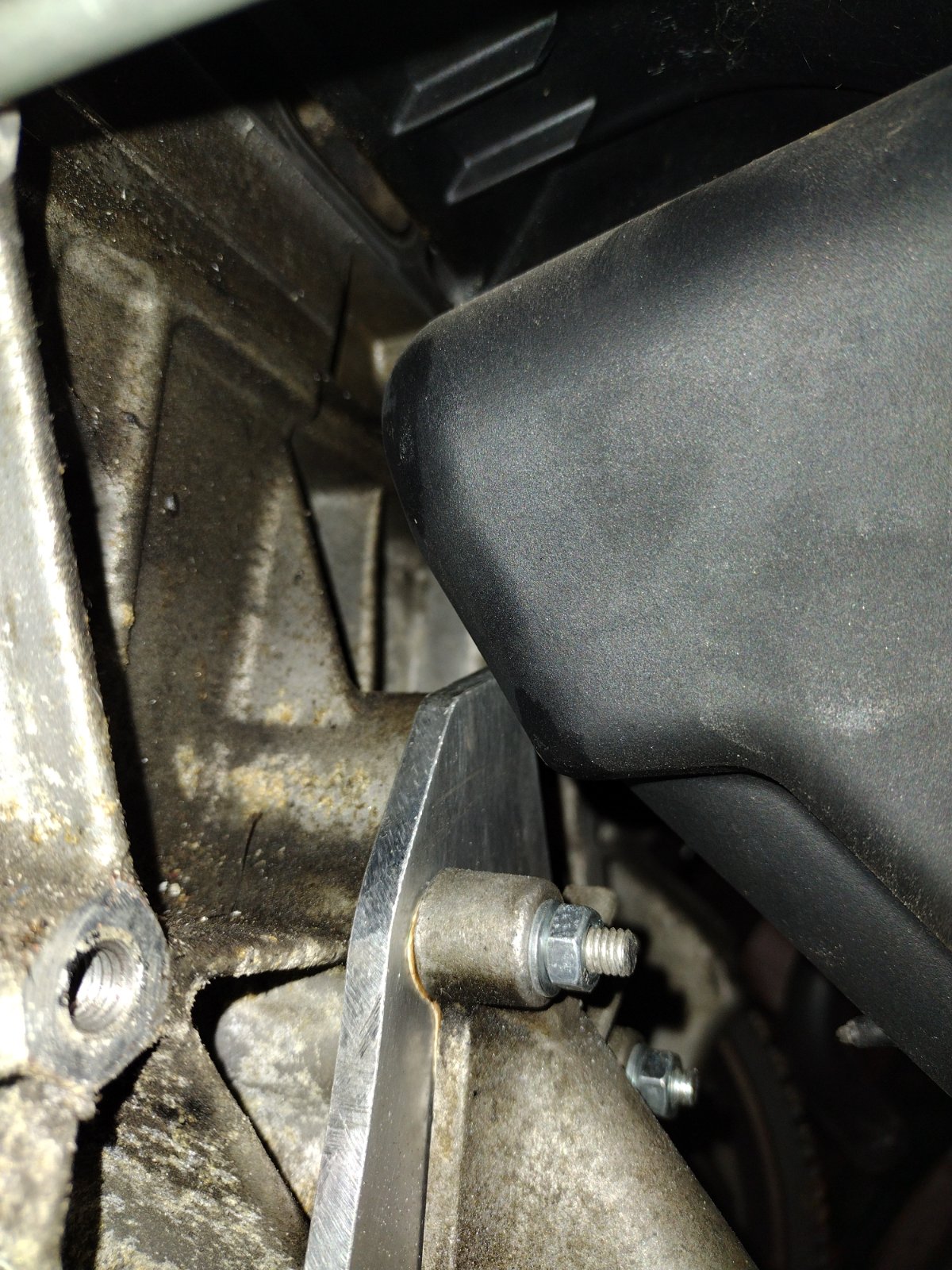

My potential interim solution was to get the standard inlet onto the EW10A, but ...
- Posts: 5364

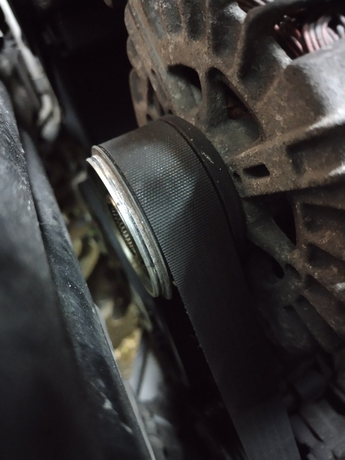

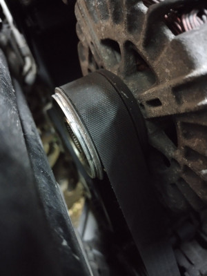

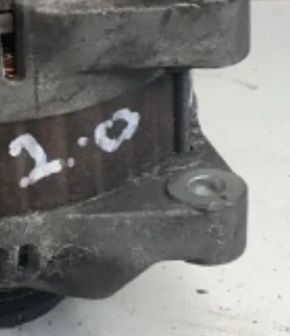

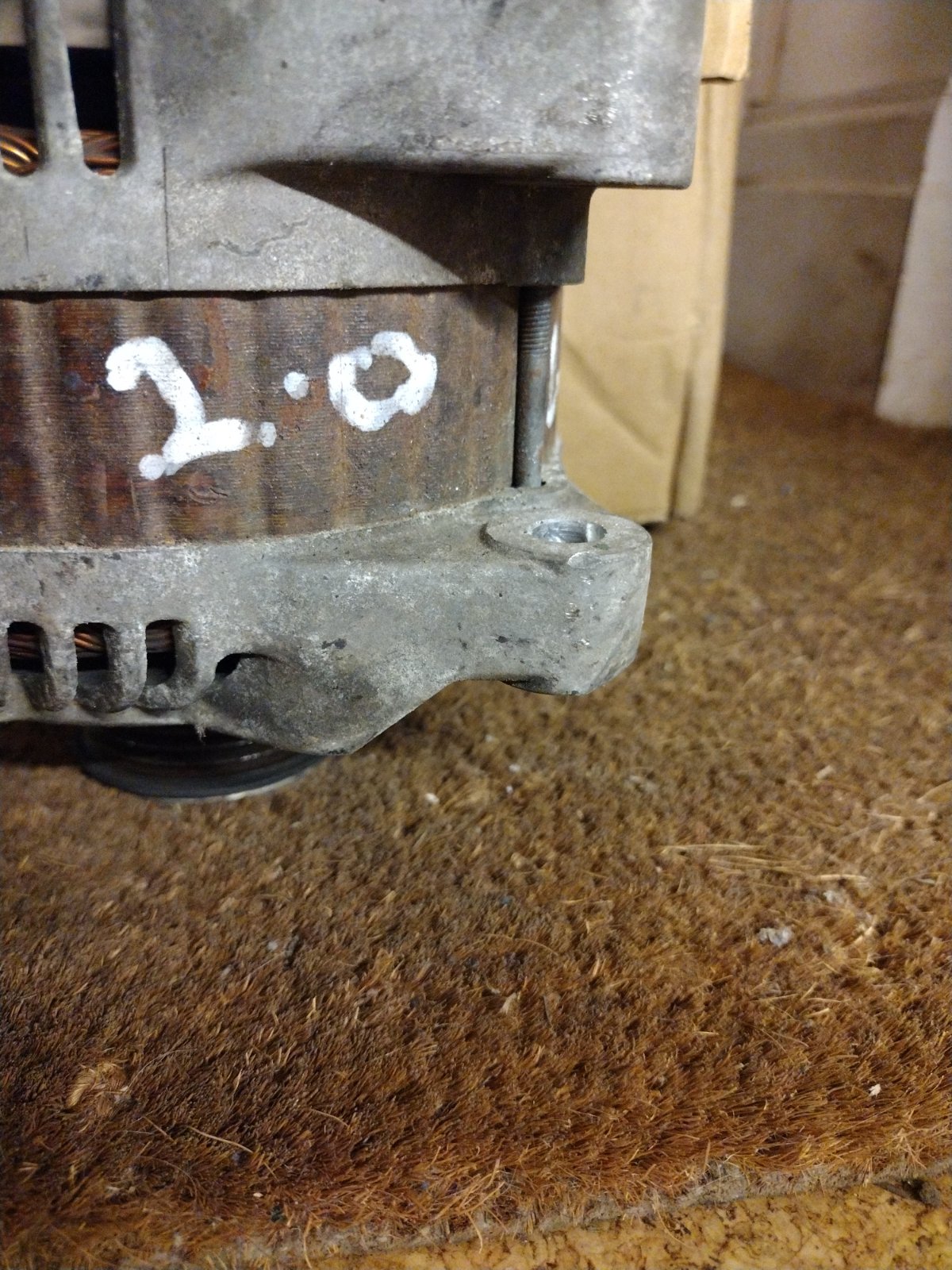

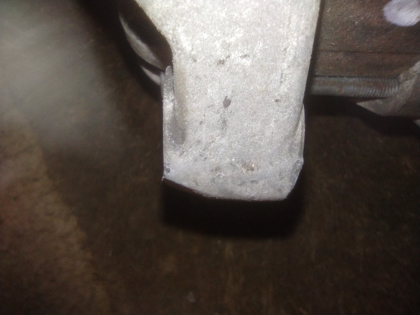

eBay bargain alternator arrived today, well wrapped - nearly a full copy of "classic car weekly" as the scrunched up padding - which now I've flattened out to go in the recycling I'm trying very hard not to read it!

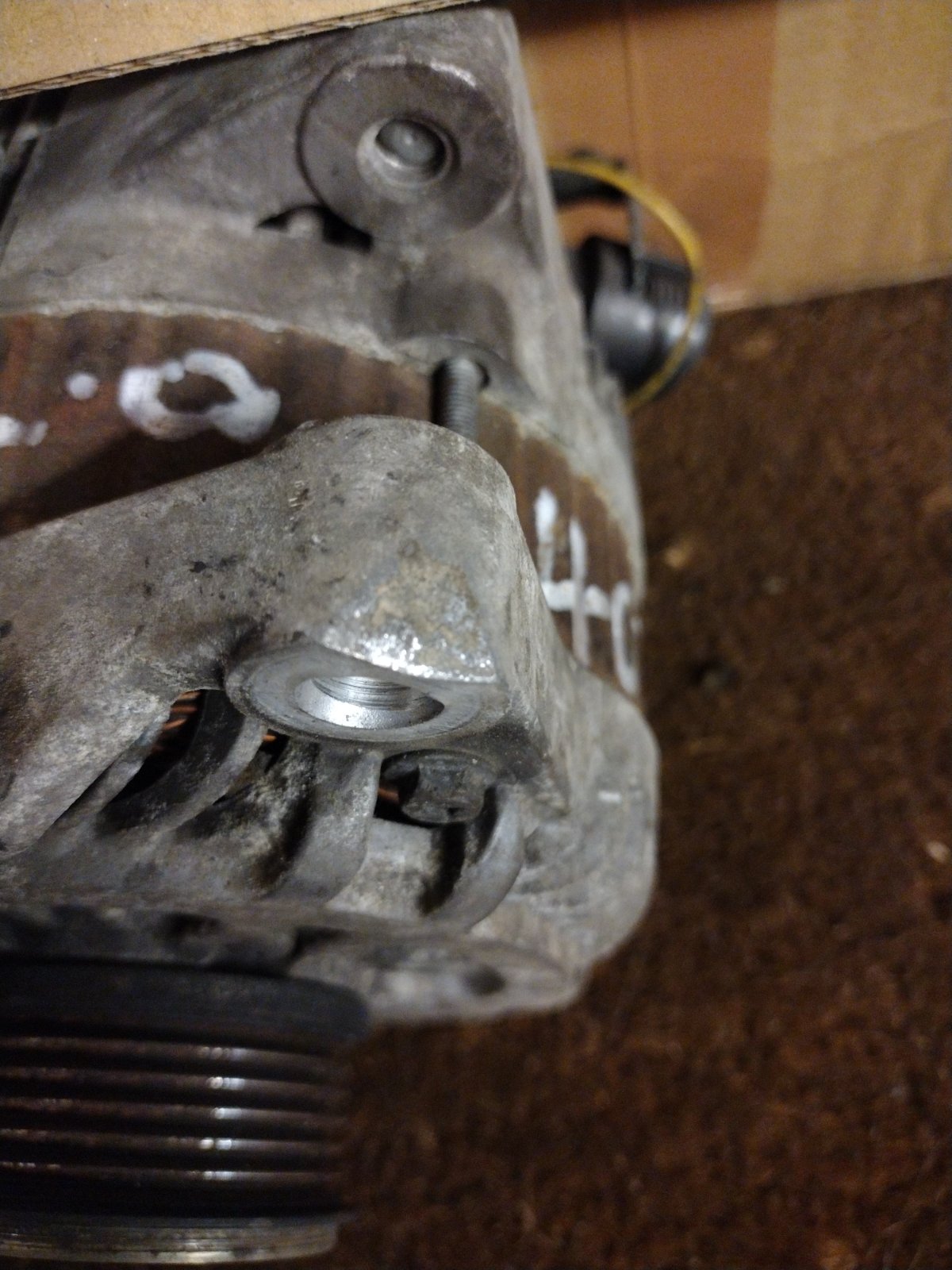

Popped the plastic cover off gives a confusing sight: The expected splines on clutch pulley, but only a smooth cylindrical hole in the alternator shaft!?! So Torx bit or similar a nonstarter for that. Hmm. Will wait for the kit to roll up, perhaps I can shock the pulley loose without restraint of the shaft.

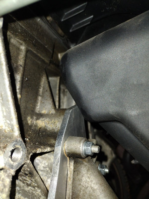

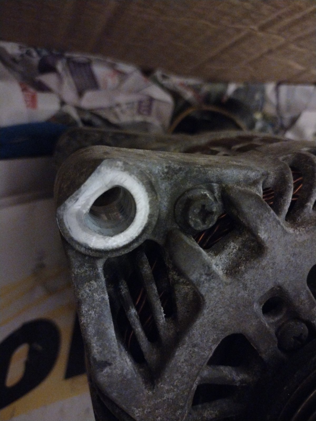

Clutch pulley slips in one direction alternator generally seems fine. Though puzzled if this mounting position is supposed to be D shaped!

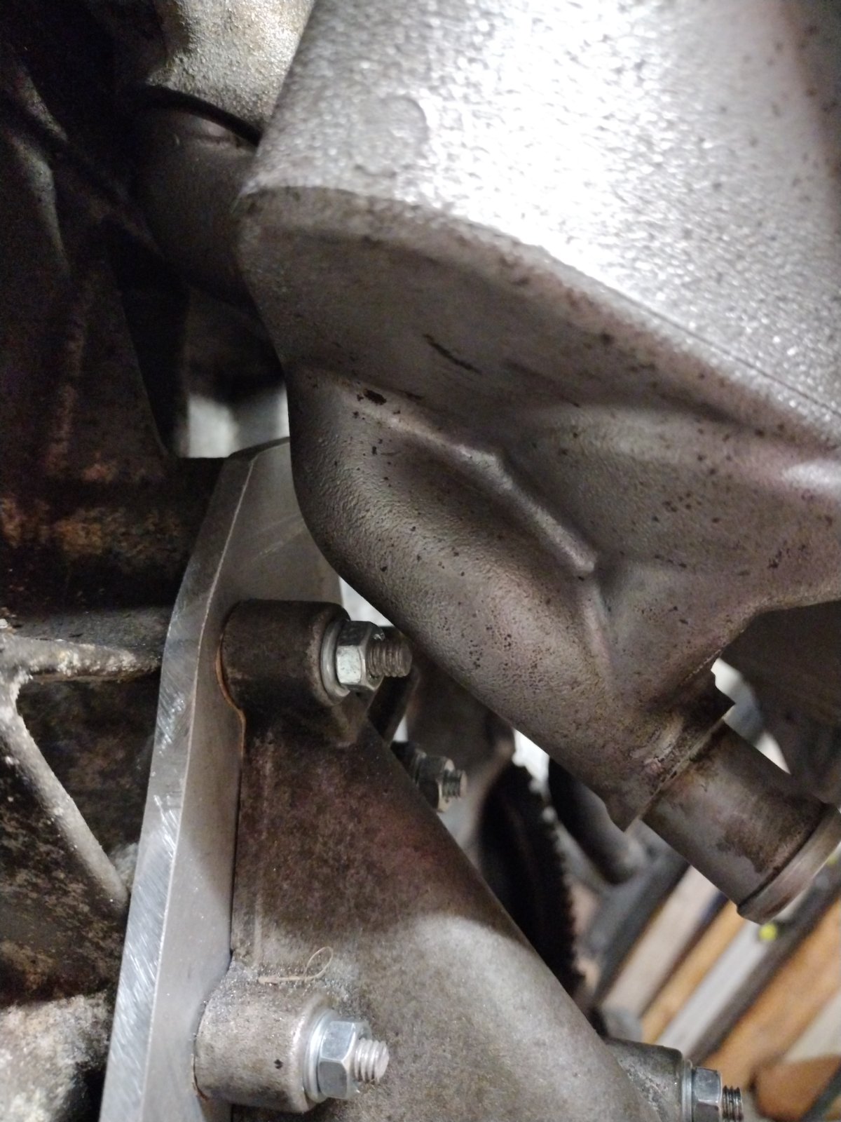

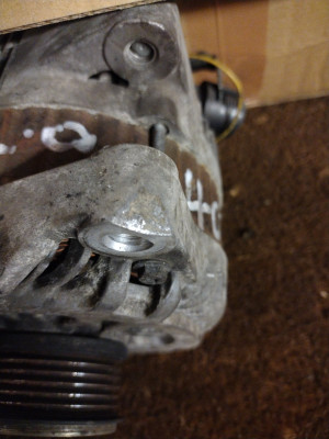

Vs
I'm wondering if parcel has been dropped on a hard floor...
Seemed pretty well wrapped but equally is a heavy lump.
