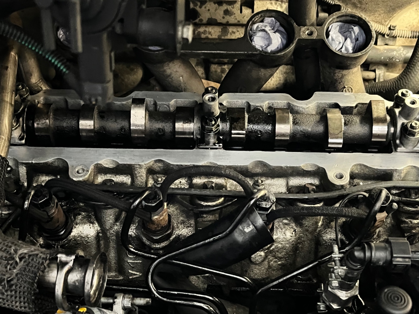

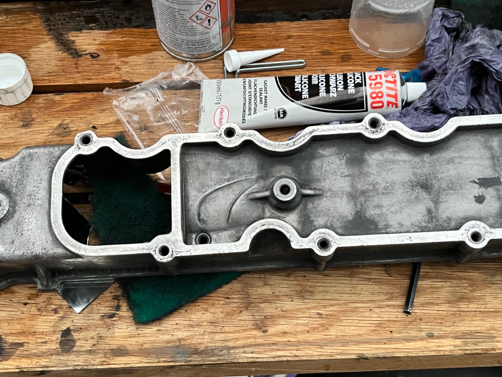

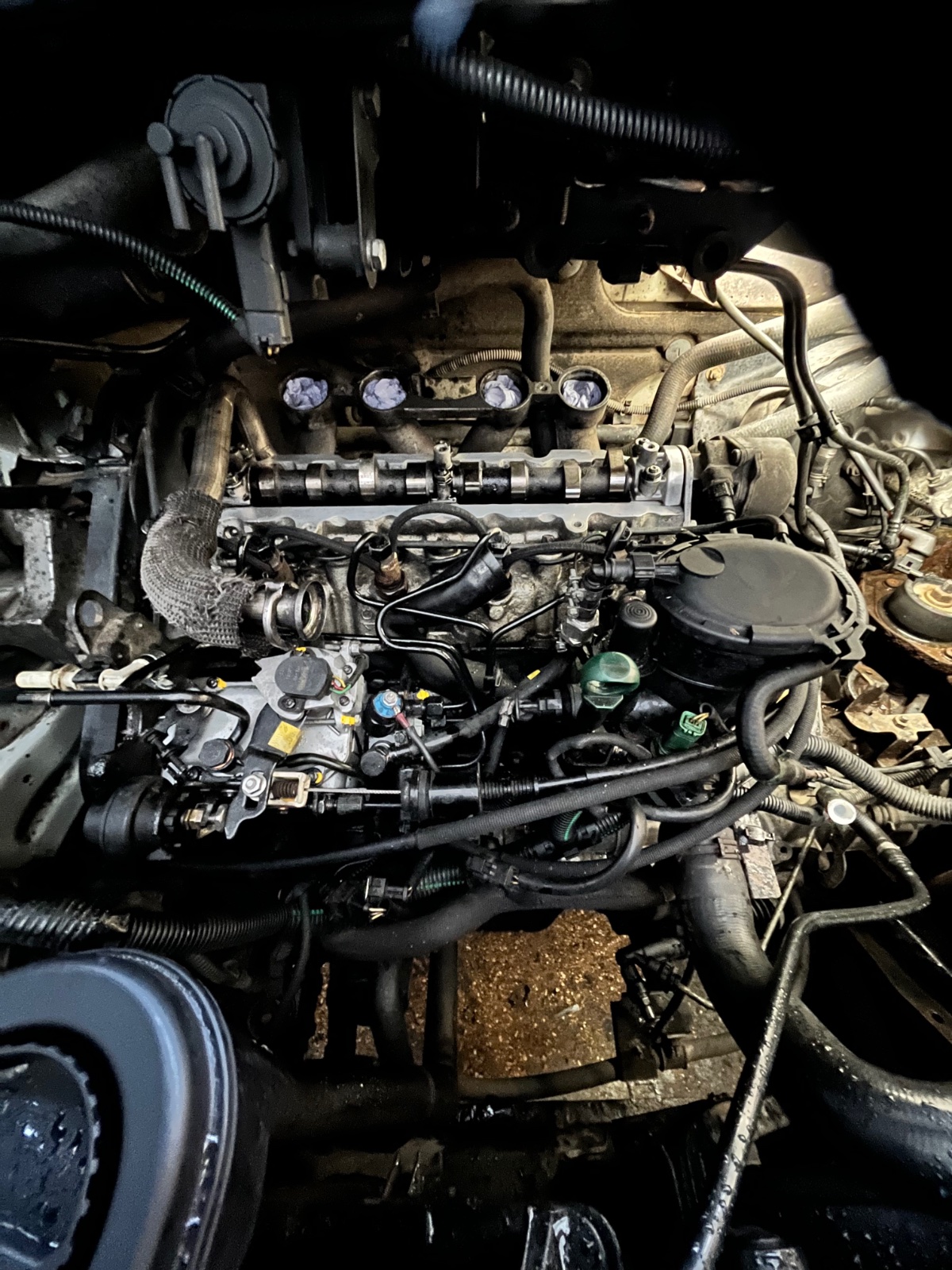

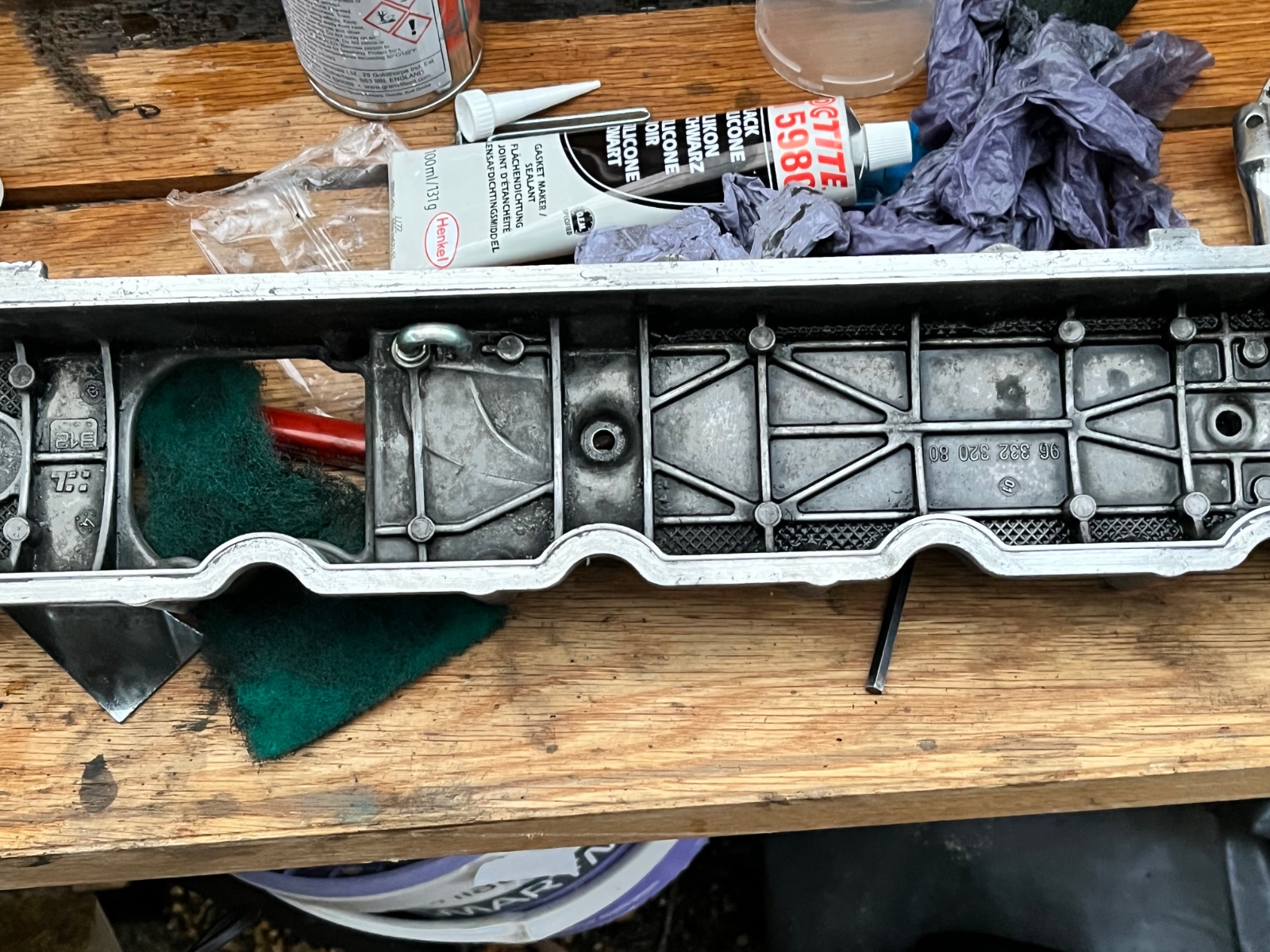

Well still no progress my end.. thinking it defo electric fault.. still waiting for diag session.. called him today and he’s gonna call me back🙄
So the weekend I done this instead:

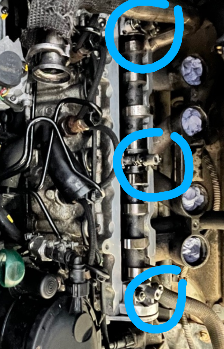

Don't do these 3 bolts up too tight. I found out the hard way (and also found out my torque wrench seriously under-reads at very low values!) That it's possible for these upstands to shear clean off (of the camshaft bearing cap) if overtightened.....

All done up very gingerly at first till gasket paste started to set then nipped up..
So far so good no oil loss.. 🤞🏻
