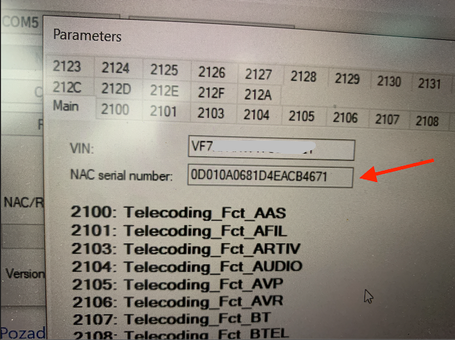

@DanielvV: You can buy 1 month for 10€ to try it out. At least it's available on Slovenian, Italian, Belgian and some other Sores (didn't check the UK one)...
If you fitted the NAC in your car, then it's already coded to your VIN (no beeping?). But Connected services use internal NAC's serial number that you can't read, unless with Diagbox or Arduino. That number doesn't change even if you change the VIN for retroffiting the NAC to another car (as yours is changed, I presume). Since it is rather invisible to a common user (and unchangable), TomTom serves and services use (original) VIN linked to a speciffic UIN (Unique Identiffication Number) of a NAC. That's why you use donor car's VIN on Store Services site (although in BSI it's now changed to your car's VIN) to acces original Connected services and to renew the contract by paying for them (albeit with your Citroen account and not the original owner's one).
As long as you enter original (donor car's) VIN - it's going to be linked to that NAC and you're good to go with Services. Never mind you've changed the VIN for that NAC in your car and you're paying for it via yours (not original) Citroen account! The UIN stays the same and that's what matters on Tomtom servers...
Hope I managed to explain it? It's a bit complicated and I'm not a native English speaker, but maybe you got the idea how it works...

But BTA 2.0 will work (provide you Internet connection for Connected Services) even if you make no changes in BTA 2.0 settings. Btw, you’ll need paid access to Service Box if you want to change BTA 2.0 settings…
If your head unit has 1 year of subscription it should work without any “crashes”. If no BTA 2.0 added, simple sharing the Internet connection from your phone should be enough…
