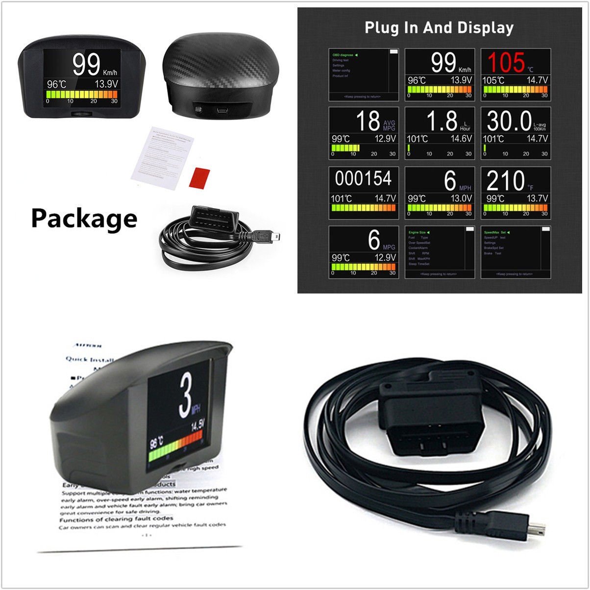

Something like this may or may not be useful, hard to be sure:
This example is on eBay and there are many variations
