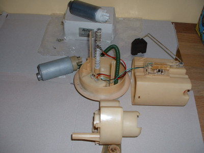

Had a try at running the pump in the tank through the ignition by disconnecting the feed pipe from the fuel filter under the car but only a little spurt came out and after that each time I turned on the ignition there was no more spurts at all so I'm guessing there's some sort of cut out on the circuit :?:
Decided to buy a new pump [Citroen 152577 £258.24 :shock: ] found one advertised on ebay for £57 decided to remove the old one on the day the new one was arriving ...
Banged the locking ring of the fuel tank to remove the pump again, removed the old pump and waited anxiously for TNT delivery ...
...ran to the TNT guy like an old lover reuniting :lol: only for the package to be much smaller than expected :roll: Turns out I'd only ordered the electric motor [VDO PUMP 993 784 022] of the pump for £57 :oops: Trying to arrange a return/replacement pump complete....
Had a play with the old pump (no flow rating marked) whilst I've got it out ran it in a bucket of water to see flow rate as Admiral51 suggested into a bucket - emptied 4 Litres out of the bucket in 1m40s....so over 120 Ltr/hr would seem sufficient (even though there is some internal leakage on the upper join of the pipe).
FUEL PUMP PARTIALLY STRIPPED
The pump strips down OK apart from the green plastic corrugated pipe that appears a push fit but even after warming with a hair dryer seems reluctant to come off, so even if I did use the new motor the pipework would probably need replacing as well but having confirmed the flow rate looks ok on the old pump I'm inclined just to put it all back together (try to slow the internal leak with plastic tie wrap) and move to the next stage of elimination ......
Gary
admiral51
(Donor 2026)
Posts: 2681
Joined: 24 May 2007, 10:11
x 394
Re: My first Activa
Unread post by admiral51 »
Sorry things have not quite as expected Skull.
If as you have found the pump is running with a very healthy flow rate when driven directly out of the wiring loom could it be the connector to the pump that is dodgy, the part that is in the loom?
Strange question given i know the limited space and lack of wire length but could you run the pump within the loom in a bucket of water with a recptical bucket having the return feed pipe in, not sure if that makes any sense at all but just thinking of a way to determine if the loom is at fault.
I am guessing that when a certain pressure is recorded in the fuel line/pump sensor it cuts the pump out but again clutching at straws.
Is there a sensor that monitors pressure and could it be faulty, not totally knackered but unable to read as it should and cutting fuel flow/lift pump ?
Sorry just rambling my brain needs a reboot lol
