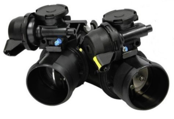

The post on the peugeot forum is talking about the double-doser unit that you car might have that can bypass the intercooler when regerating.
So basically one flap closes and the other opens to bypass the intercooler. Each flap has it's own vacuum solenoid valve. If one of these fails shut then when the ECU closes the other one both will in fact be closed, choking the engine.

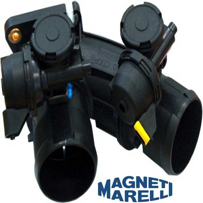

Your part is 0345F0 Pete - here's one at £55 for a Magneti Marelli one in case it's faulty:
https://www.ebay.co.uk/itm/Air-Doser-Fo ... 1397953456

Right, fitted new extensions on the valve end, so they should be sealed. From your photo, Marc, I see the butterflies are visible, going to expose them then suck from the valve end. I can hear them moving when I did it earlier, but I don't know how much. I also don't know if I've got enough suck to operate them fully. Although the pipes should come off the throttle bodies, they really don't want to and I don't want to force ( and break) anything. The next thing to check would be the electrovalve, any ideas on that?
Thanks for the link Marc

Just exposed the butterflies, the pipe on the rhs operates the top one, and the lhs pipe operates the oily beast. I haven't got enough suck to fully operate them, but they both move the same amount, they also seem to move freely against the spring. So it just leaves the electrovalve to check, or it is in fact the poor fitting.
Would these butterflies bypass the IC if you were in perfect regen conditions? I.E long motorway stint.
It would appear each butterfly has it's own electrovalve. One is mounted on top on the other but the other way round.
Thanks for headlamp nos. Marc.

Yes, each butterfly has it's own electrovalve as far as I am aware. If your flaps are malfunctioning there may be an issue with:
Vacuum supply to both electrovalves from the main vacuum system (pipe split)
Vacuum tube between each electrovalve and it's respective butterfly valve.
The electrovalves themselves.
The butterfly assembly and return springs.
As far as I know, one should spring shut and the other should spring open... is this the case? You may have to remove the whole item for a proper look.

moizeau wrote: 02 Sep 2018, 15:14 Would these butterflies bypass the IC if you were in perfect regen conditions? I.E long motorway stint.
The butterfy that bypasses the IC (called inlet air heater throttle) is used for regeneration purposes, yes. It's dynamically controlled to temper the intake air temperature.
The other butterfly is the EGR throttle.
