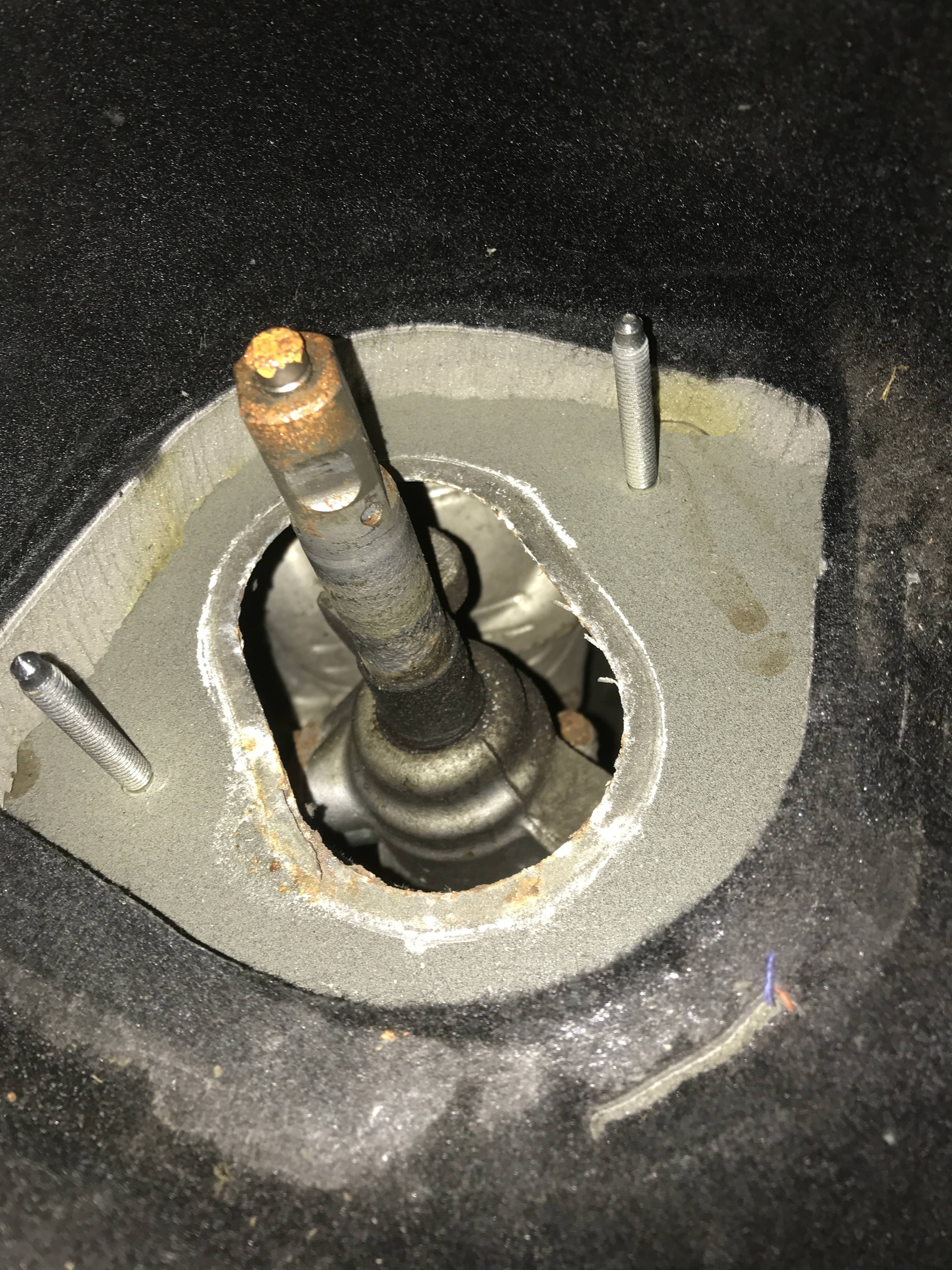

Thanks for the suggestions both. You are right Paul, I remember looking up under the car when it was on the ramp and only seeing that 2" or so exposed glowing a nice rust-red colour back at me. I forgot that Stu has done a similar mod on his that extends through the floor hole into the cabin. Elis found the link and posted it - that's the problem with the steering rack - a lot of topics crossing over - all with lots of good suggestions.

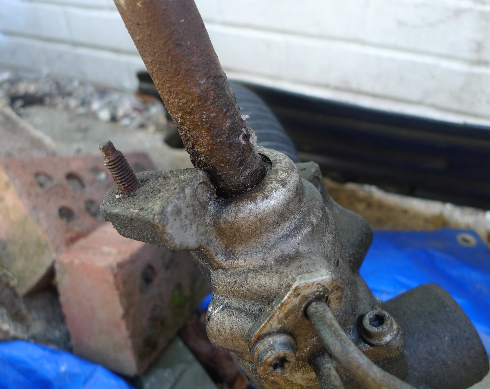

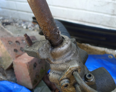

The trouble with fitting any form of boot over the shaft is that there's a casting in the way on the rack body
In best Blue Peter traditions - here's one I rusted earlier.... The casting doesn't actually do anything on these racks - I think it's for the speed sensor or something equally obtuse, but I've not come across anyone with one fitted yet. You could probably grind it off and out of the way, but then when it comes to getting it reconditioned again the reconditioners would probably refuse to take it as it's been modified.
- Posts: 9367
- x 1938
Re: C5 X7 Steering Rack - Again!
Ah, I see the problem.
I'm going to have to think about this for a while
