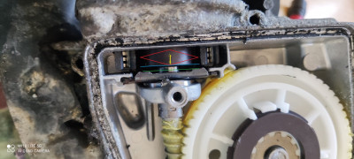

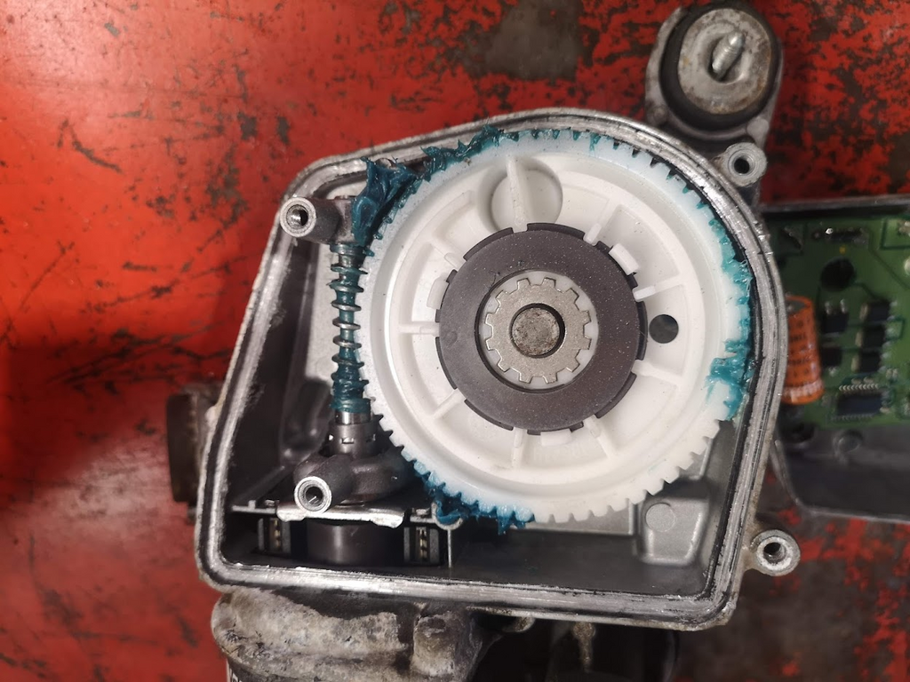

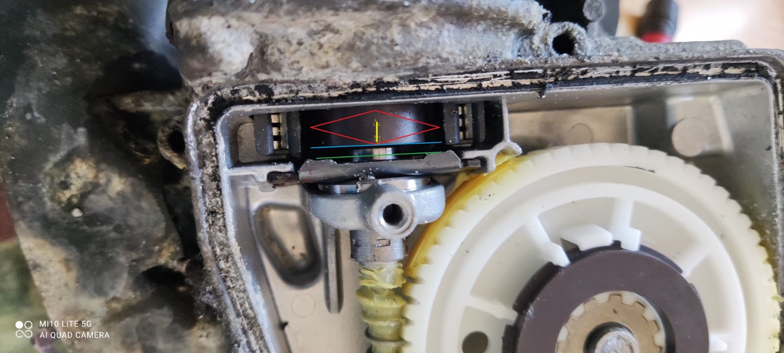

Hi find issue to fix wiper motor .when open bottom cover ,with pcb and gear ,on motor spindle find magnet which moving axial when wiper not work . find this magnet must fix and not moving . I apply a drop super glue to fix this part to motor spindle on position where blue line go in green line in picture . ,when faulty magnet part moving axially show in by yellow arrow . After this intervention wiper work fine again , don't forget to seal cover .
Moderator note: Click photo ? to enlarge, to see marked detail

Dear fried ASK_dy
Your post is highly appreciated. The cause you identified with the lose magnetic bush is awesome. My wipers were not moving at all before my intervention. I found the same issue as you clearly described, I applied then super glue and now the wipers are working fine. I saved about 160 EUR repairing the wipers by my self. Just be careful to do not damage the magnetic envelopment, as I scratch it during the repositioning [but still working].
My best regards to ASK_dj. Awesome picture and great problem solver.

Sorry to dig up old thread, but is the issue here the gap or the magnet sliding up and down?
The magnet on mine seems stuck with the gap as in the pic.
I cracked open my passenger side and there is a lot of corrosion near the circuit board on the inside.

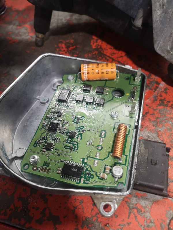

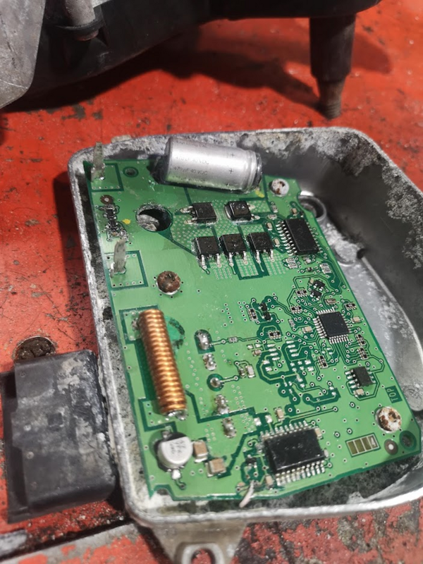

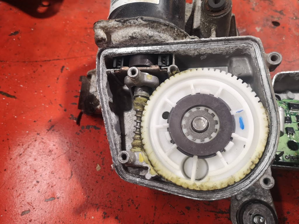

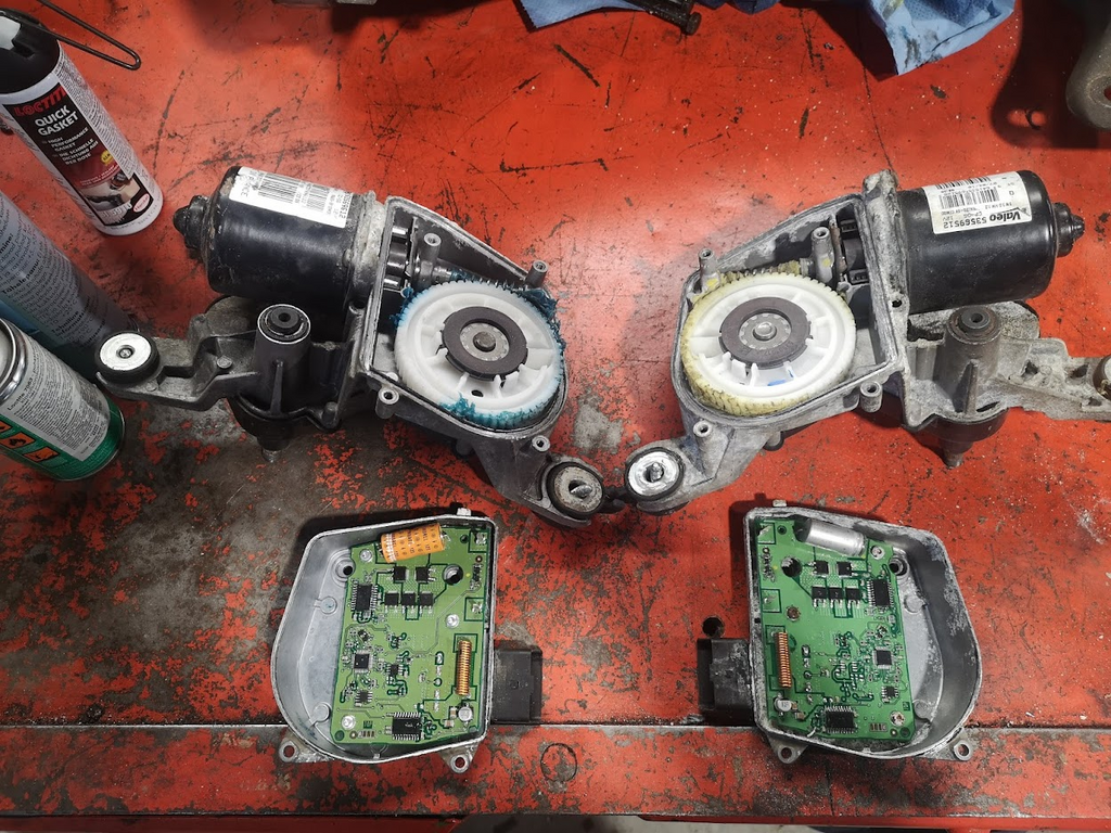

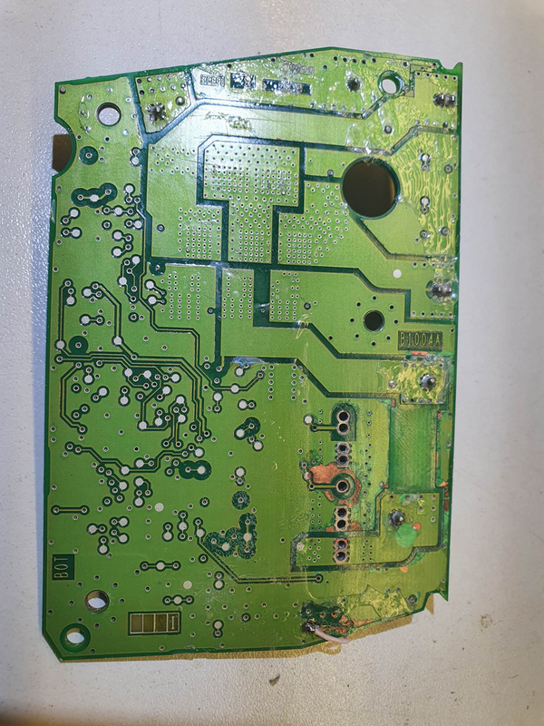

I had intermittent problems with the wipers. Seemed to get worse in colder and humid weather. Problems like described before - one wiper moving erratically, one standing still or no wiping whatsoever. Since new motors were 300€ each and it was difficult to tell which one was faulty (used ones were around 100€) I decided to give it a go and take a look inside. Upon disassembly it appeared that one motor had been replaced previously as it seemed newer and had an newer tag on it. It also had a lot less corrosion than the older one on the aluminium casing. The corrosion seems to be the main problem as it eats away the sealing face of the casing and lets water and moisture in.
Taking it apart was rather easy, four screws and a little prying because of the old glue. Upon opening moisture damage could be already seen. I sent the casings with the PCB's to a electrician who then disassembled the PCB's from the casings and gave them a proper clean and resoldered places that needed to be. Also added a new varnish coat.
I cleaned the sealing faces as much as I could as the faces were really rotten on one of the motors. I used polyurethane windshield sealant to close the motors. I also re-tightened the motor supply connectors which connect to the PCB as the older ones seemed to be a bit loose. After the sealant had dried I added generous amounts of underbody wax to the outside of the motor casings to prevent further rotting and keeping moisture away. Since then it seems to be working fine! Total amount spent was 65€ and some hours of fiddling.
