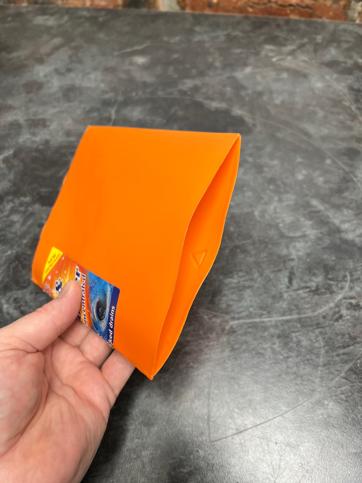

There should be no need to do any damage if you are careful, use plastic or wooden tools to open up a gap then use a wooden or rubber door wedge to hold the gap open. Only create just enough of a gap that you need. I use a plastic washing up type bottle with the top & bottom cut off to insert first so the metal rods dont scratch the paintwork. The door will go back to its original shape no problem.pierrepoppi wrote: 09 Jan 2022, 01:06 I don't want to damage the door frame but it looks like I might have to use a wedge to pry open the frame to get the rod in.
Something like this…
