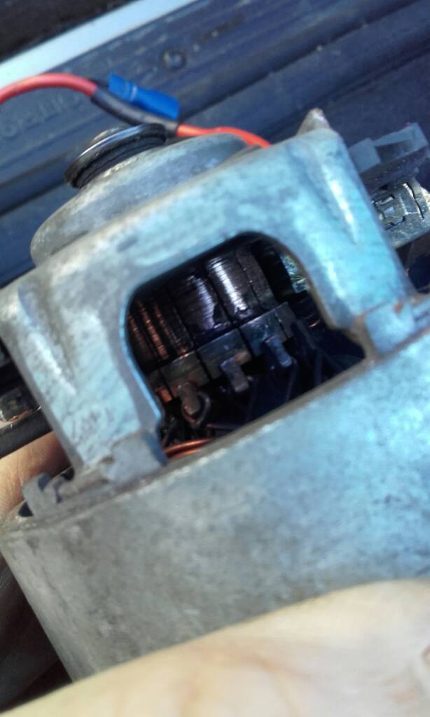

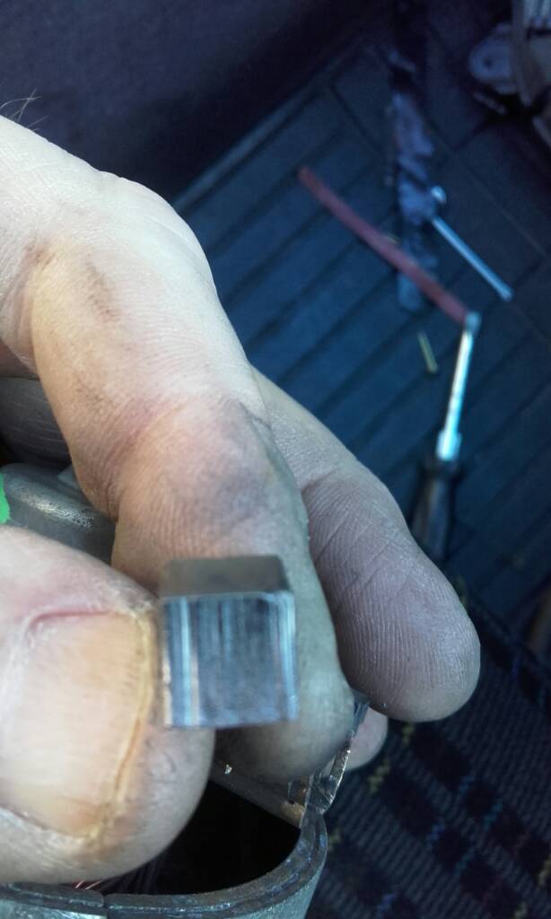

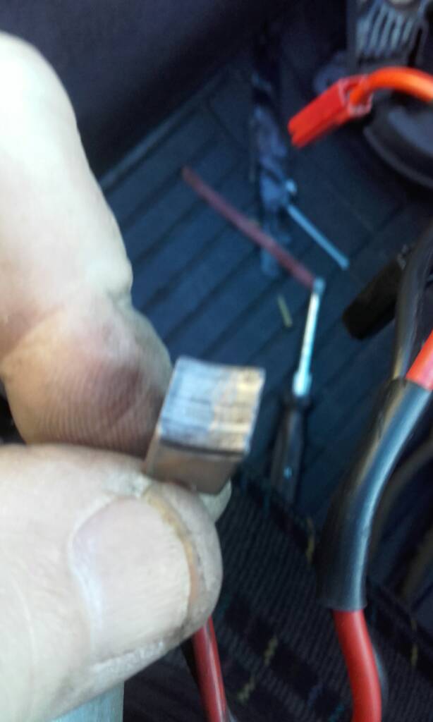

I think I have got to the bottom of this. First of all there are signs of the fan having been catching on something. My mate put it in because my hands weren't working that day. Second the brass / copper centre core pictures was absolutely filthy and pitted. Third the contacts were very unevenly worn. I managed to smooth the core and the contacts with emery paper, and when I put it back together but not in its place and started the engine the speed the fan went was unbelievable! It started when asked about 10 times and ran for 15 minutes. I've now put it back in the car and sitting very toasted doing a citrobotics session. I've stopped and started the engine a few times and it is going when asked. Fingers crossed this time.

Excellent Davie :D It must have been stalled then - hence the commutator damage. You were bloody lucky it didn't overheat and set fire to the car...
The commutator was shiny and bright when it left me. There is no way I'd have sent it if I had the least suspicion of it... I also blew it out clean with an air-line before despatch...
Hope it has not suffered too much...
Fingers crossed it'll keep working now [-o<
Just goes to show it's hard to trust anyone to do a decent job... As I said in another thread, if you want a good job doing you have to do it yourself...

Wow, lucky escape for the car & motor lol... Looking at that commutator brings to mind a question I've often pondered but never really sought an answer to. When a commutator wears, due to it's shape both the surface area and relative "timing" of the segments will gradually change. How does this affect the efficiency/power of the motor? in particular it's ability to self-start...
Just wondering if there's a certain point at which the motor would become weak or intermittent due to timing issues, and how deeply worn a commutator would have to be in order to get that way...
