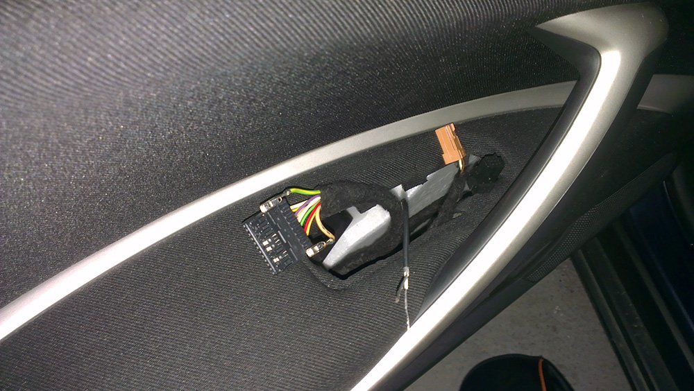

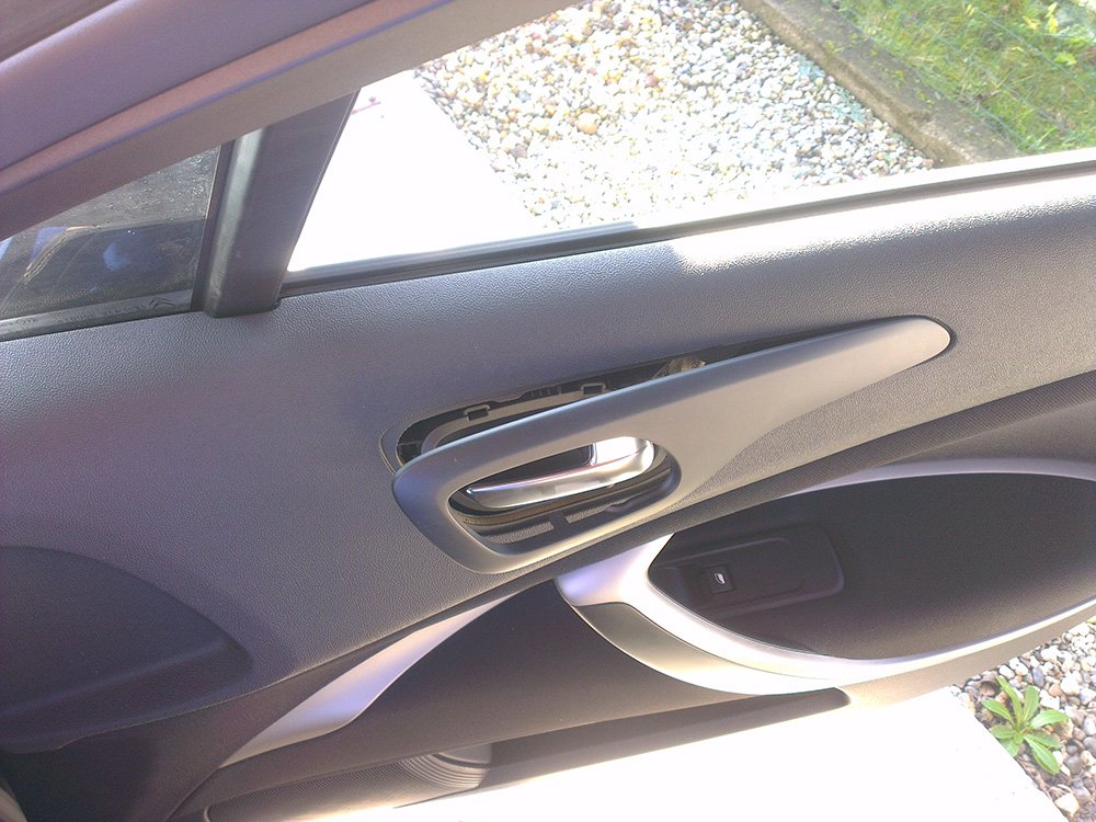

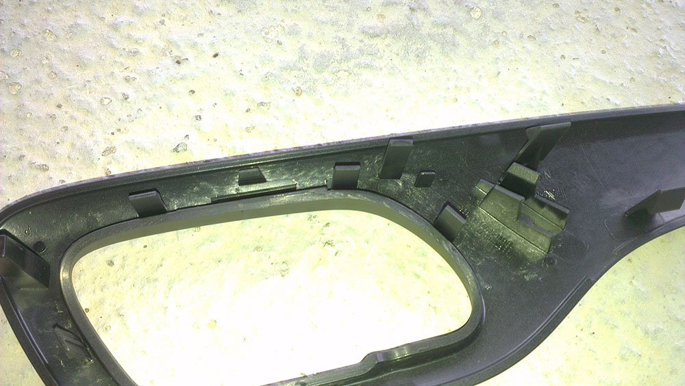

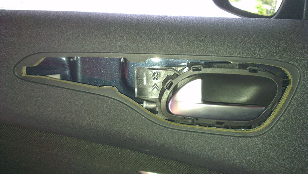

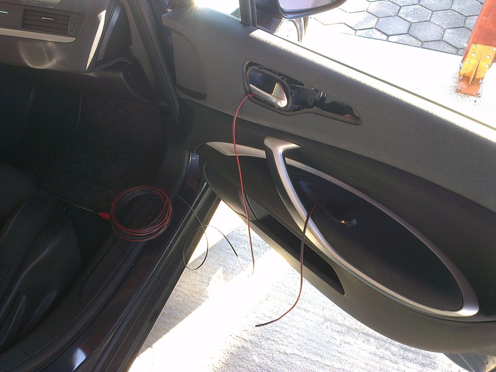

I took out the interior door handle cover, to see what cable infrastructure I currently have (without taking apart the entire door cover), and not too surprising, the ambient door cable isn't there, meaning I'll have to pull wires through sometimes in the future, from the BSI or somewhere, to both door's handles ... when the cover will be taken off (I'm guessing during replacement of the door speakers with better ones) ... I'm not interested in the door pocket automatic lighting, because it would probably be too much of a hassle, and the result color is not orange, but blue, so that won't do it for me ...

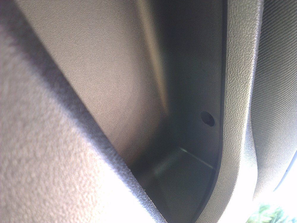

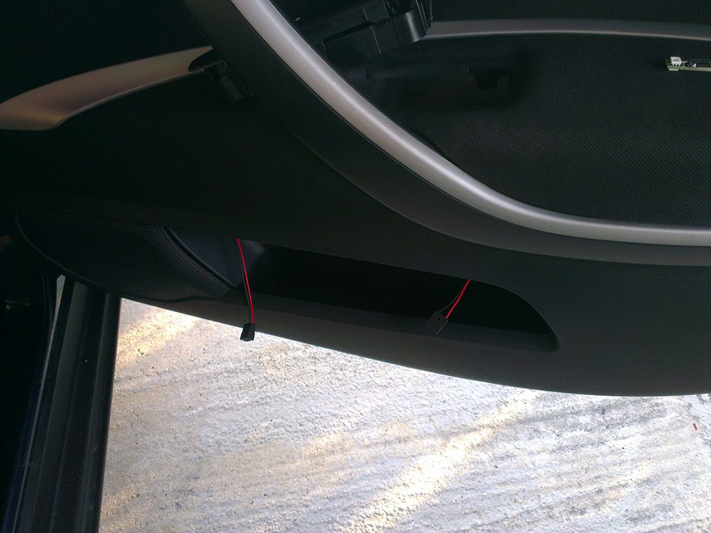

Small update, I've figured something else regarding the door compartment auto lighting (those two automatic LEDs xantippa is talking about) ... all the cars have the preparation in the door plates (holes and the plastic compartments where the LEDs are fitted in) ... never occured to me ti check before the situation, today I'm trying to pull through the wire for the door handle orange lifgt, and the window buttons console had to be dug out, and while looking with the torch light, found out the 2 holes in the door, which are for the compartment lighting ... now, I'm not interested int he automatic lights, but this immediately gave me the idea to grab 2 orange LED's, which would light all the time ... will try to reach a useable solution, without taking the door cover off (that's the last effort, unless I'll be replacing the door speakers, I hope I won't have to do that)

Not sure about the default setup, but I've wired the door handle LED in paralell with the wire that becomes live after turning the key (when the door window buttons light up), the green 20pin connector has one negative (pin 8), one always on positive (pin 1), and I've discovered the pin 15 as the one becoming live after the key (otherwise, the LED would always light up, which I don't want) ... it was tricky to pull the wire from the door handle opening through to the door buttons opening, but I've made it, a bit of soldering and the end result is very satisfying ... will definitely do the co-driver's door as well, later on maybe even the rear doors ... in my case, the part with the LED light is 9119 EV (mistral grey, no seat memory buttons), price roughly 30 GBP ...
Pins/wires 1 & 8
Pins/wires 1 & 8

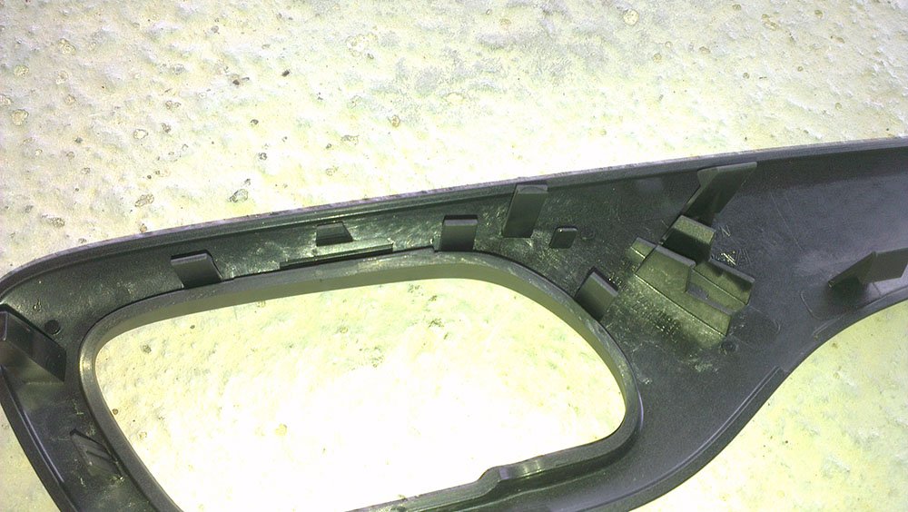

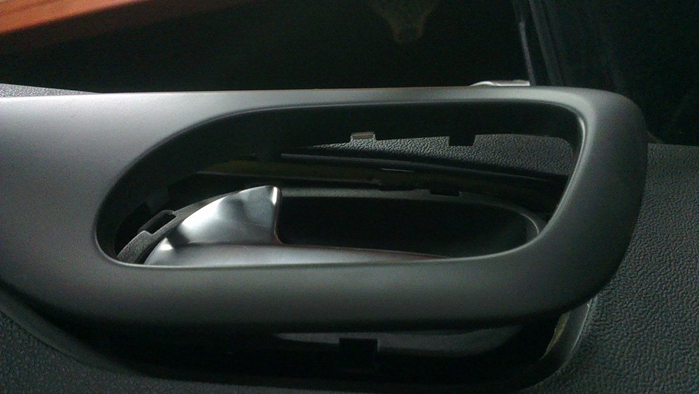

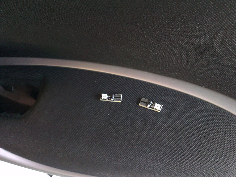

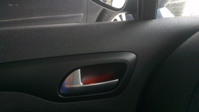

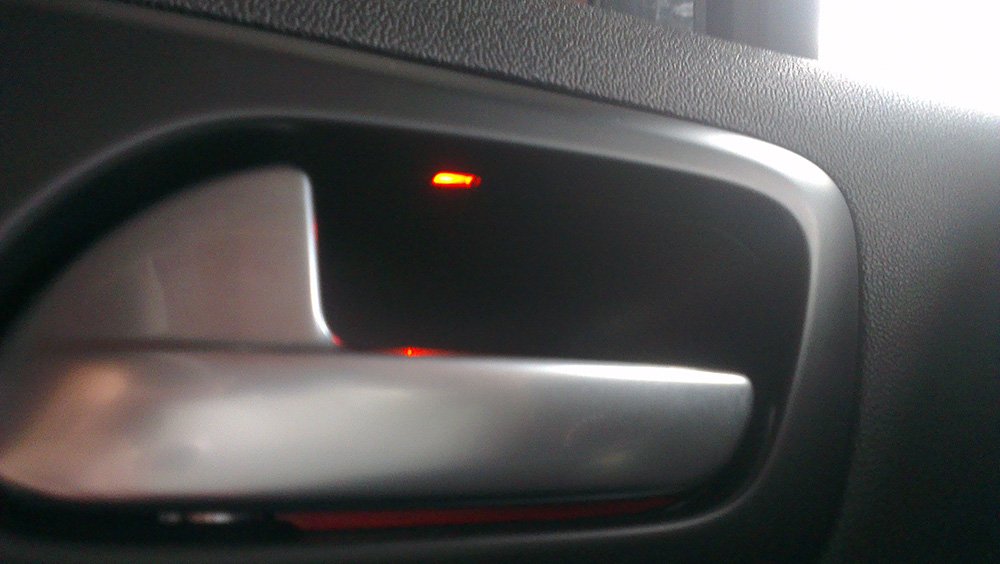

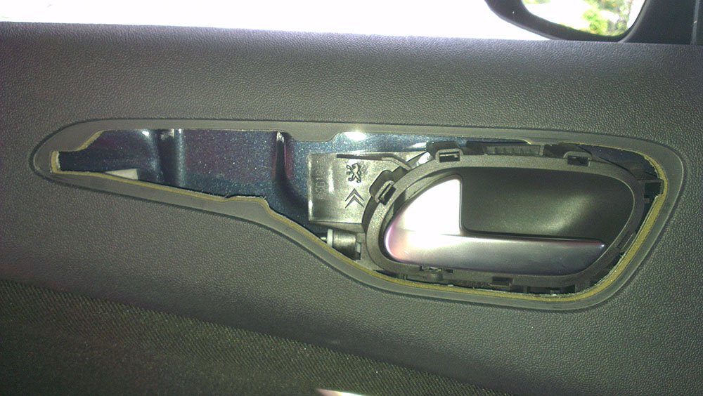

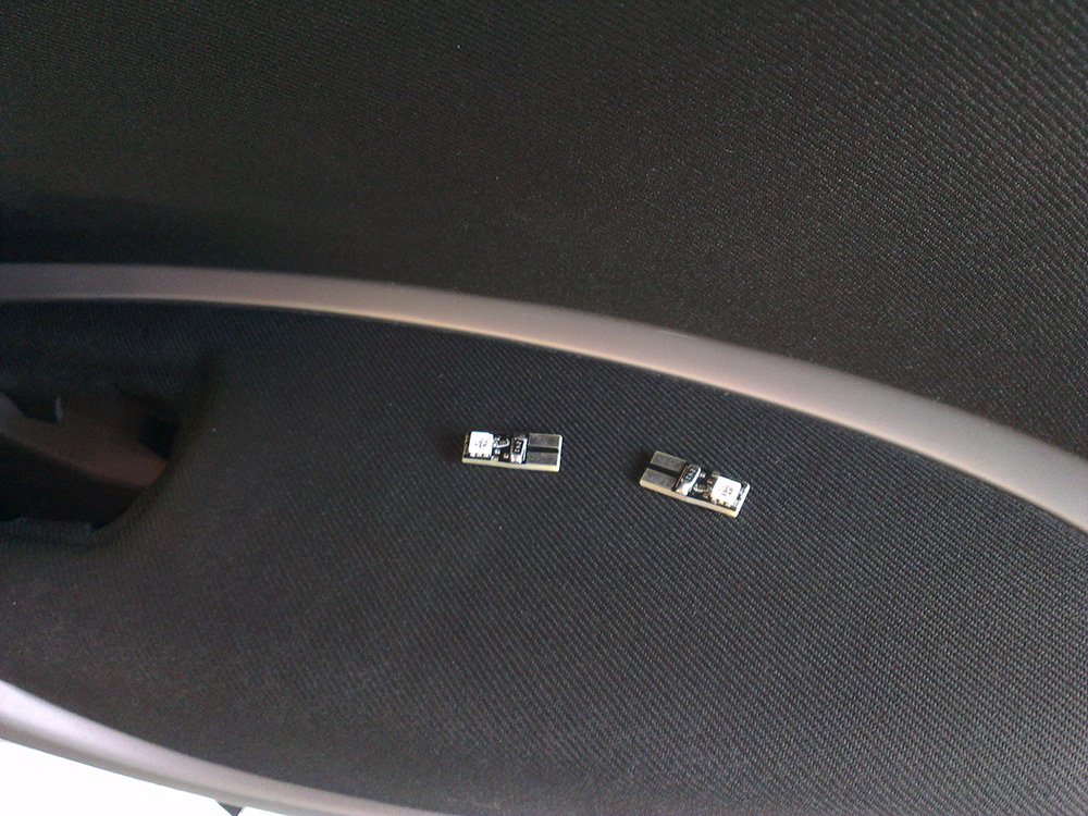

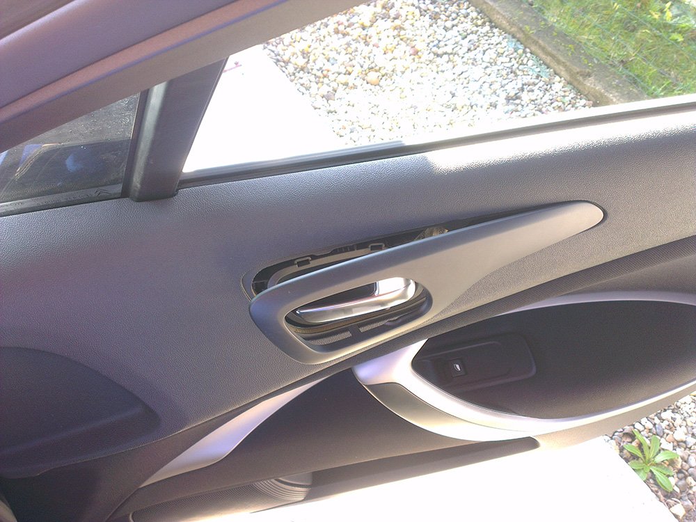

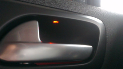

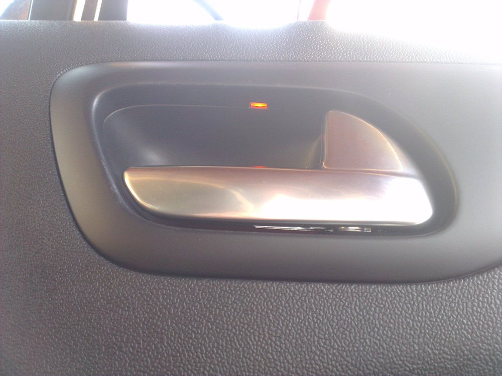

Finally completed the full lighting project on one door (front passenger) as initially planned, with the outcome even better than expected (better than original IMO) ... so, the door handle cover + led light is genuine Citroen (part no. 9119EK), was ordered from the dealer, the door pocket lights are slim W5W orange LED's, mounted on a W5W type socket, everything wired to ground + live wire on ignition that power the orange light on the door window switch panel ...
[removing the old handle cover]
[one of the target holes]
[adding the required wires]
[orange W5W LED SMDs]
[W5W sockets]
[new door handle cover with LED light]
[night view - the picture doesn't do it justice, it looks much better in real life]
[W5W sockets]

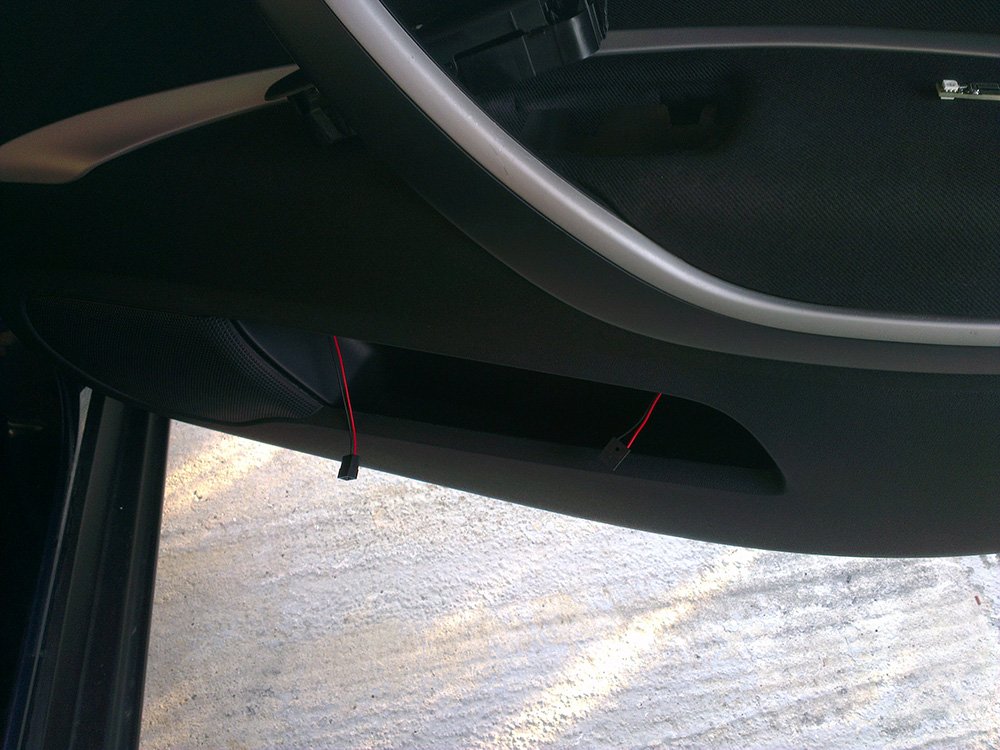

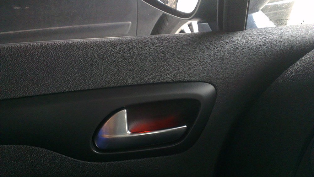

The next step I did was adding the wire installations for both the door handle lights (near future) and the door pocket lights to the both rear doors on my car ... now, I'm not sure about the genuine setup on Exclusives, but the rear doors should at least have the door handle lights, but unknown to me if they have the automatic (or any for that matter) door pocket lights ... I had to drill one hole on each door pocket top side, to allow for the W5W socket's wires to go into the door cover ... the rear doors have far smaller window button panels, so you can't fit your hand inside the door once you get it out (if you have smaller hands that is) like you can on the front doors, so that's one extra level of difficulty ... I'll add the pictures a bit later, since I now have just the installations in place, but no lights, since I have to use order 2 more door handle covers with LEDs & the W5W orange LED SMDs ... an interesting thing happened once I tried installing one regular W5W bulb ... the both rear doors "shut down", kinda like when you enable the rear door child lock (no window, no door opening) ... but with the exception that the driver door button for that lock was blinking, not lit up continuously (like normal) ... that's some kind of an error indication, seems the regular bulbs consume lot more electricity that normal, so the doors have some kind of shut down protection ... when I tried with the LED SMDs, no issues ... now I have to order some, since I had just 2 (shown on the previous pictures), ordered for the testing ... a bit of drilling, a bit of wire stripping, a bit of soldering, and you have yourself a Christmas tree on 4 wheels ...
On another note, one additional thing happened, which I didn't know worked that way ... I tried locking the car during the process, with one door opened, and of course nothing happened ... but, the car alarm (genuine, aftermarket installation) WAS armed and gave me a surprise when I opened another door after a few minutes ... didn't think it would actually arm when the car wasn't fully closed (failed locking) ...
