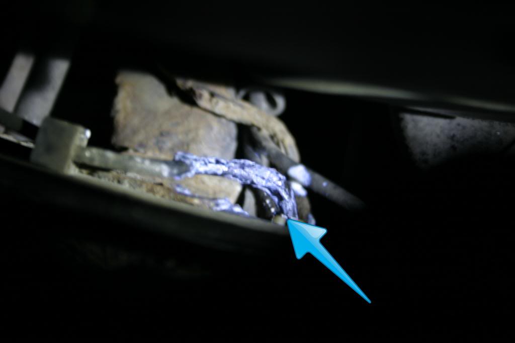

If it's a pressurised pipe (either suspension or steering) then it will leak (a lot - in a big spray) all the time the engine is running. The fact that the suspension is still up suggests that perhaps it's not a suspension pipe. If it's a brake pipe then it will only leak when the brake is pressed. If it's a return pipe then it will only leak (relatively) slowly when the engine is running - unless it's the PAS return in which case it will leak copiously when the engine is running, but it won't spray out.
Note that the return from the brake valve which is above that location can leak a lot of fluid if it breaks.

To my mind, the only way to pinpoint the leak is to see where it's spraying from, so you need to run the engine. An assistant in the driver's seat may help with brake system test.
Unfortunately you'll need LHM in the reservoir, some of which you'll lose during testing, but good excuse for renewing the LHM! Initially, run the engine without touching the steering or brakes. If no leakage, try the brakes. Basically trial & error.
Could be that it's a fracture in the main hydraulic pipework between pump and regulator. If you are rapidly losing LHM, then I'd expect it will pee out when you press the right "button" - good luck.
Pin-point the problem, rather than replacing items willy-nilly. Replacing pipework is a bit of a pain, so locate the problem before deciding on the repair.

This one..towards the back of the engine, just below the electrovalves?c.morewood wrote:If you look down inside the engine bay next to the belts there's a pipe which appears to come through the arch from the wheel area and then run backwards to the firewall.. is it that one? If it is .. its a return pipe ... corroded on mine.. should be relatively easy to cut and replace with a rubber pipe as its under no pressure.

Looks like that one...
