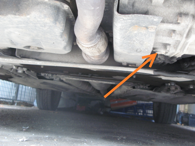

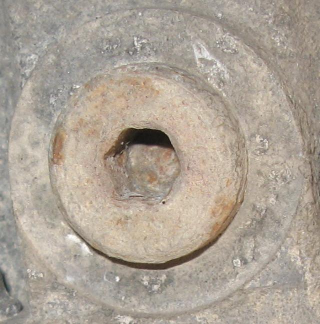

Got some perspective for my previous pic, with my G7, figured one with more stuff in the pic would be better:
Also checked my toolkit.. Looks like I need to get an 8mm hex for it to go on my ratchet...
It does also look like there's some wear around the edges as if it may have been removed before.... or could just be corrosion I guess?
