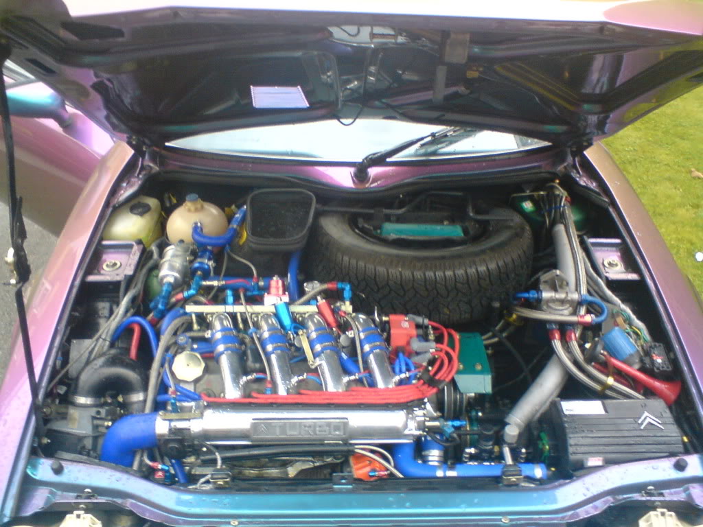

so...
the block is standard

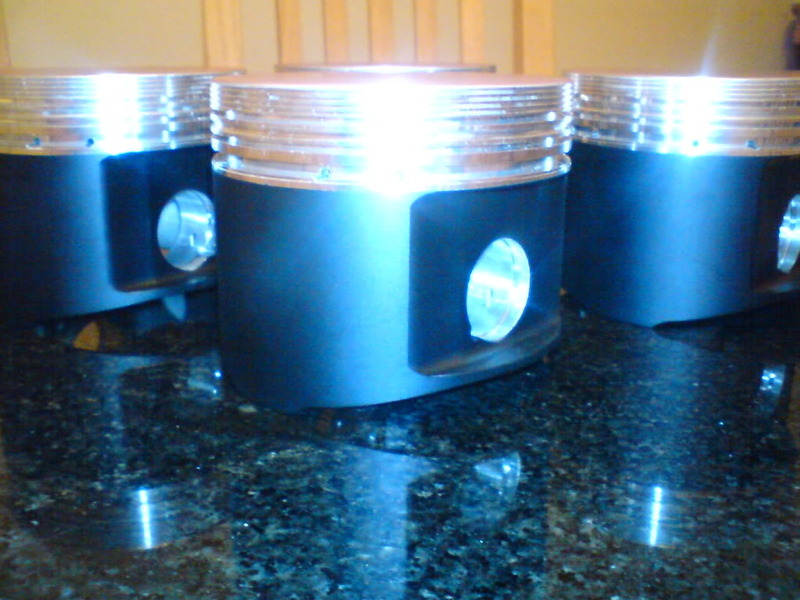

JE forged pistons
total seal rings
usual lightend balanced reciprocating stuff John Noble Derbyshire
18lb lighter flywheel
currently twin air flow meters, with green cone filters
8 injectors
044 pumps
fse bullet fuel filters
aeromotive fuel pressure regulator
GTI throttle body
gas flowed and ported head 'on a flow bench by a reputable tuner
re worked cam
Maikonics conversion
MSD ignition
MSD coil/leads
direct port nitrous
rs500 inter cooler
helix hand built clutch
GTI T1 gearbox with Diesel crown and pinion
plus 5th gear. later bigger bearings used
Hybrid T3 T4 watercooled turbo
6.something:1 cr
2 bar boost
launch control
it goes reasonably well :)
oops
powerflow 3 inch exhaust
screamer pipe
HKS dump valve
anti creep and adjustable audi wastegate mod
thermostatically controlled 19 row oil cooler remote oil filter

Hello Neil,
I spy WON solenoids and crossfires. 8-)
What size jets and is it progressive?

hello,
still waiting for the right price controller to turn up so its not progressive YET! :) to that end it still has the 50 hp jets that was in it while it was on a single nozzle.
I made the jig to get the nozzles in the same place and prated for a bit swapping the nozzles and altering the height of the pillars they sit in to get them all pointing the correct way :)
I bought a spliter block off ebay 'like most of the kit' cut it in half and made the fuel line side the shorter length. 'All lengths from the splitters are equal to each other though'
This year I haven't used the car, other distractions 'sons motorcycle accident. other son being old enough for his first bike, etc etc. The kids get priority :)
all the kits in there ready to hook up to the controller, the msd ignition is programable for retarding the timing, simple relay activated by the tps knocks back the timing as required.
All these mods are declared to the insurers too! even the NOS
