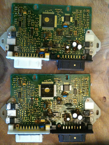

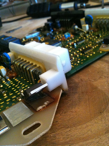

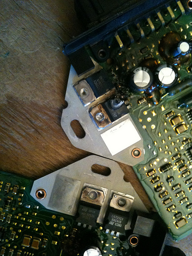

the only thing i've changed on paul's board is the single burned transistor, that is it, less solder, and using a weller iron, I haven't attached the transistor to the backing of the 'wing' as the aluminium backing has come off the fibreglass (it didn't on mine), i think it could be better unattached for now (more airflow?), but if it breaks down again i know why now, i should note that the soldering i did last night took nearly two hours from detaching and reattaching, it really isn't a job for the faint hearted and patience is needed in abundance
i didn't change any buz11's I don't have any yet, not sure i will order some, I now have 2 vn05n's remaining.
when i checked both ecu's they were both checked AFTER I did the diode fix on the electrovavle cables
as for the damage on the BUZ11, here is a picture:
finally, here are the two identical boards:
i may well invest in an oscilloscope if they can be had for that cheap, i would certainly need one for the future
the electrovalves are happily humming, and there is a prominent click when they switch off, so all is good so far, gonna pack the board back up in the case, and plug it back in, and do some bleeding now and height correcting now

From your photos I think the BUZ11 is good on the board that you are now using. The marks on its metal block are just from the original factory soldering. I do not think it matters about soldering the body of the VN05N's back onto the wing other than making sure that the metal block on the device is well clear of the ECU metal case. If you look carefully at the two "wings" for these components you will see that only the BUZ11/L4705 one is a heatsink comprising 1mm thick aluminium nearest the main pcb then a thin insulating layer and finally pcb copper film to solder the devices too.
On the VN05N side the wing is just 1 mm thick PCB fiberglass sheet with 3 thin pcb copper contact film oblong shapes to solder the devices to so cannot provide any real heatsinking effect.
