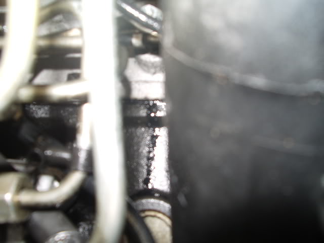

The head on my XUD 405 is coming off because of an unusual head gasket oil leak at the front of the block. (see photo). I've double checked everything and the leak is definately at the head/block mating surface. Very strange???.

Hi Patanga, how are you getting on? There are a couple of replies to your thread over on vegoildiesel.
Finding that hole is a bit of a footer, as I recall it's directly to the right of the oil filler cap. It might be gummed up with grease and difficult to see. To be honest, I've had the starter motor off when I took the gearbox out, and it's very easy. It's held on by 3 easily accessible bolts. You don't have to diconnect everything, I'm sure just shifting it over a bit would suffice.
What did we say about the lower pulley? I left it on in the end, no problems.
I think you first need to remove the tensioner (careful of the spring) and then the mount. I think the bolt heads require an 11mm or 13mm socket, I don't recall which.

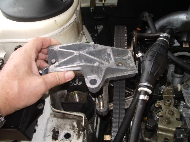

Hi Evilally & thanks for your reply. I've since managed to get the head off ok.. I ended up taking the starter motor out as it was only held in by three 8mm Allen head bolts plus it gave me a much better view. I found the crank timing lock out hole quickly once that was out of the way. The lock out pin size is 8mm by the way. Removing the front crank pulley also made the rest of the removal job so much easier. I agree with you regards working with care removing the the timing belt adjuster spring. Having said that, once the crank pulley and lower front cover are removed it is easy to see how it functions and not such a challenge to remove. Getting it back in might be another issue
With the pully and cover gone I was also able to easily remove the lower bracket of the top engine mount. That was my main concern as I wasn't sure if it was just a dowel of was bolted on in some way. Citrojim has also been very helpful with a few tips so it's all looking good so far. I'll post the end result...
