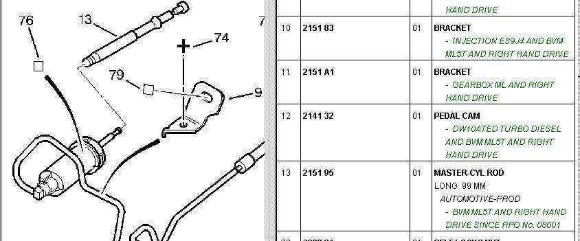

Just had a look in Laser (the Citroen parts catalogue)
For the RHD kit they do indeed list the pushrod separately. part No. 2151 95
Item 13 in the picture below:
This is only listed under the MK2 Xantia but should be OK on the Mk1 as well,. I was not awate of any massive difference between Mk1 and MK2.
At least you can now hit the stealers with a part number i3...

ive measured my pushrod, and its 107mm.... but the one with the part number you have given Jim is 99mm... before i order it, will this be suitable as a replacement for mine? is this the pushrod you replaced yours with Dave? and you wouldnt happen to remember if your original pushrod was 107mm would you?

The 107mm rod is the one specified for the LHD Series 1 cars so I'm not entirely surprised it's not available here.
The 99mm rod has to be worth a try. The pedal has a lot of travel so it should be able to absorb 8mm less travel.
It's strange yopurs measures out at 107mm as the 99mm rod is the one specified for RHD vehicles.

that does seem strange.... i guess ill order the 99mm rod tomorrow then and try it when i get it on monday.... there is a citroen breakers who has a 2.1 td...the same yard that i got the hp hydraulic pipe from...but he said he can only sell me the entire system with master, reservoir and pipes for £100... id rather not do that though.... none of the scrappies round here have a 2.1 a 2.0turbo or the hdi!!

Jims part no. is correct,that is indeed the one i got,12 months ago.i3 wrote: the one with the part number you have given Jim is 99mm... before i order it, will this be suitable as a replacement for mine? is this the pushrod you replaced yours with Dave? and you wouldnt happen to remember if your original pushrod was 107mm would you?
I've just found the receipt for the pushrod. With all the hassle of finding one it appears that we got it from another dealer, mybad
Dealer: Evans Halshaw Citroen, Kings Road, Bradford, tel 0845 226 8607, invoiced by a mr.Dereck Howland.
Part no. 215195 Master-Cyl Ro, £23.46 + vat. Worth a ring?
